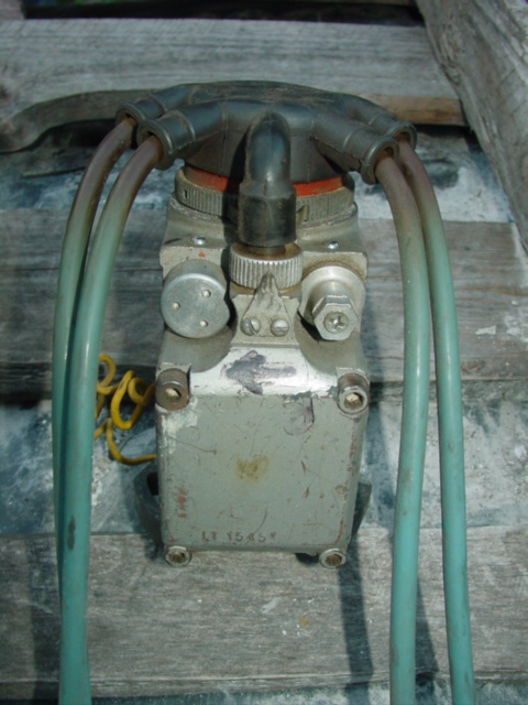

    I think you should get a mag
    This little Lucas one is pretty good..... sorry about the outta-focus
    Small very hot and good enough to do 24 hours of Le Mans

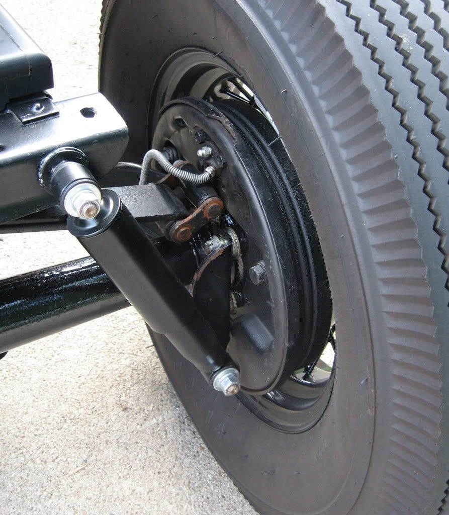

    Here's my contribution to the rear brake pictures, hopefully this will help somebody. I know I looked high and low for pictures or verification that you can do it this way and couldn't find anything.
    If you go to modern shocks, you can cut off the original shock mounts and get to the wheel cylinders in their original configuration - don't need to flip them, rotate them, or drill any new holes. Model A rearend, '47 Ford brakes, brake lines from Cling's.

    I've got a Lucas mag ready to drop into a banger somewhere. Must dig that out and take a pic...

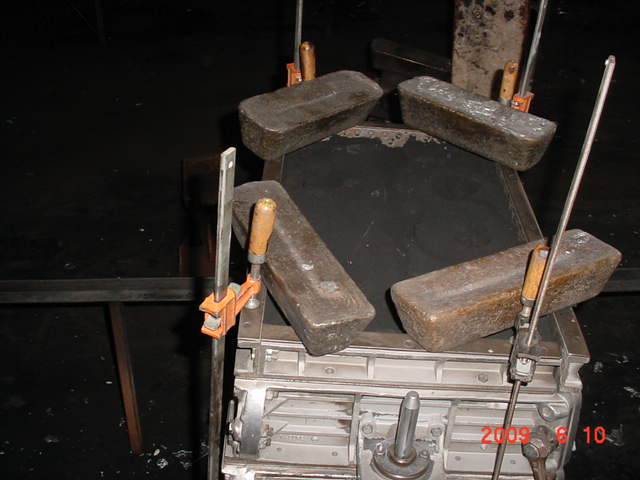

    Ok some time back I said I was gonna make a valve cover for the early olds engine, mine is a 23 4 banger. I took the tin valve cover with all the holes and added wood n bondo to it to make a pattern. made the height a liitle taller n added material on ends n sides for shrink. Put on some fins give er a coat of primer n went thru the process of casting a loose part.
    Pic's show the process from start to finish, except the one of stock cover did not come out. It is not drilled or polished, has a few pinholes from loose sand, but is a sand cast part similiar to the originals from the day.
    anybody want one , pm me as to shipping costs. I want $175 plus the ride if interested. Need a week to do them also. Same place does Mummerts Y block stuff. See attached pics for whole process

    great stuff i have done the same myself it is pretty basic remember this was how the old timers did it they were backyarders some of who went on to better things it always surprises me that more ain,t doing it good effort please do more
  11. Banger Tech Week? Looks good, have always been interested in casting and the whole process.-Weeks
  12. Thanks for the contribution. Was wondering about the drum also. I had to find a replacement for one of my front drums due to the same size piece missing. Obviously you have been driving on it, can you feel any vibrations or wheel hop? Just wondering if my drum might still be usable before I take the hub off and s**** the drum.-Weeks

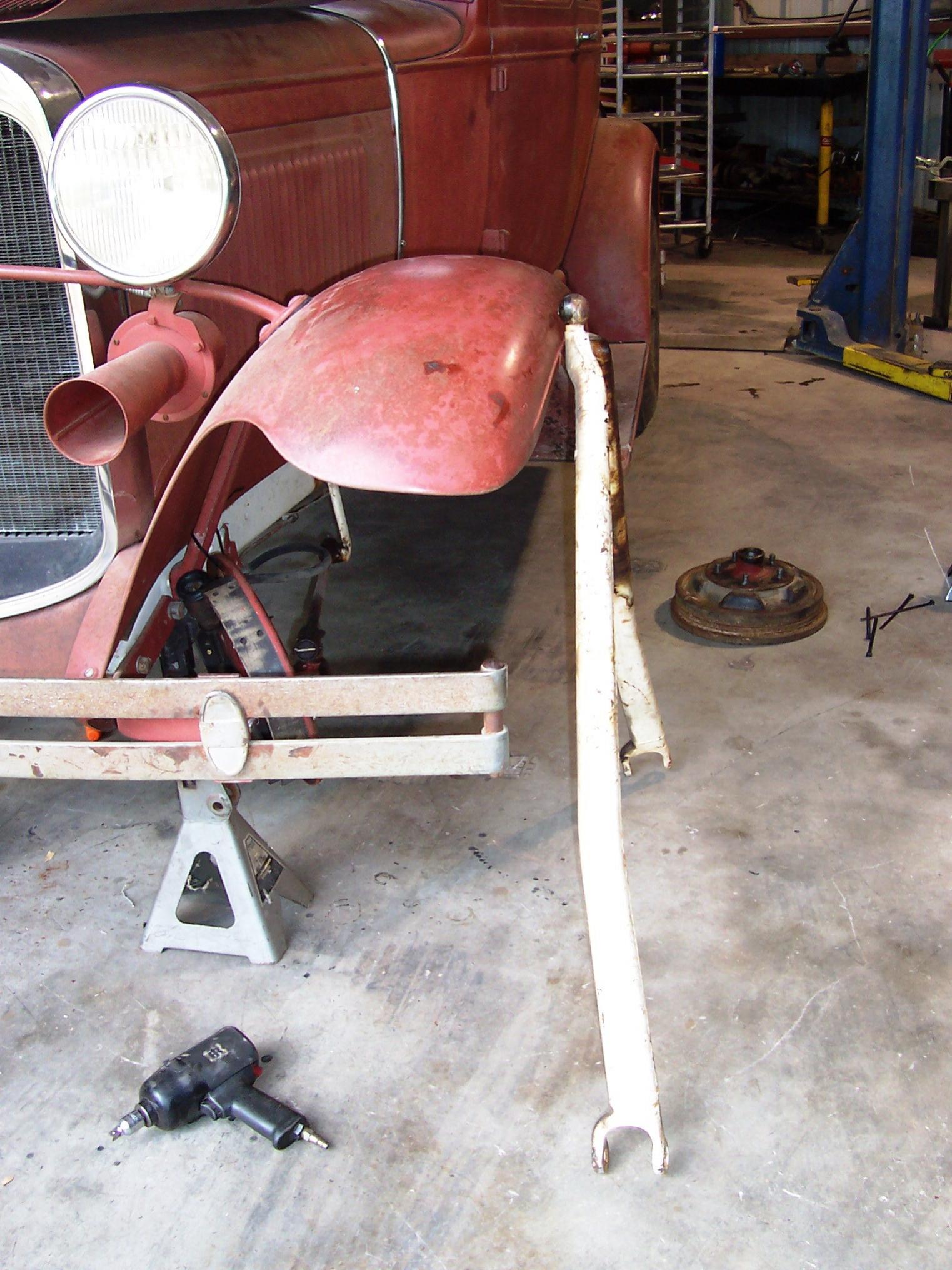

    Hello guys this is my first banger I have been lurkin thru the banger meets the last few months trying to learn as much as I can, I finally opened up a spot in the shop so I got it out there last week . I pulled the front axle today for the drop axle I am cleaning parts (and removing white paint someone had a sale on white paint)
    I am going to keep it full fendered and not planning on splitting the wish bones Which brings me to my first of what will be probably a few dumb questions . are the wish bones bent or is this normal for an A Thanks for all the great info as always Andy

    I think the wishbone should be straight, i maybe wrong but it might have talken alot of weight and bounce on the front end to cause that. Am fair young and new to the gameish but someone will be able to tell u.
  16. Yep they are bent, sorry. Have seen a few that were puposely bent like that but they were split and for dropped axles. You should be able to find a used good wishbone for less then a 100$. I have bought some for 15-25$ needing a new ball welded on.-Weeks

    Wow, that wishbone is bent big time. Should be strait.

    looks like someone picked it up with a forklift does it every time

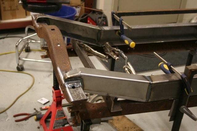

  22. Here is another way I had the ears built up and remachined them [​IMG]
