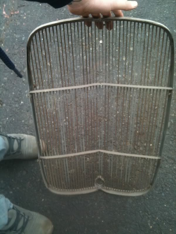

    Went down to visit my friend brad over on the seacoast today ended up working a trade out for this nice original 32 insert!

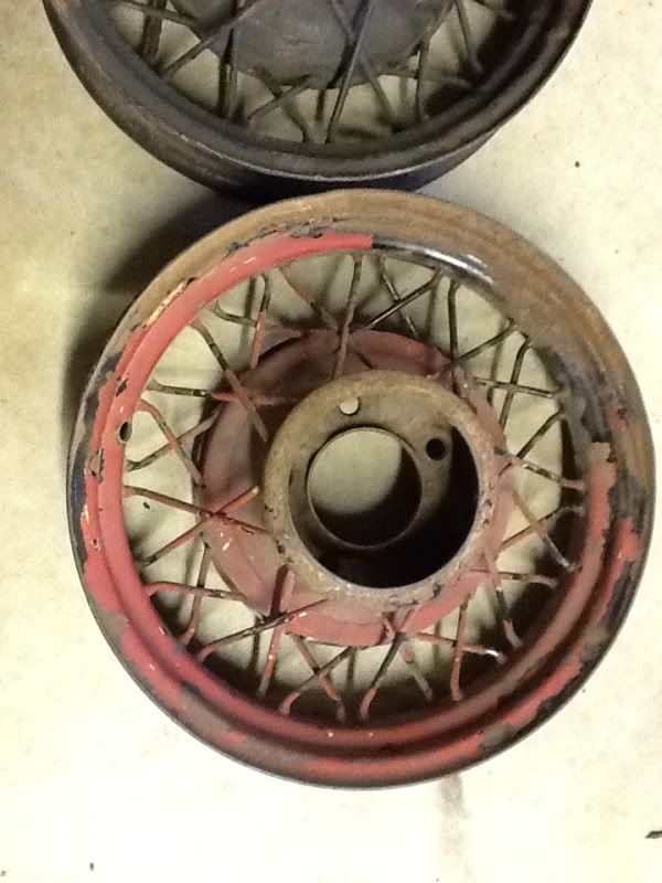

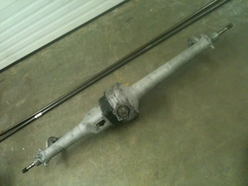

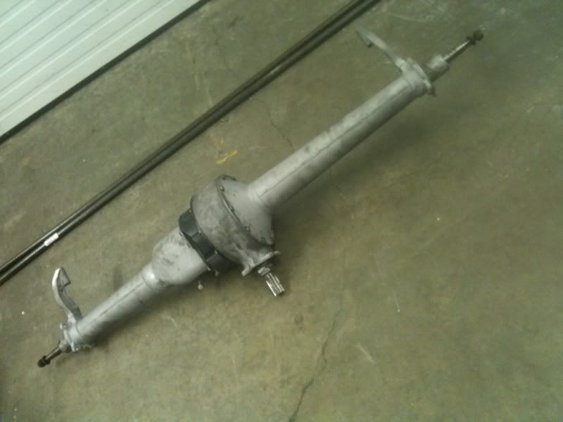

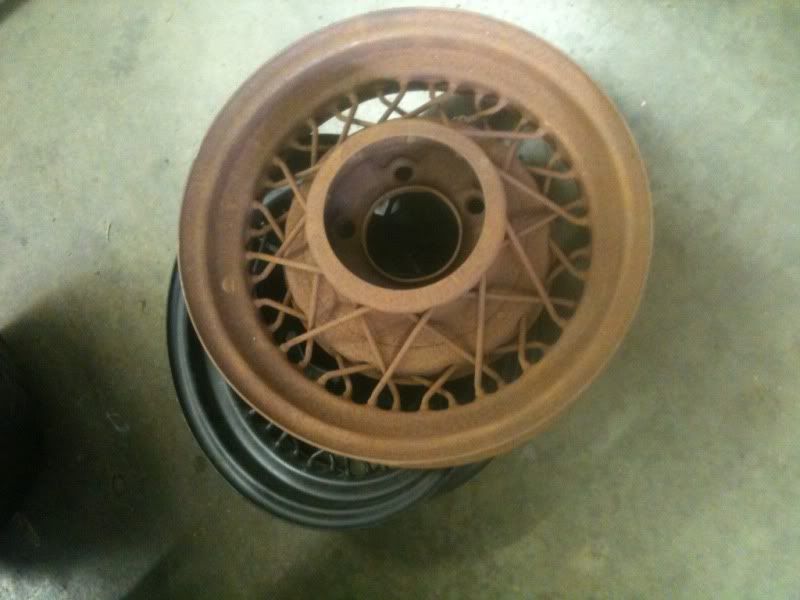

    purchased some more parts for the project today... still waiting on frame rails and patch panels. got some kelsey hayes 16" bent spoke wire wheels for the front and a 37 complete banjo rear end off of dave simard today... i originally planned on going open drive with this car but i have changed my mind to running a torque tube with a stock 32 k member. also purchased some 17" bent spokes off a fellow hamber they should hopefully be in by the end of the week!
    16s
    17s need a good blasting but should clean up nice

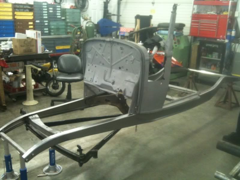

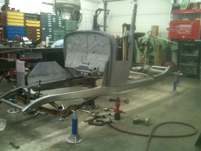

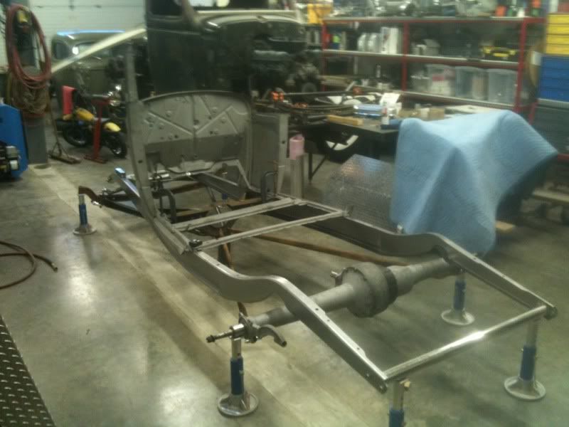

    got the frame rails in last week didnt get a chance til yesterday to mess around with them... i have a customer cor on the frame table so i just did a little mock up. i ended up getting a stock 32 k member and im going to run my unsplit wishbones that i have. (axle a perch pins are mock up i was too lazy to go in the ba*****t and dig my heavy axle out ;))
    frame should be rolling by next weekend!!!

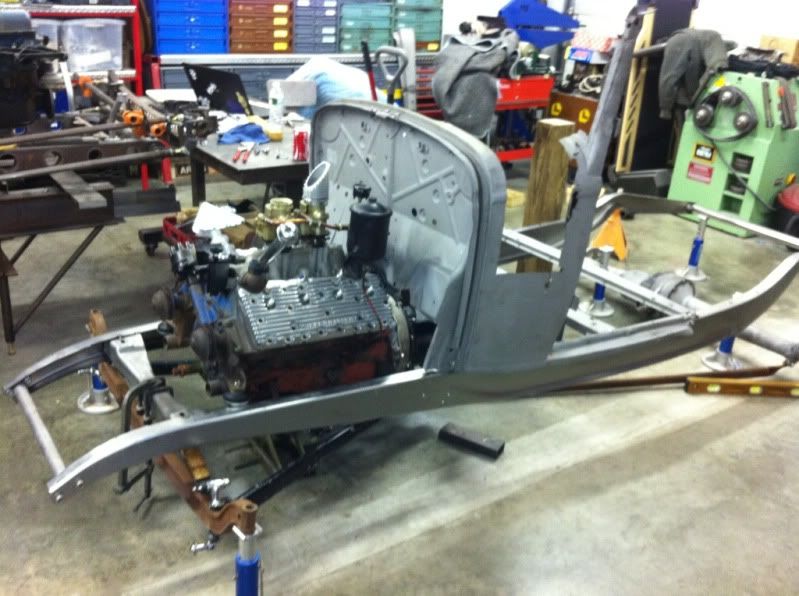

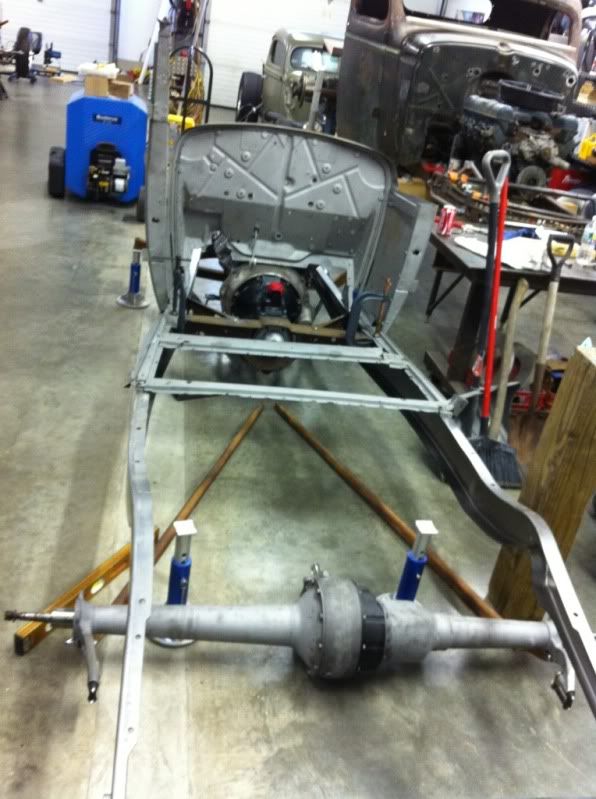

    so today i went and picked up my columbia two speed from richie willet its all good to go! (ends of tubes still have duct tape on the seal/bearing surfaces from being blasted)
    oh yeah and friday i had the local suspension shop make me a reversed eye main leaf for my 32 spring(had two made to put one on the shelf)
  22. juniorsrodshop
    Joined: Oct 9, 2008
    Posts: 266
    juniorsrodshop
    from nh

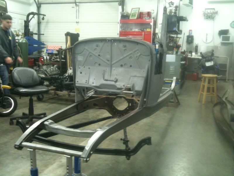

    front crossmembers in. k member is mostly in all the 5/16 rivets are in. and rear member is being blasted by a local friend. still need to shorten the torque tube.
    [​IMG]:D

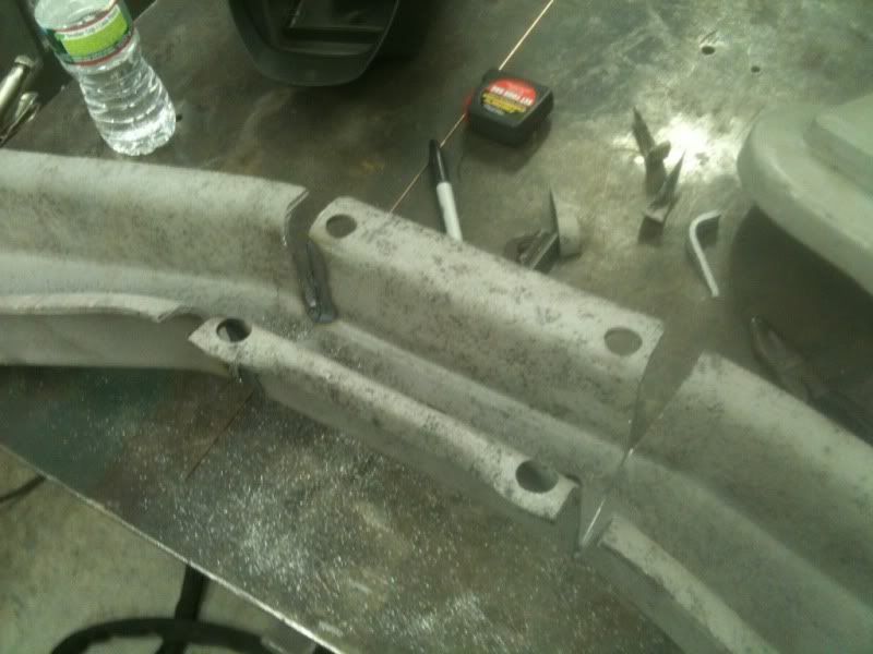

    from nh
    flatened the rear 40 crossmember yesterday. waiting on trans mount and motor mounts from drake.
    still need to cut down to size to fit in the 32 rails.

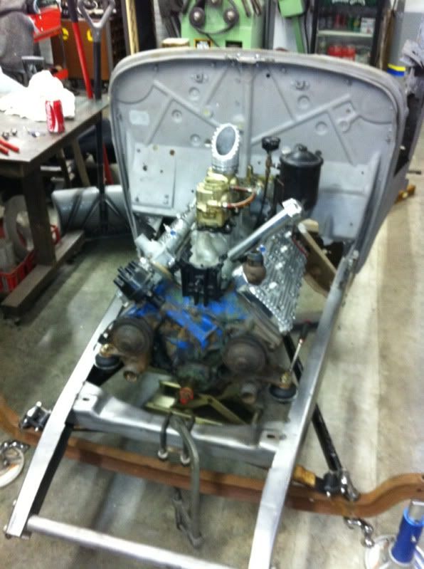

  28. juniorsrodshop
    Joined: Oct 9, 2008
    Posts: 266
    juniorsrodshop
    from nh

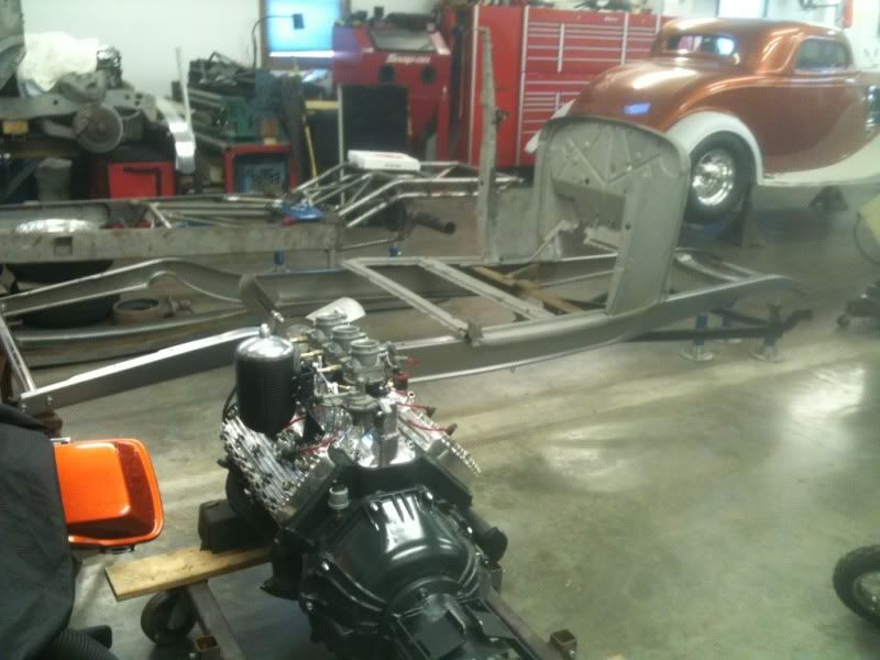

    got the motor sitting in place, ****** is all mounted up. i need to make motor mounts this week. then im jumping on shortening the torque tube and getting the rear crossmember in... ordered the rear tires last week to!
