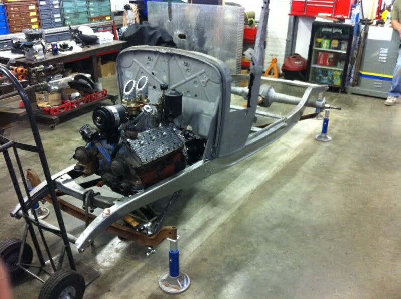

    got some work done today... shortened the torque tube 16" and shortened my 37 rear wishbones 6", rebend the angle of the wishbone in back and relocated wishbone mount on toque tube.
    pretty happy with how it came out... heres a up to date picture of the whole car.

    I really dig how this is turning out. You don't have the body on there yet and you're still ahead of me. :D
    Motivational. For sure.

    thanks man yeah i should have the rear crossmember in this weekend and then ill be getting the body into place i got the brookville rear floor this week just need to order some more patchs but it should be too bad.

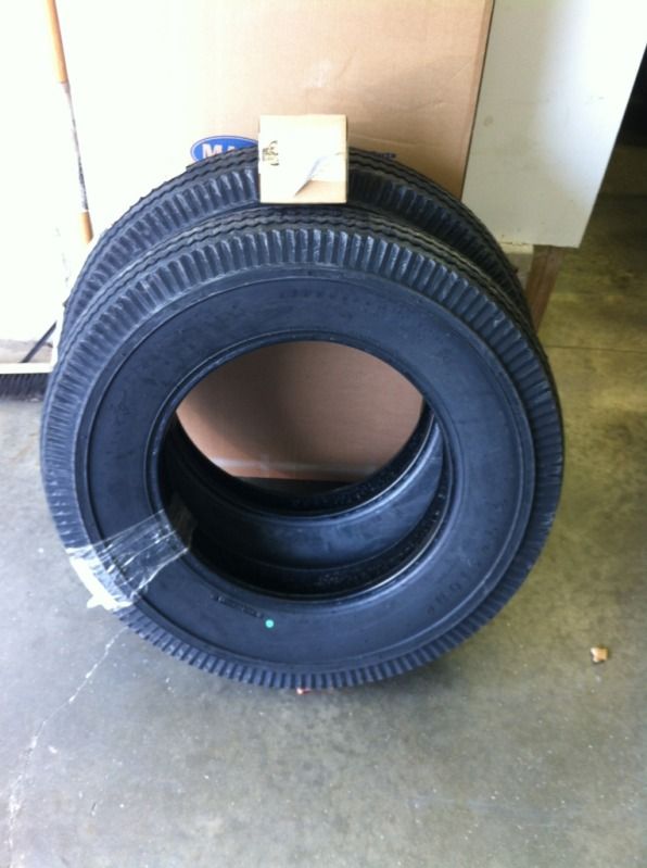

    Rear tires came in today! Be hopefully rolling mid next week definitely going to mock them up tomorrow.
    600/650-17 firestones
