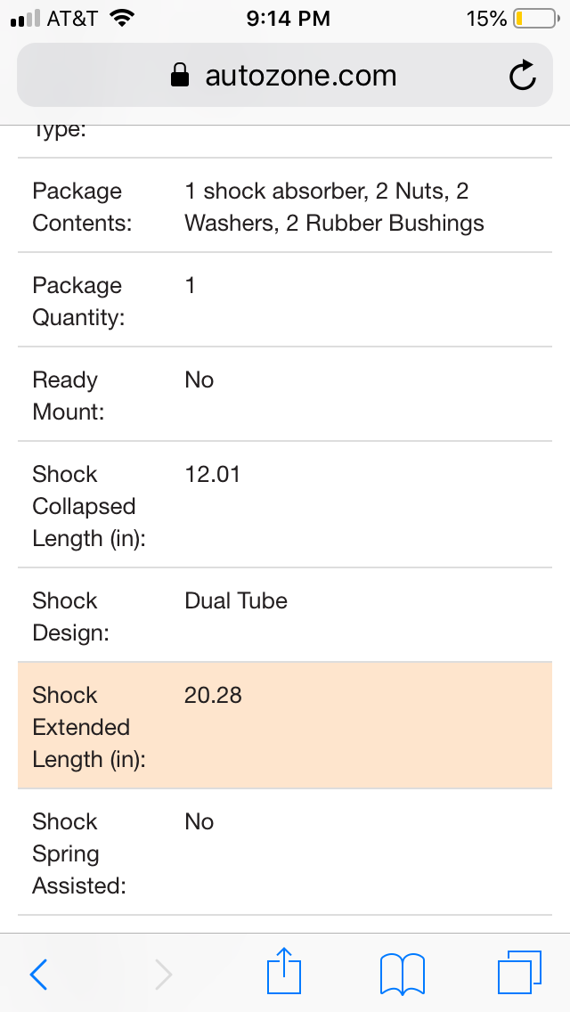

  25. The parts store sites have sizes when you hit the specifications tab
    This is for a 64 nova. It lists how it’s mounted and extended/compressed heights. This method is how I buy shocks when I do custom stuff.
