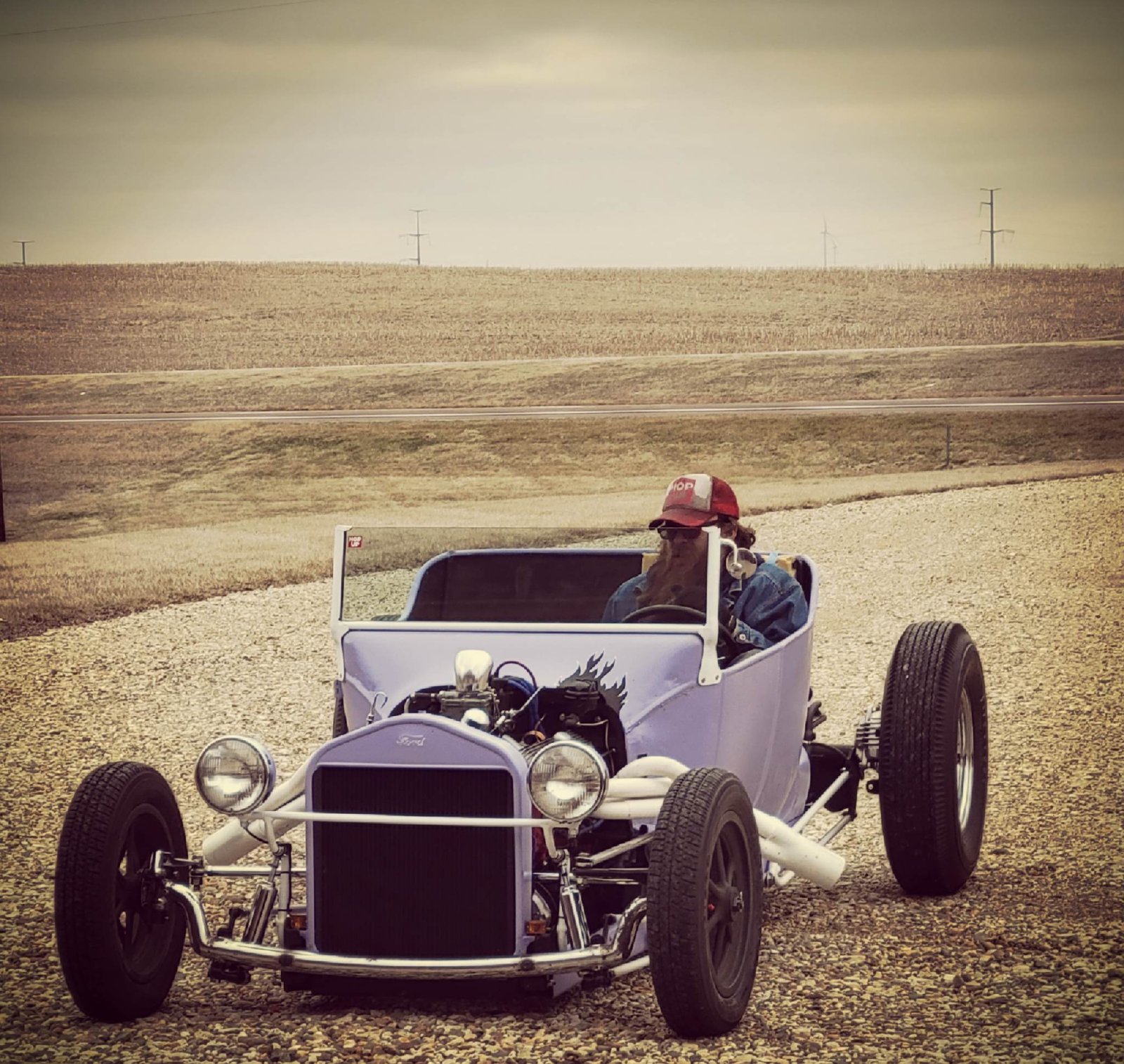

    I did work on the turtledeck this weekend, but I got too distracted driving it!
    went out to my friend Josh's place to pick up a part and bs for a little bit.
    he caught these picture as I was leaving.
    and a slightly edited one.
    On the way home I p***ed some old friends from Iowa, and pulled over to say hi, they got these photos of me.

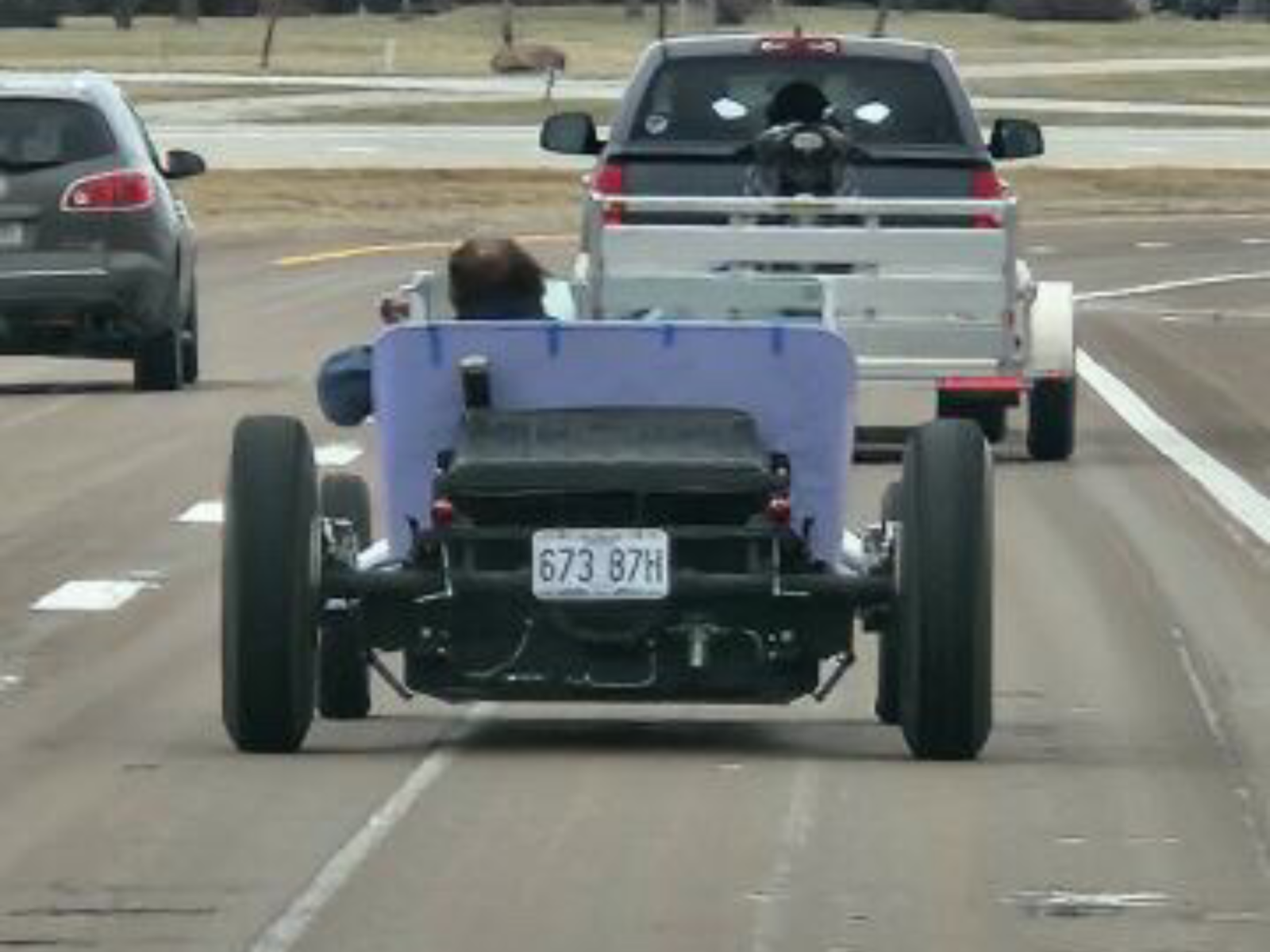

    Nastiest T bucket around 9271609C-3A90-4998-8838-5C27ACCF429D.jpeg I mean… from the view it’s also the calmest lol
