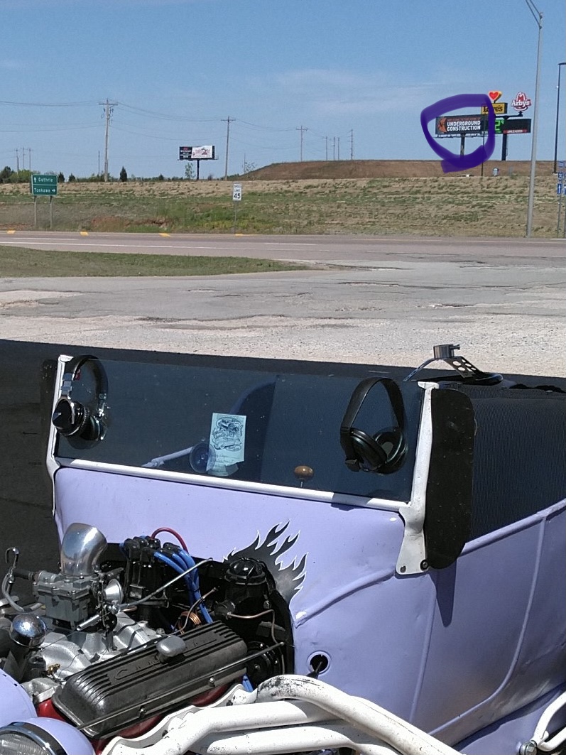

    I was surprised when I found my LED light stuck to the underside of the trunk. it had traveled over 100 miles stuck there, and had gotten s****ed up on the face by the rearend moving up and down.
    Oh, and this is why the coffee sounded good.

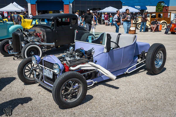

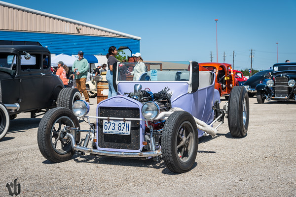

    As a bonus, heres a couple of the photos Matt, (@Tex***peed ) took of the T.
