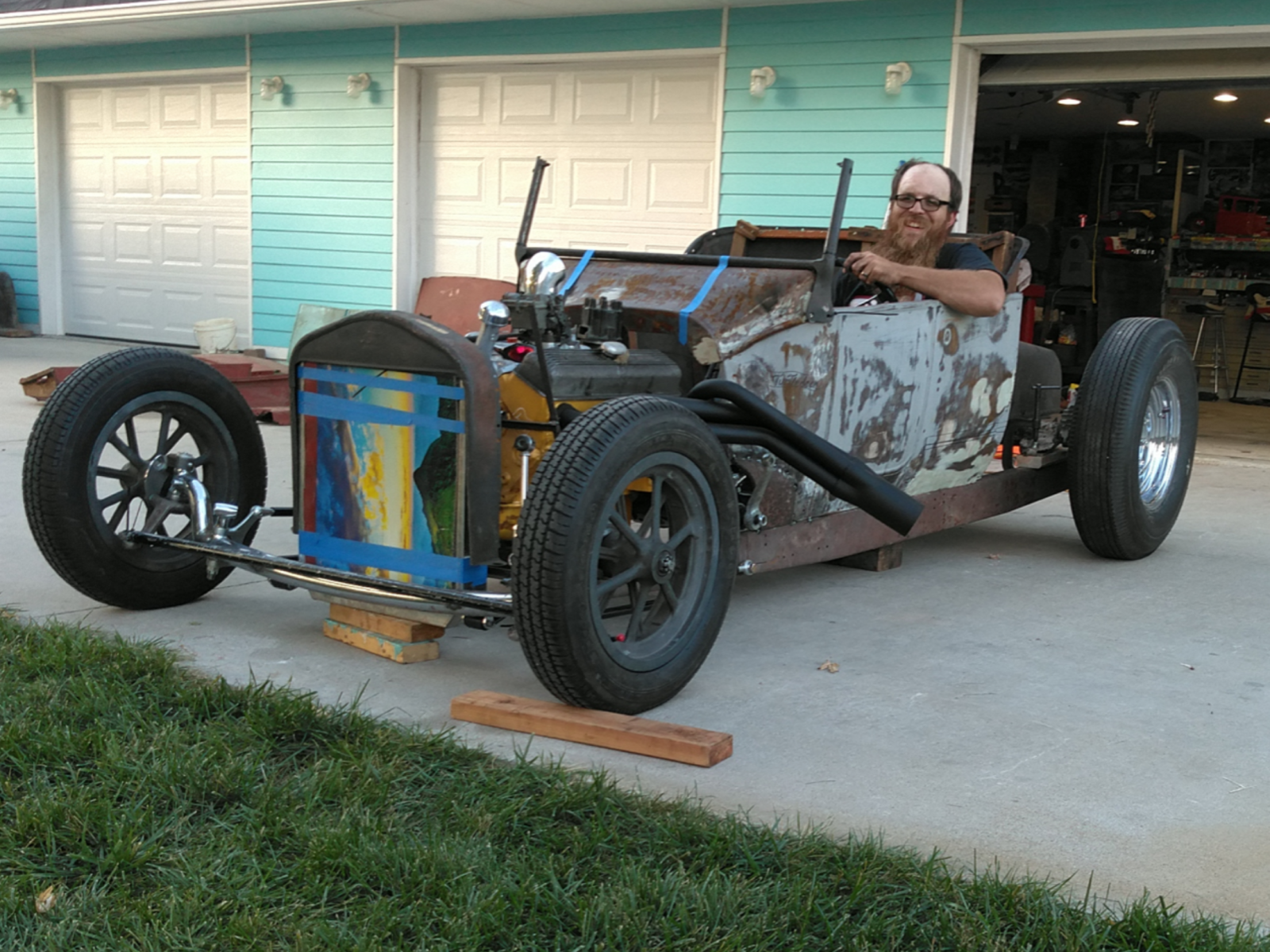

    before I continue working on it today, I wanted to update where I got yesterday. I got the pedals bent,
    Built most of the cowl bracing, using 1x1 tube on the p***enger side and 1x1/8 on the driver side. I also got a rough draft of a steering drop tacked together.
    I then wanted to see it with the steering drop filled, and my favorite gauge installed, I've been waiting to use it.
    I also installed a floorpan/bellypan mockup.
    and for those who have asked, here's how I fit in it. for reference I am 6' with size 13 shoes.
    as I sat in it, i started to think about where stuff would go so I could reach it. i decided that the battery could live on the floor under my feet (gel type on its side) in an original coil box ( if anyone has a lid im looking) and the switches and fuse block would wind up under the driver side seat.
    I also played aroundwith paint a little bit..
    another episode tomorrow!

    I like hairpins. Radius rods that is. An awful lot of expert HAMB keyboaders told me that's not a good way to go. I don't care. They just look great. That's what is all about after 2014-07-17 15.32.32.jpg all,
  28. Frames
    Joined: Apr 24, 2012
    Posts: 5,439
    Frames
    I like the 27 body for more foot room. I even widened the front 2" at the bottom. But I prefer the 23 T turtle deck. I built that out of aluminum. GOODSGUYS   PACKARD 017.JPG GOODSGUYS   PACKARD 017.JPG GOODSGUYS   PACKARD 017.JPG
    catdad49, Vic Walter and BigJoeArt like this.
