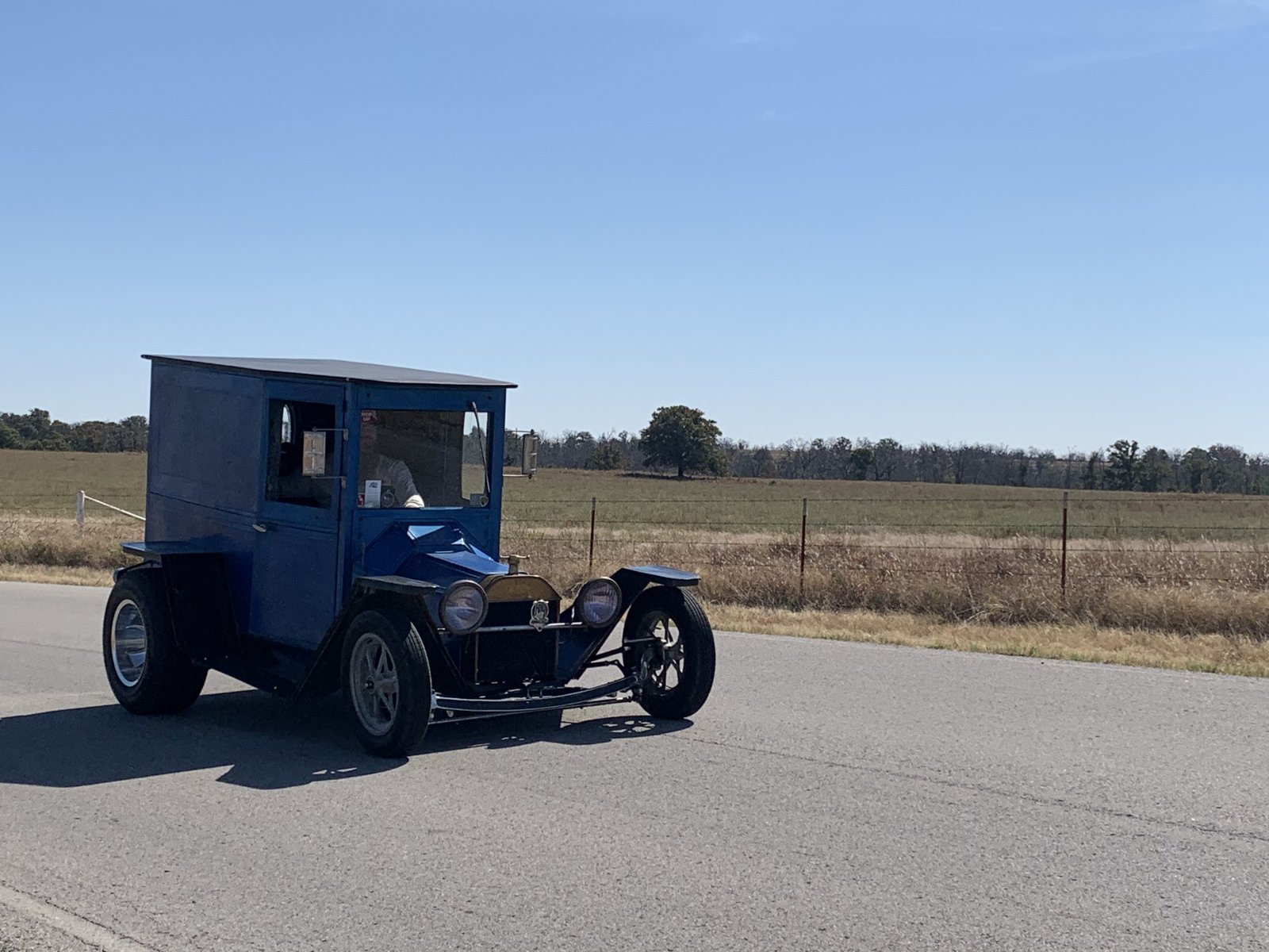

    Well I'm neck deep in cleaning up my shop for my open house, but I've been enjoying the heck outta driving the T every day its not pouring rain...
    I pulled everything out of my shop friday, and did a deep clean and reorganization of the fabrication area.
    then I drove it a little over 50 miles to one of the local shows I do the T shirt art for, and on the way home I weighed the T at the MFA.
    any guesses?
    I'll post up tomorrow.

    Sancho likes this.
  20. BigJoeArt
    Joined: Dec 12, 2011
    Posts: 996
    BigJoeArt
    and the moment of truth!
    with a full tank pf gas, (10 gallons-ish or 60-ish pounds)
    1900 pounds!
    @pprather got the closest!
    its right about where I figured it would be.
