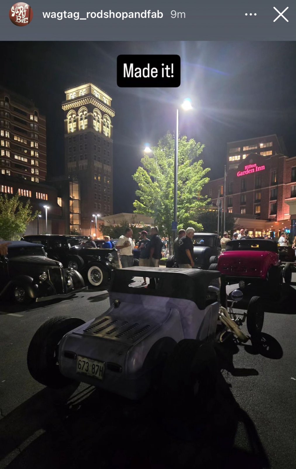

    Looks like he made it to pawhuska for the night. He made it! I think he lunched his 4th rocker, cracked his distributor cap and is using a ratchet strap as a motor mount. But he made it more or less on time, don’t think anything could stop him at this point.

    Pawhuska is 20 minutes from Bartlesville where the show is. Lots of people stay there.

  10. Tim
    Joined: Mar 2, 2001
    Posts: 20,771
    Tim
    from KCMO
    Looks like he went into town. I’m sure he’s ready for a cold drink and no driving lol IMG_6392.jpeg
    brEad, High test 63, El Hueso and 9 others like this.
