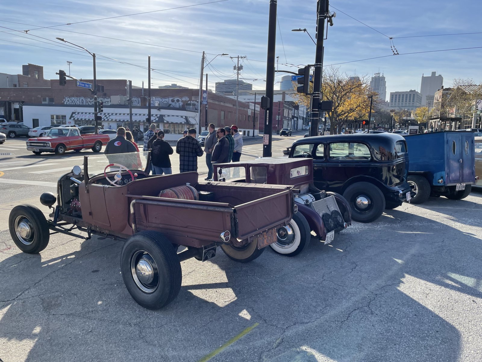

    on a bit of a corelated sidetrack, yesterday I met up with some buddies down in KC and had breakfast and visited a couple shops. we had a good day parking wherever looked good, and generally causing disruptions to average peoples Sunday morning.
    all in all a good day, and I picked up a couple of T grilles that are better than mine so I can cut the front shock . . horns? . . down. hopefully I can get it all mounted today.
    whew. that's it for now. we are now up to date again.

  23. Tim
    Joined: Mar 2, 2001
    Posts: 21,581
    Tim
    from KCMO
    D47275D2-D0CF-483C-90E3-321B9B6608AF.jpeg Yesterday was great day
