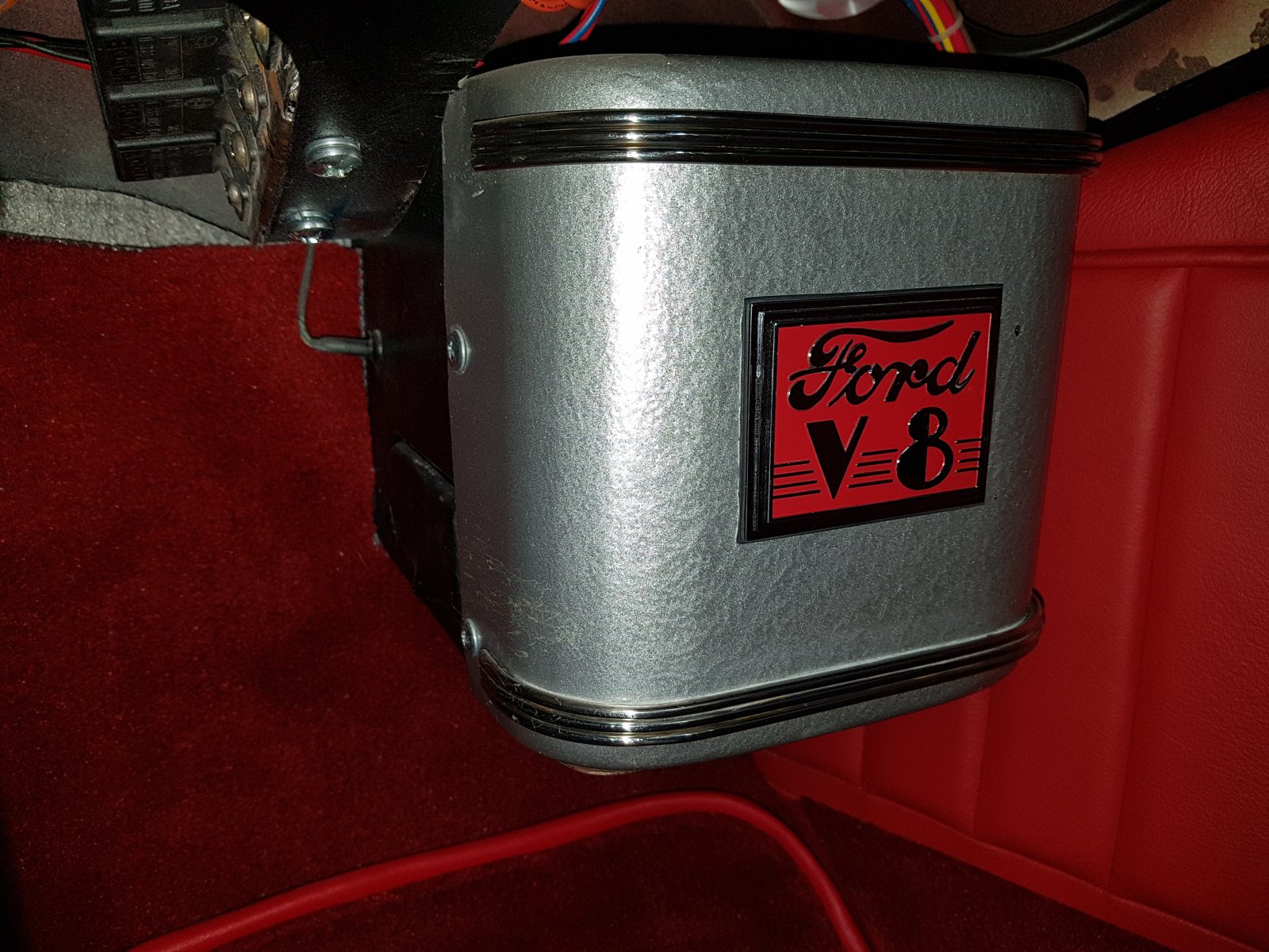

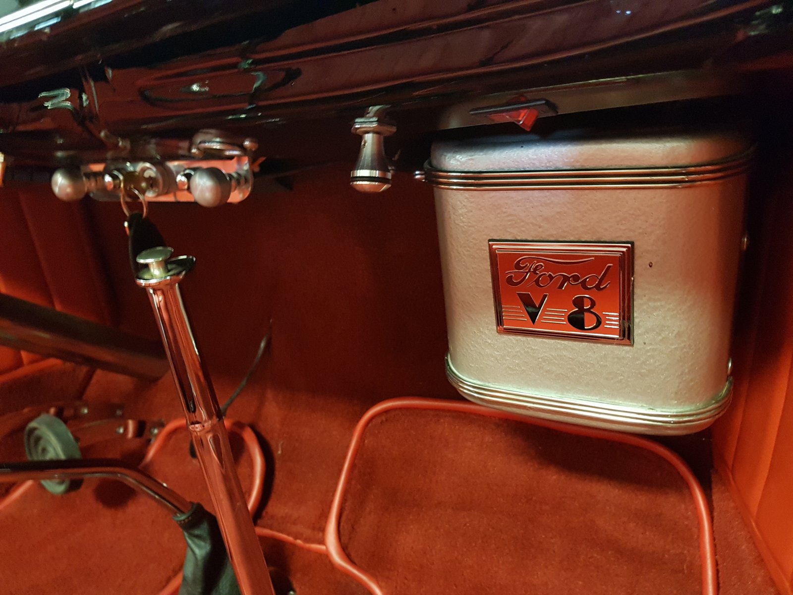

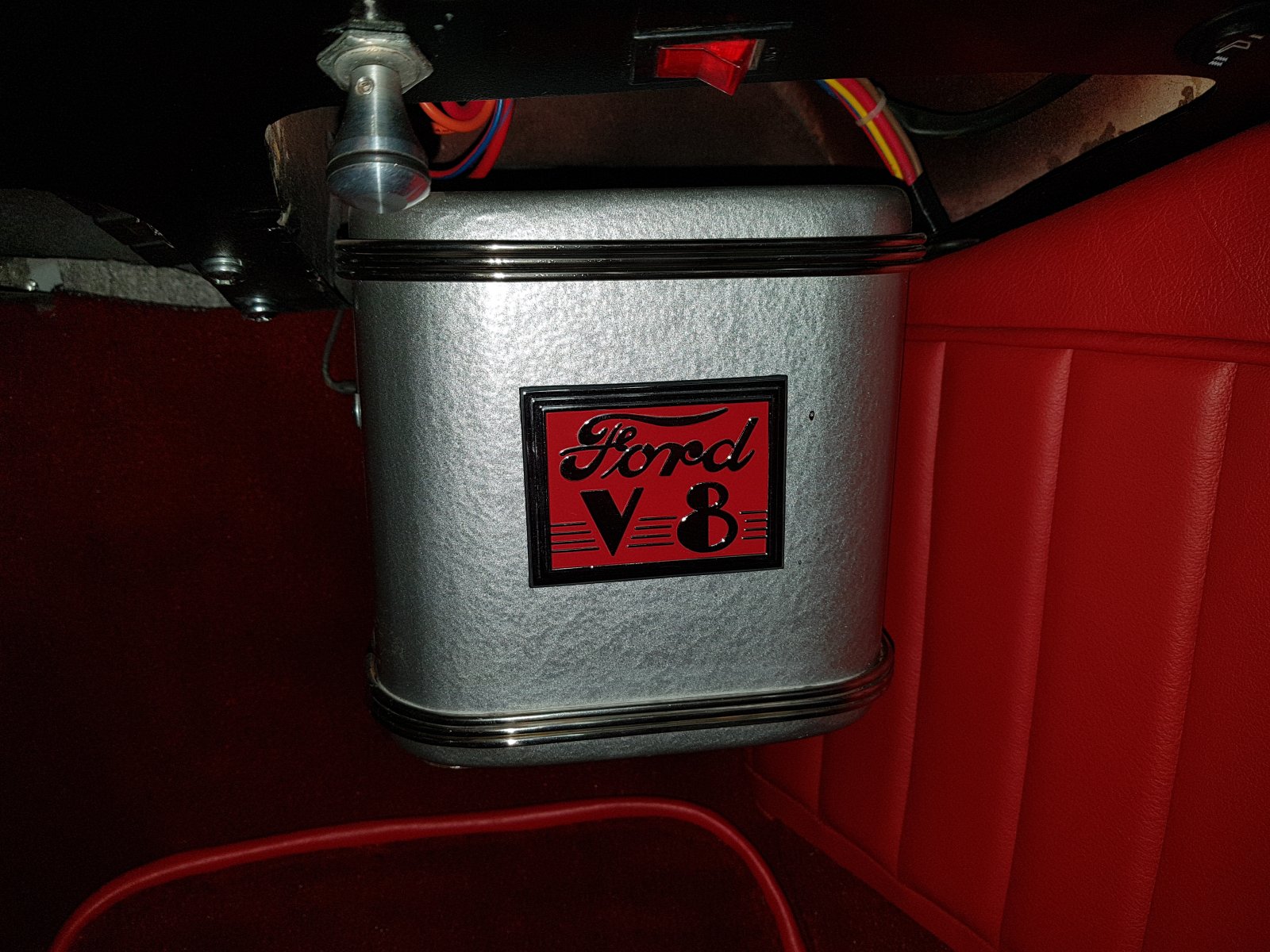

    Been watching and enjoying your build. In case you're looking to "retro-ize" your Sears heater, here's a couple pics of one I used in my AV8 roadster. I removed the front cover that came with the unit, made a new front sheet metal cover with rounded corners, moved the front flap to the bottom of the new cover, used some oven grates cut and tacked together to make art deco looking trim, put a 1940 Ford trunk lid badge on it and spray bombed it with hammertone paint. It got some compliments and looked the part of the era.
    Paddy Garcia, Tman, Bugguts and 7 others like this.
