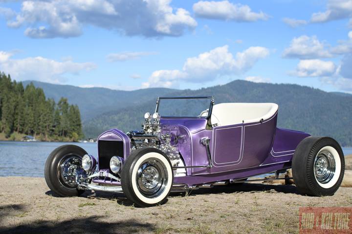

    Looking good. Great progress. I’m sure you are familiar with this car but here’s one photo just for the motivation. It really has the same good vibes and proportions that you have in your car.

    I would be wrong if I did not give credit to Russ for building a beautiful car that definitely swayed me to the thought of purple.
    Mine will not be as nice as Russ' T but with any luck I hope to drive it just as much as he does his.
