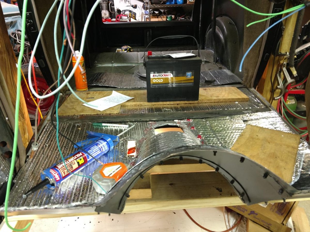

    From this point I moved to the inside of the body and continued working on the battery mount. I had made one up but I then thought I had a better idea - using a longer base for it to cover things and spread the liad. That would unfortunately cover the rear-most body bolt access and the drain hole (from when it was a rumbleseat) on the driver side. The body bolt access I need and after thinking about it, I decided to use that drain hole for my gas tank vent. But while deciding what to do I installed some floor insulation ...
    The gas tank I am using is a 16-gallon Vintique unit and it has a nice vent pipe build in at the inlet. But, depending on the gas station and if your car is level or not, you may overflow out that pipe. So I came up with a plan to have a loop in the trunk to hopefully stop any possible overflows ....
    I will connect this overflow tube underneath the car and the loop should help in reducing any overflow out the vent tube.
    My idea for a longer battery base/hold-down was then abandoned (after slicing andv
    dicing up a new base ...) and I went with the original design ...
    I needed to put the battery towards the back of the car for easy access. The stock 32 5-window seat back does not allow access to the trunk area of the car. It would be impossible for a shorty like me to reach a battery directly behind the seat. I used an old belt to keep the lid on, and some heavy rt angle iron from the hardware store to keep it in place. I also put a screw towards the end of each "foot" to hold it down in the front ....
