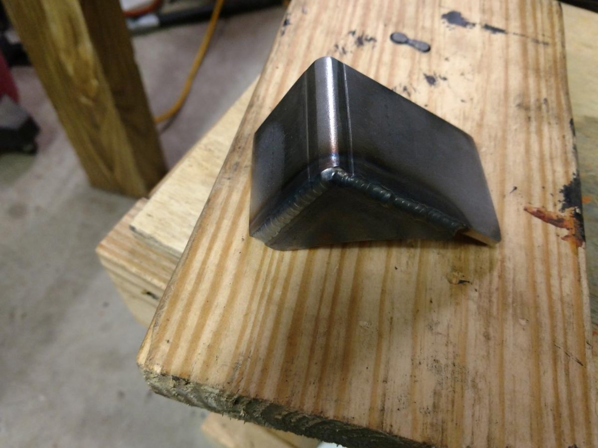

    Took care if the grands today but they are close by to Dave Havlir's shop. He was nice enough to help me make a mount for a singular amber accessory light for the p***enger side front frame horn. Sorry I do not have a pic at the moment but I thank Dave for his help and letting me use his shop. I am also making repair pieces for the 40 Ford STD and 40-41 pup p***enger side cast grill. They always break in the upper and lower fender side corners. I made patterns for the bottom corner out of some heavy plate which will be welded together and epoxied in. Yes, you will see a little bit of the plate but the new cast versions are up there in price and with a little time and effort these grill sides can be saved and be stronger in those areas than the casting itself.
    Although that's for the next build of my wife's 40 pup, when the opportunity presented itself to make them I jumped on it .... might do a tech thread on it when done .....
    loudbang and D-Russ like this.
  28. TomT
    Joined: Dec 11, 2003
    Posts: 4,682
    TomT
    Here are the pics as promised ....
    Dave has a huge metal break so we cut a 2"x4.5" piece of 3/16" steel and bent it to fit within the front framehorn channel with enough to use the accessory light mount ....
    We found a triangular piece if steel to act as a truss and a cover for the mount bolt ...
    I then drilled marked and drilled the mount hole ....
    The light mount is basically a front to back swivel/rotate ...
    I just need to orient the light left to right ......
    Going to be a busy next few days family wise ....
