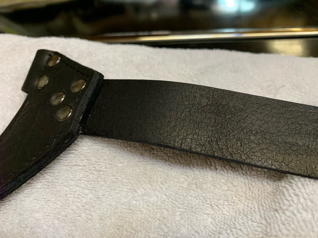

  4. TomT
    Joined: Dec 11, 2003
    Posts: 4,682
    TomT

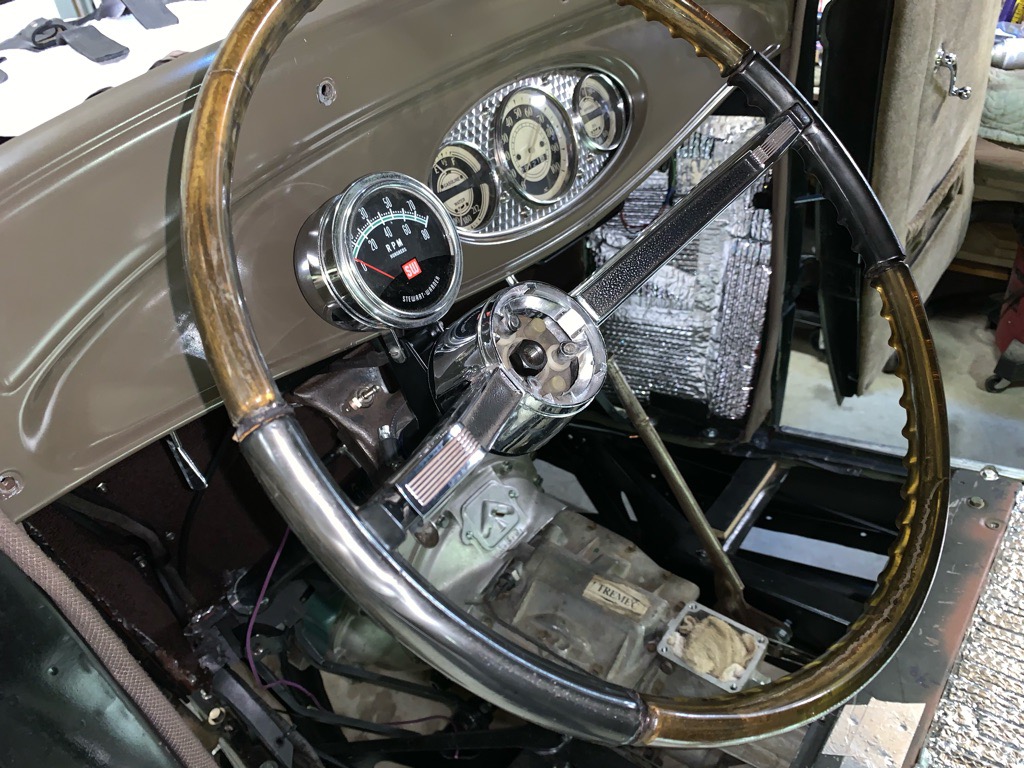

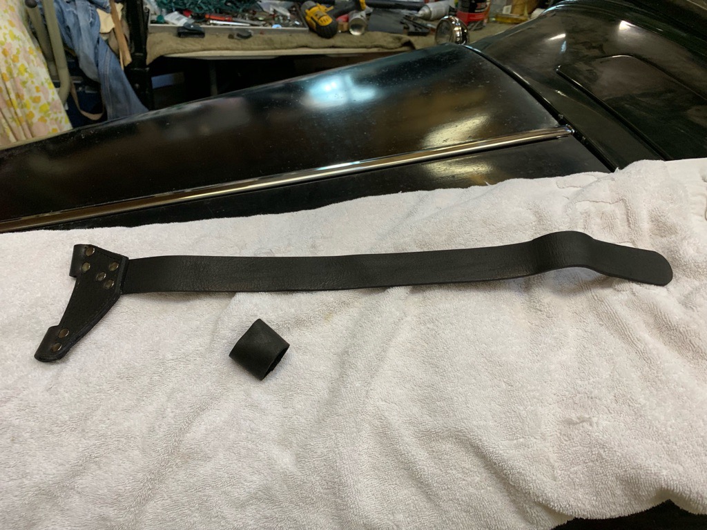

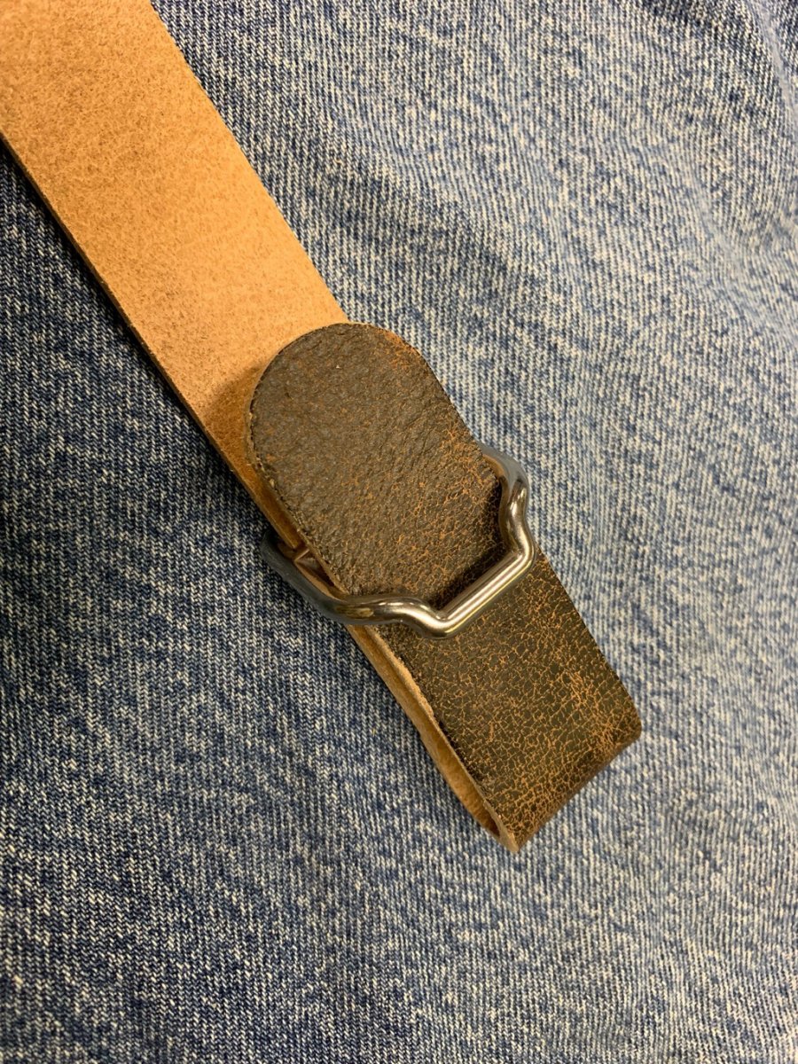

    Worked on dying the hood straps today.. This was the actual color of the straps as I got them.
    I just coated the straps with the applicator given and wiped down the straps with a clean dry cloth after they were coated. I used this stuff
    And the result was pretty good ...
    The original finish was “distressed black” - and the end result looks like an old leather strap, similar to old leather jackets ....
    I really like the look and the result is much better than what I expected.
    The steering wheel I am using has a gel coat ****ed up to a plastic center. However, the gel cost and the plastic had separated over time leaving the center hoop exposed. I was going to use the chrome clips like on a 62 Chevy wheel but they really cannot he used for my application (bare rod). I then thought of using stainless steel rod to fill the void but was too hard to bend. I went to a br*** rod and got it in there but not without marring the metal. My present solution was to tie a piece of rawhide into the gap, glue it with gorilla glue, and trimmed off the excess. I then used the same black die to touch up the rawhide.
    I don’t know if I will keep this look but it’s something at least for the time being ......

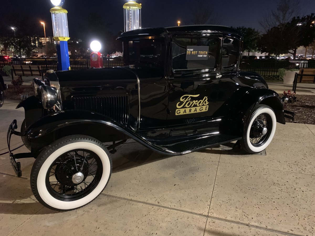

    While in Orlando we ate dinner one night at The Ford Garage - some really nice iron and such around ..
    Cars were sans drivetrains and interiors but the bodies were very straight .... I could not resist the bun pic! There was a 4-door A above the bar and there were 4-5 A engines displayed both inside and out.
    The tow truck was at Disney ....

    There is a Ford Garage near Vics. Very cool. In that one they had two car suspended over the bar with the wheels powered.
  8. TomT
    Posts: 4,682
    TomT
    Really cool place and even the food was good! Memorabilia all over the place including a big pic of the man himself!

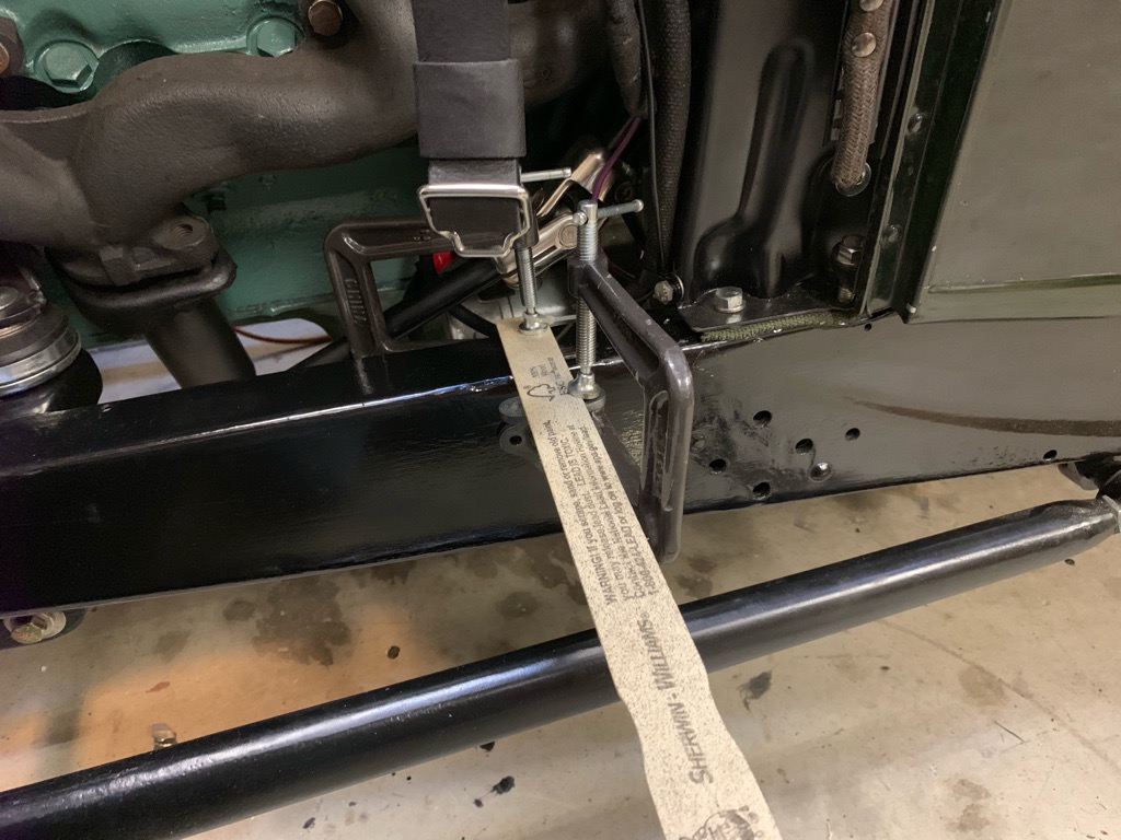

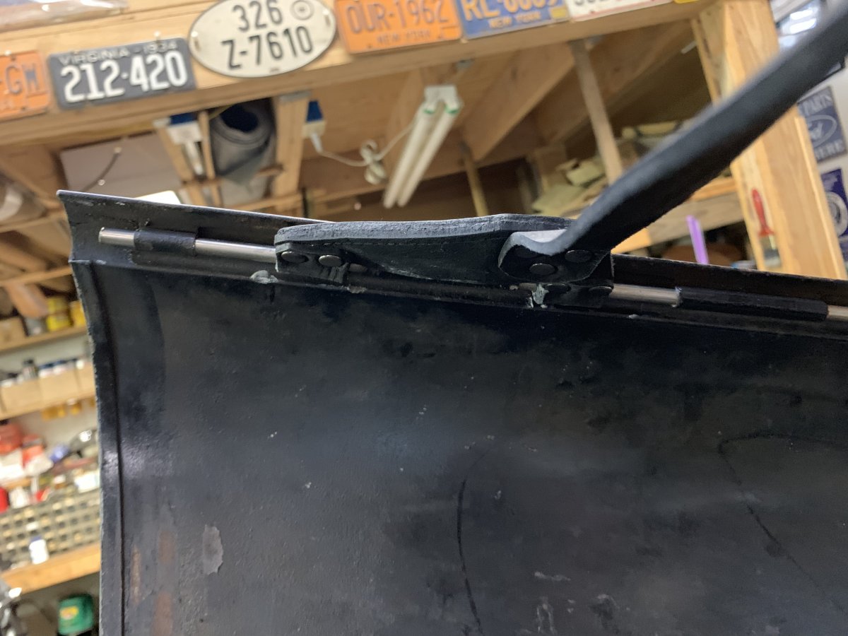

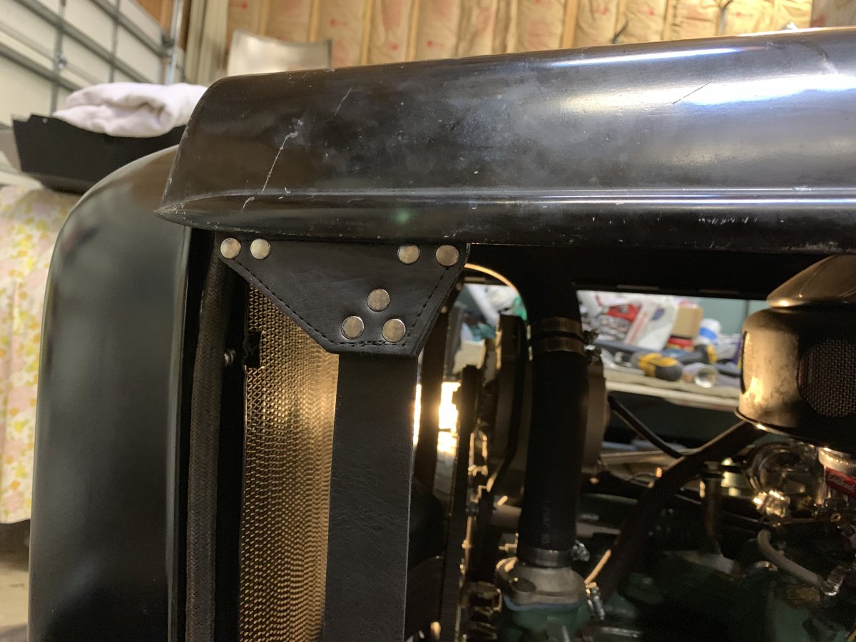

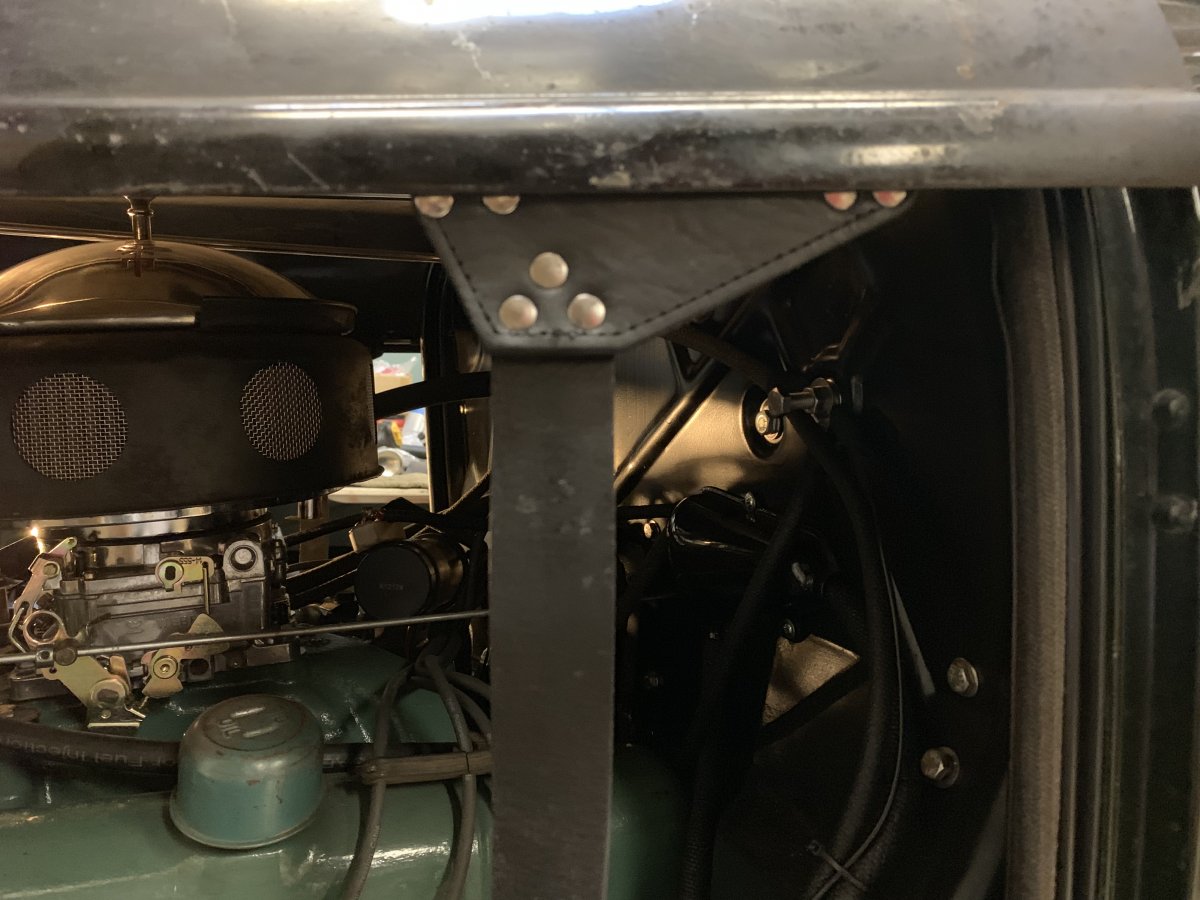

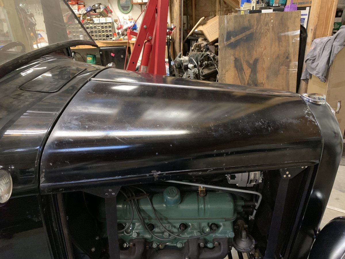

    Worked on the hood hold downs today - installed the dyed straps onto the hood ...
    Hot Rod Leather Eric’s straps are a tight fit but because they are tight they look really good. After a bit of elbow and white lithium grease and making something of a point at the end of the stainless rod, they slid into place.
    After a few more adjustments to the hood fitment, I started locating where the cowl side bracket I bought from me a fellow Hamber (sorry - I will get a pic out tomorrow). I lined things up in relation to the edge of the cowl, about where my roadster sits .....
    You can’t really see the bracket but it comes away from the frame nicely and should look good. After drilling location marks, it was off to the hardware store for the proper drill and tap. To be continued .....

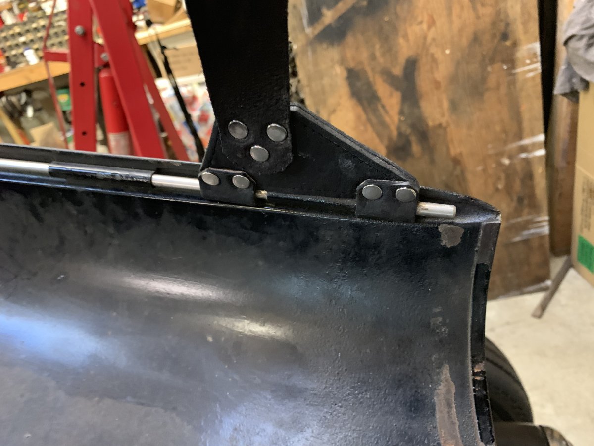

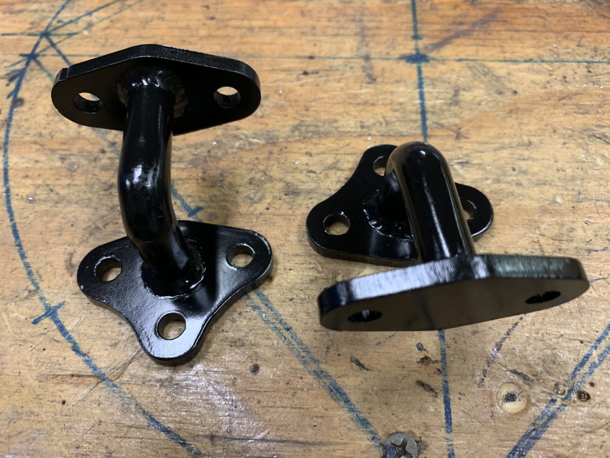

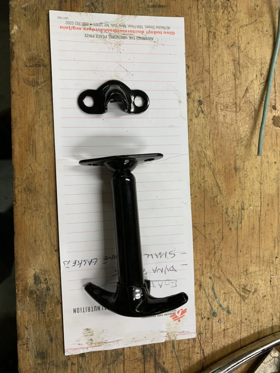

    So I got the driver side hood hold downs but n ...
    And here’s a pic of the cowl side brackets ....
    Ok - so I have a question - here’s a pic of the hold downs I got from Soeedwsy ....
    Is the small piece at the top necessary and if so, how does it go on? Or does it go underneath? My roadster has them on the top .... any help would be appreciated. As of right now, I was going to skip using them .....
    Bowtie Coupe, loudbang and D-Russ like this.
  11. Dennis D
    Joined: May 2, 2009
    Posts: 857
    Dennis D
    Isn't that what the hook goes into on the hood side? D

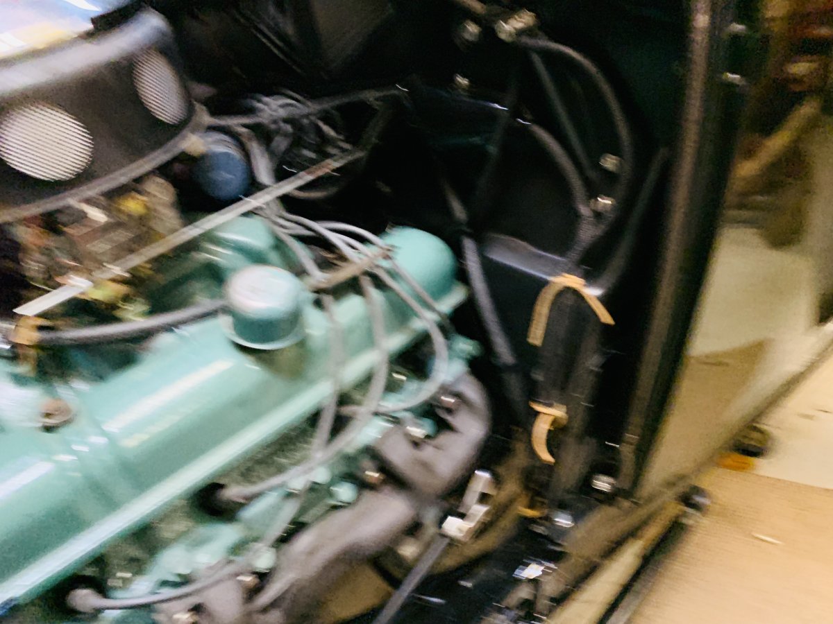

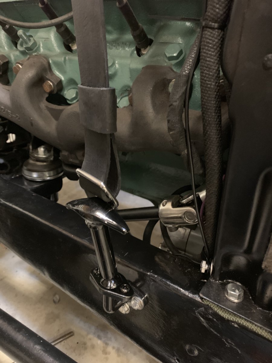

    Hood straps use the same rod as when you have hood sides - I picked up stainless rods, put a bit of a tip on one end and used white lithium grease to help in sliding them on ....
    P***enger side front .....
    P***enger side back .....
    They are tight. From the cowl lip to the center of the back strap is 5”, from the backside grill lip to the center of the front strap, 3”. I did not follow the stock holes - just made them close and what “looked right” to me ....

    Thanks, Dennis D - that makes sense. No wonder why I didn’t think of it! Lol!

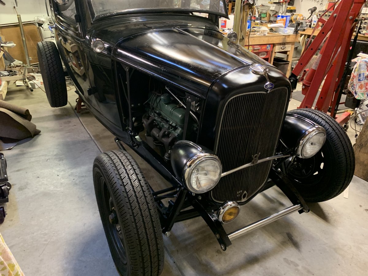

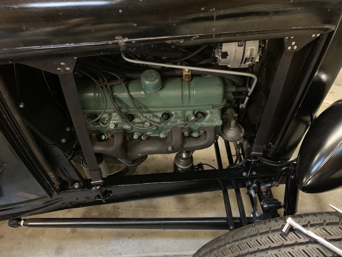

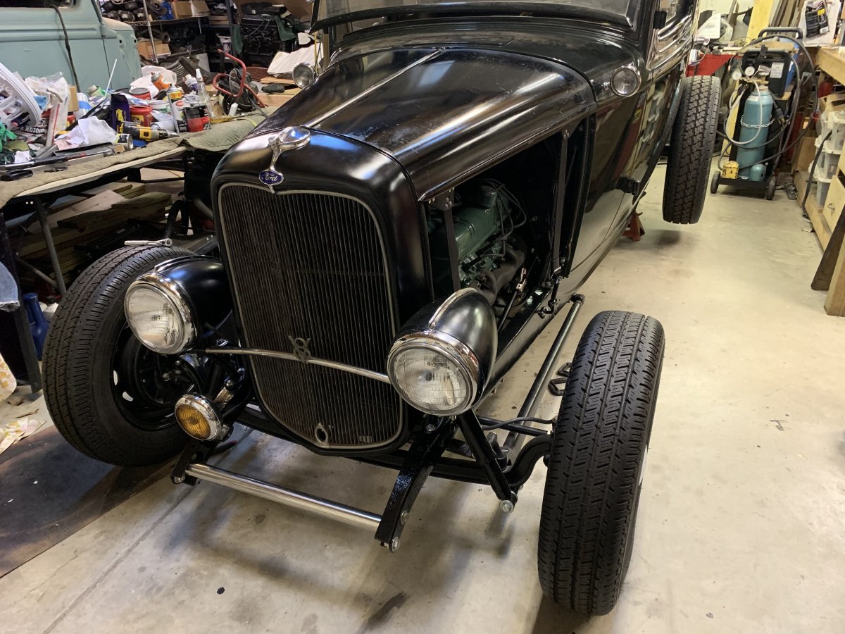

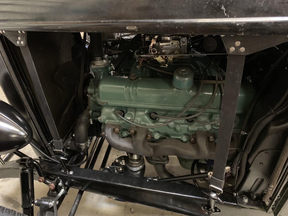

    So, save for tightening a few bolts and aligning the headlights, the FE is done ....
    19A78743-9364-4F09-A4A9-D77E68F1CA2E.jpeg DD861A9C-DD39-449F-92F9-A1BD957D6111.jpeg 2D9ED98C-7348-4474-8205-690711680F11.jpeg
    I cleaned up the shop and it’s on to the front floor pan and last bits of the wiring .....

  18. forty1fordpickup
    Joined: Aug 20, 2008
    Posts: 298
    forty1fordpickup
    The small piece is what the latch hooks to.
    The straps on my A use a saddle latch.

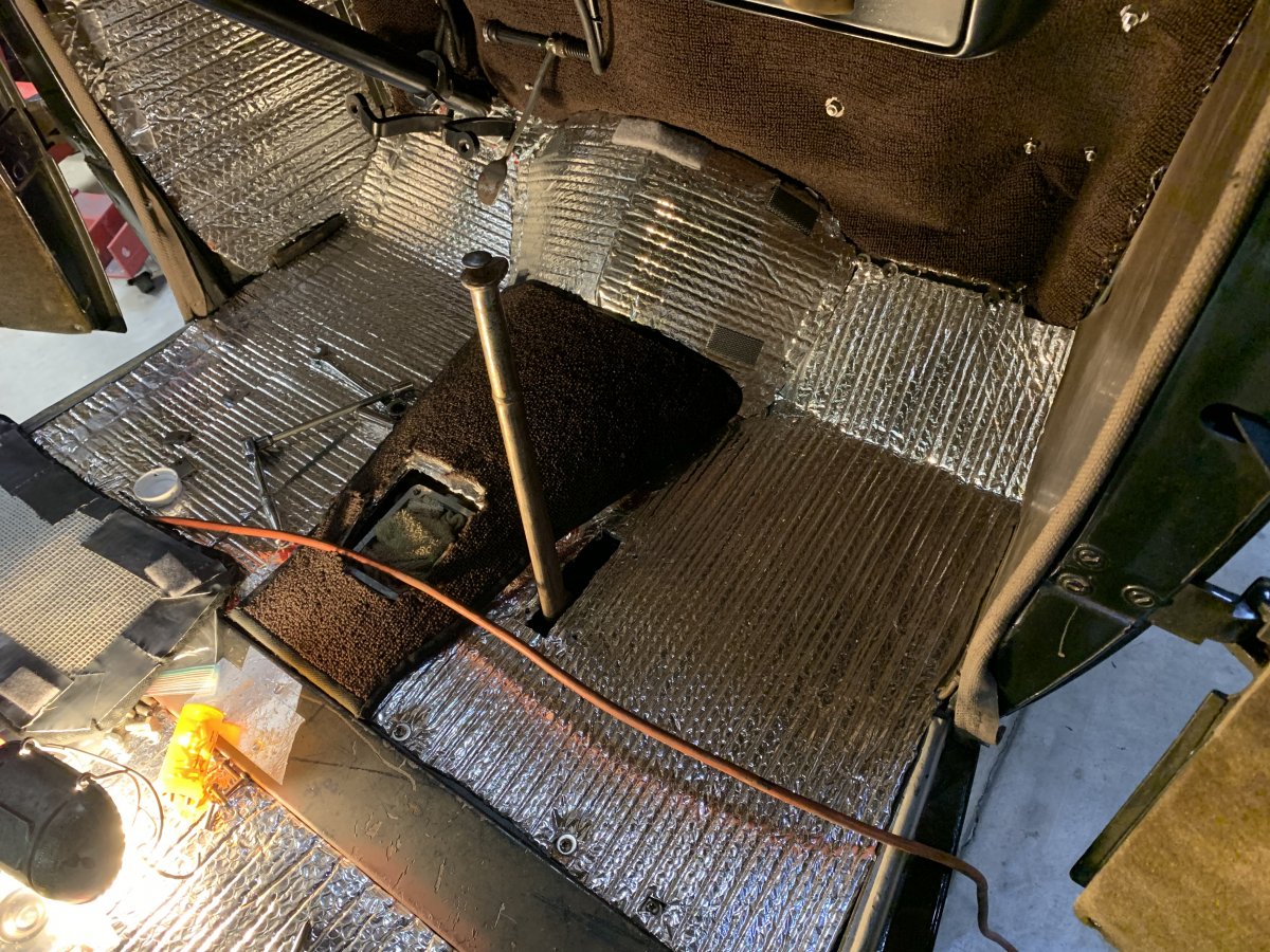

  20. TomT
    Posts: 4,682
    TomT

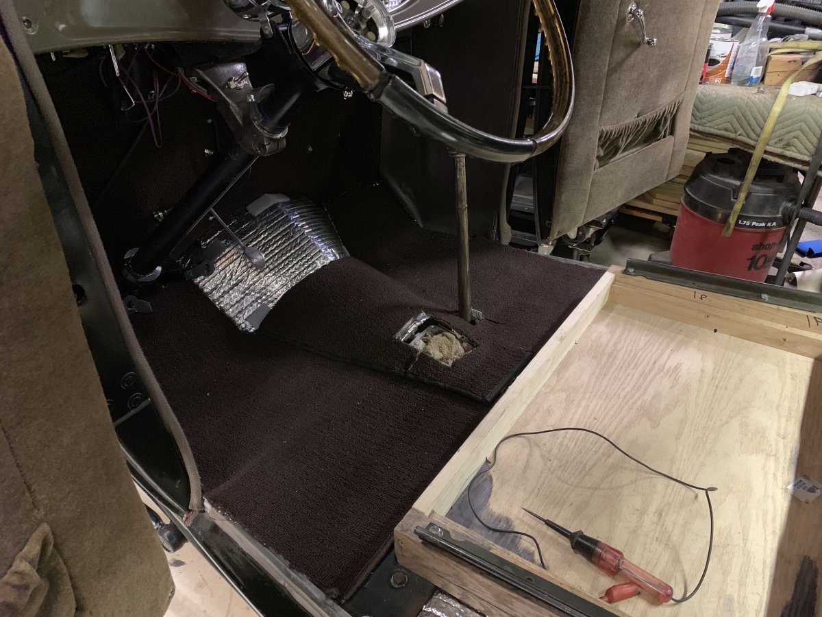

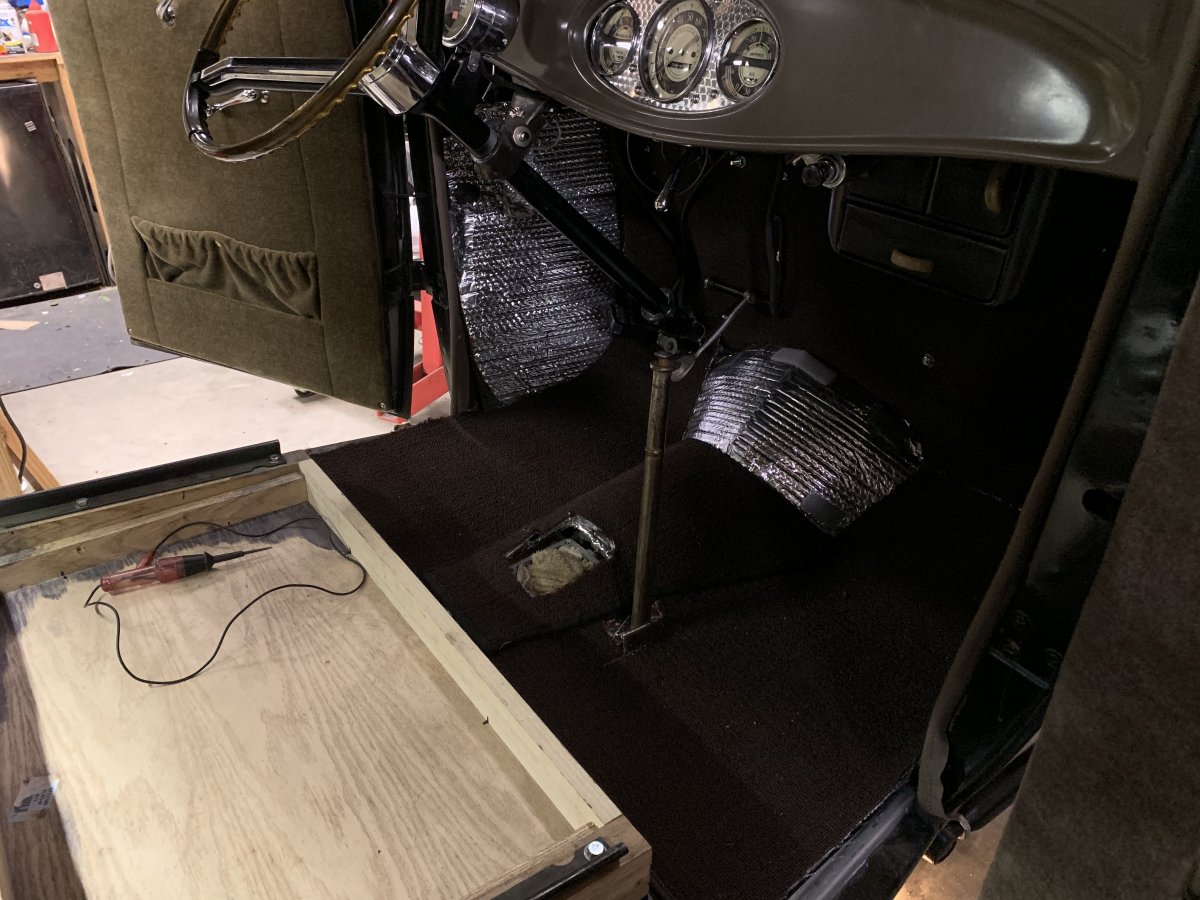

    So, got some time in today on the project. Finished getting all my wires out of the way and secure around the pedal area ...
    ... and here’s the way I ended up when I dropped in the floor pan ...
    I finished getting the pan all squared away - I had to shim it in a couple spots so it sat right in the body.
    With the pan done I installed the under seat box as the master cut off switch is installed in it and once I had it all hooked up, I had lights! What a relief! When I pulled the starter switch I heard a whirring noise so I did some other checks. I think the amp gauge wires which I have wired to my master cutoff are reversed as without them I have nothing and with them I have lights with or without the master cutoff being on. Anyway, I have some checks to to but I am closer....
    The carpet you see in place will not stay - I’ve started on new pieces as I changed plans of how to install them and instead of using the black binding material which I was not happy with I will use 3” strips of semi-gloss black vinyl.
    More pics on that tomorrow. Should be warmer tomorrow and looking forward to solving my electrical issues - looking forward to it! Getting closer .....

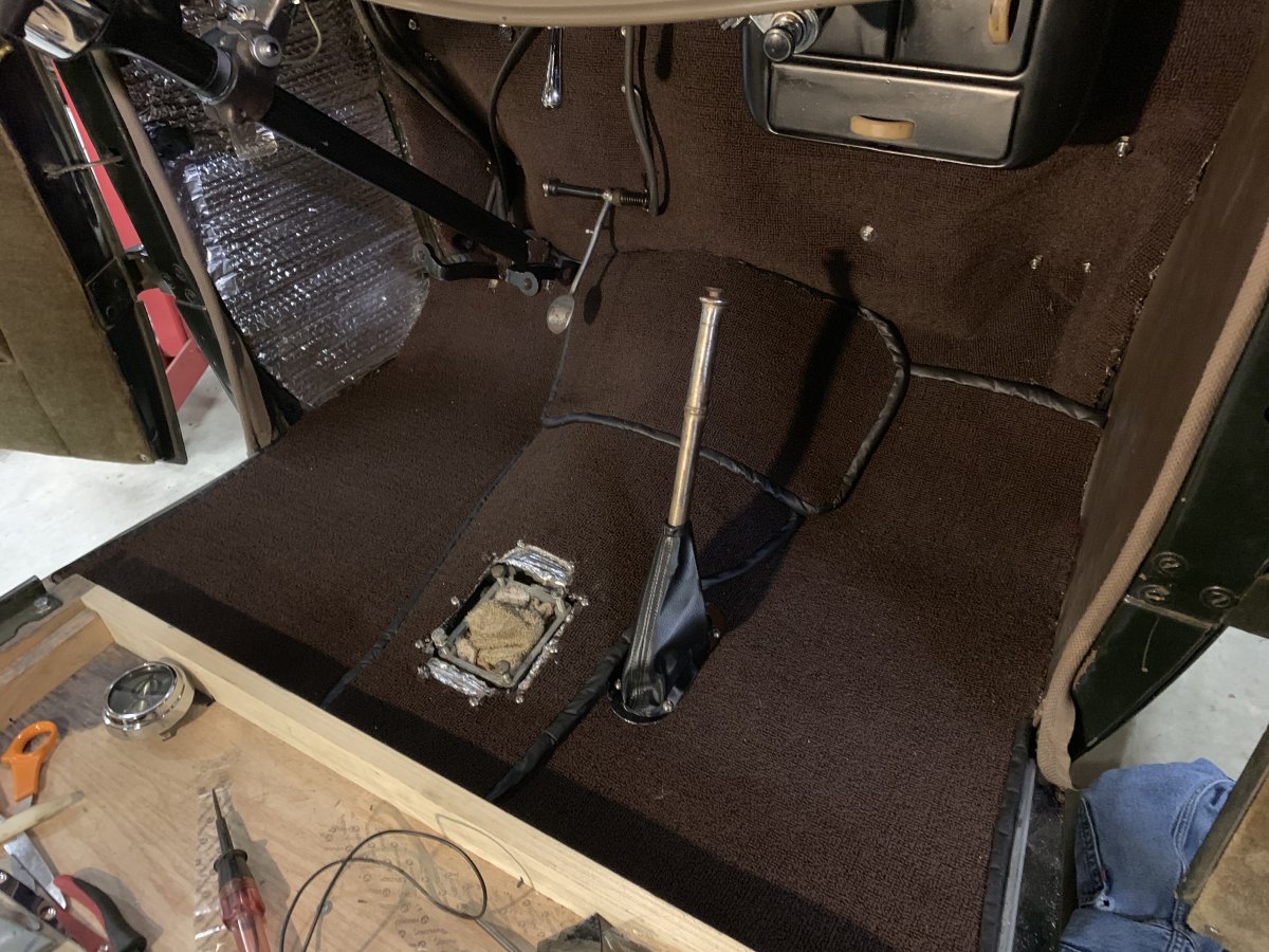

    Another good day - Car now has about 5 gallons of gas, put in my antifreeze and had a bunch of small leaks. Looks like I have them all squared away for now .....
    I remade my carpeting and center section, wiser now with how to work with carpet and not get unsightly pulls in visible areas. Working with vinyl was harder than I thought for the binding but the front floor and hump are done ....
    I have to make up some new kick panels. The driver side will be able to be modified but the p***enger side maybe not. Luckily Joann’s fabrics has vinyl nearly identical in color to the kick panels. I will reupholster them once fitted and use more of the replacement vinyl for the package tray outside surround. The inside will be carpet.
    The shifter is next and the park brake handle boot came out nice. Been going since 10, took a break and had lunch with boys, and it’s 8:30 now. But she is ready to fire up when my buddy gets here after we go through some checks .... Excited!
