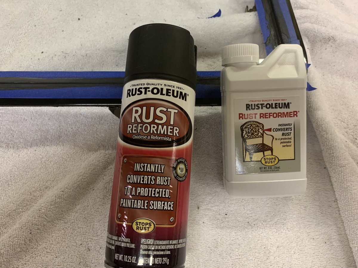

    Tom, Rustoleum has several different products of rust encapsulation. Specifically, which one did you use that has worked for you before?? I need to do that job and wud like to use a product that I know works. Thanks!!

    It’s in liquid form and bought at Ace hw. I used artist brushes from a dollar store to apply it. There is also a spray version I used on the door interior. I will post a pic of the bottle tomorrow.

    Thanks, Tom!! Yes, a pic will be a real help in matching it up. Appreciate it!!!

    Thanks a million, Tom!! I've seen that spray can on the shelves, but haven't seen the liquid. I'll be picking up some of that spray for sure. B C N U in about a month or so.
