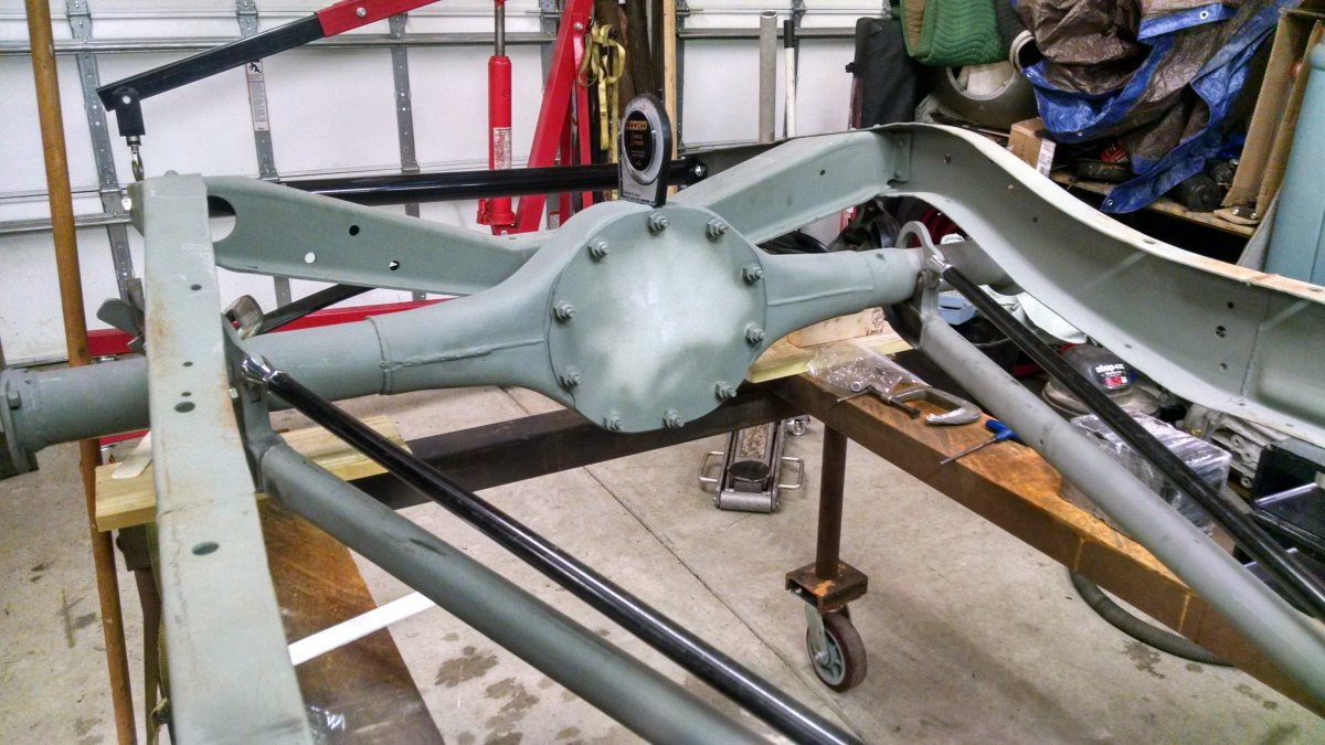

    So the frame is in the garage on the frame jig and I have been at it for about 5-6 hours today. I have installed the jig for the rear radius rods, gave them their first cut to mock things up, put in the rear, checked out the brackets, installed the FE - all in all, got the entire suspension in to see what's good, bad or indifferent. Several things need to be done ....
    1 - the brackets for the rear will need some kind of shims. They are designed for a 9" axle tubes which are about 3 1/4" in diameter. My rear axle has a step down from that tube size to 2 3/4" which most 9" rears do not have. So, I will have to make up some shims using 3 1/4" axle tube. But, that will allow the usage of these brackets with an 8" rear I believe which is a good thing ....
    2 - the rear radius rod will need to be trimmed where it crosses under the frame for suspension clearance and ...
    3 - the frame will need to be modified as well for suspension clearance. This is something I knew about but I now have a better idea of what I will need to do ... my neighbor Dennis has been a great help in setting up everything in my garage up to this point - thanks!
    So, here are some pics for you to peruse - so you know, I have shimmed the rear up so the brackets look like they would work as is - they will not.
  20. greaser
    Joined: Apr 30, 2006
    Posts: 866
    greaser
    Why not make new rear axle brackets to fit the axle tubes?
    Tim_with_a_T likes this.
  21. TomT
    Joined: Dec 11, 2003
    Posts: 4,681
    TomT
    Greaser, you are right - I am in the process of doing that .... Thanks!

  24. TomT
    Posts: 4,681
    TomT
    Got the new rear axle brackets in and they look great ... 3.125" at the top, 2.75" at the bottom:
    Setting them up in my fixture revealed a little t******* is needed .....
    After a bit of grinding I am very happy with the resulting fit .... nice and snug and a great setup for weld penetration ....
    I really like the nice fit - on to the next hurdle to overcome ....
