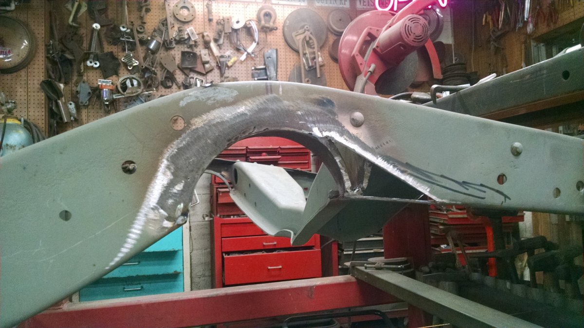

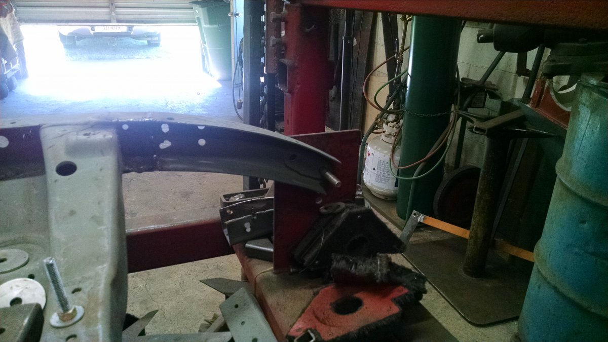

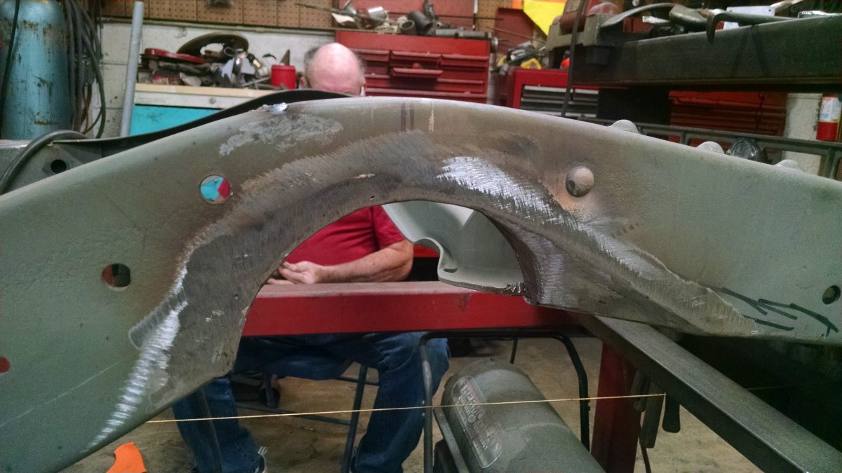

    More frame work updates - first, Jack installed the new (old) frame horns I actually got from him a while back ....
    Some cleanup yet to do but the front of the frame is nearly done. Then it was on to the rear C-notches ...
    The trim out to the back side is for the 35-36 rear radius rod clearance because I am using the shorter 40 Ford front spring and there is some frame rail interference without it ....
    After a bit more cleanup the rear frame mods are now done. I then cut out some front boxing plates from a template Jack made ....

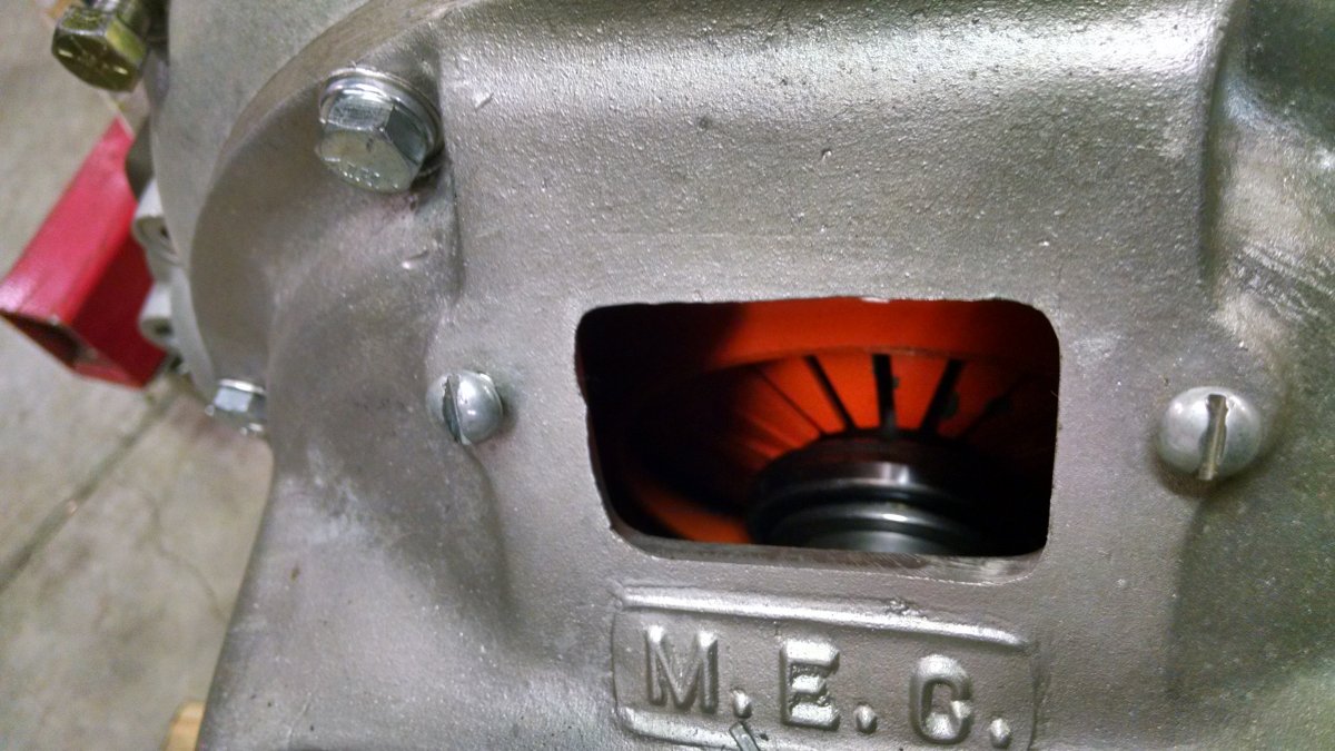

    Finally, I received the clutch disk I have been waiting for and I like the way the center hub is moved forward towards the ******, in essence helping to solve my problem. I will put things together tomorrow and see how much needs to be shaved off the adapter to resolve it ....

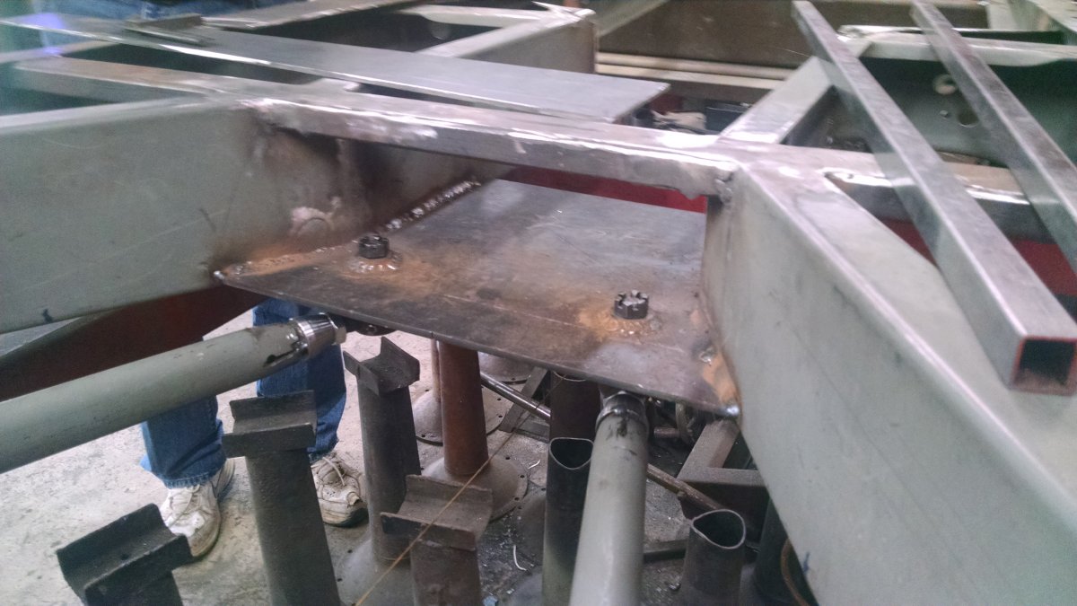

    Further updates - Jack now has the rear radius rods in place ....
    On top you see the front boxing plates and the 3/4" tubing to run wires on each side ....
    Sorry but I have no pics of the front boxing plates installed - they are inset about 3/4". I have picked up the mock up block and put together the motor and trans, motor mounts, ****** mount, exhaust manifolds, firewall, radiator and set everything in place, weld up the motor and steering box mountings, ****** mount, and trim the center mount plate of the rear radius rods for ease of ****** removal, and set the motor/rear angles.
    To say I am excited as hell is an understatement. I could not have done all that Jack is doing in the short time he has been at it. His frame jig makes everything so much easier not to say anything about his expertice in doing 2 frames ..... thanks Jack ....

    I also mocked up the motor and trans with the new clutch disk. The center hub in this clutch disk sets 1/16+ inch closer to the ****** so that's good. I will have to shave the adapter 3/8" - you can see the black line and indent in this pic -
    and cut down the old Ford t-out bearing carrier the same amount. It is tough to get a good pic but I like the clearance I have now between the fingers of the p-plate and the t-out bearing.
    Hence, taking off the same 3/8" will keep this distance. That will give me 15/16"+ of bite on the full splines of the ****** main shaft - that is the best I could have hoped for ....

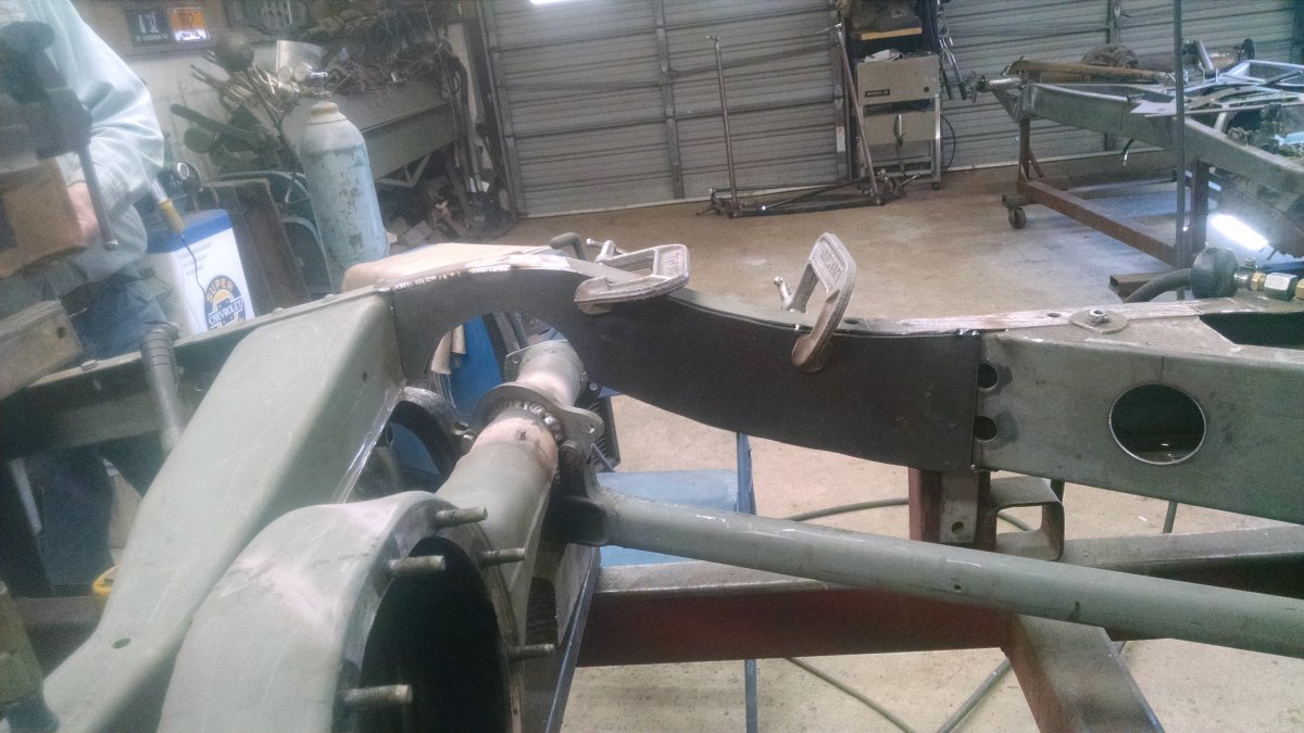

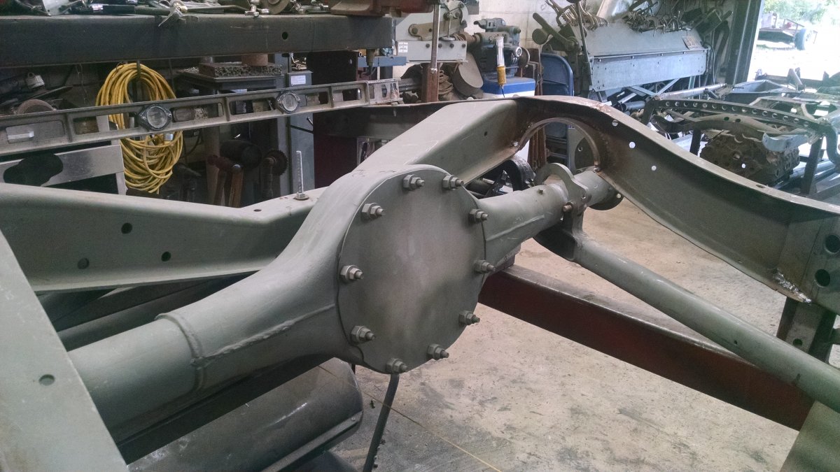

    Well, we were moving along - some roadblocks popped up today, or shall we say opportunities?
    First, the rear axle housing was bent so we spent some time getting that all put to rights .....
    Jack has an empty 9"pumpkin with 2" bushings installed. We installed it on the empty axle housing and a 2" solid bar is slid in. If call goes well, the long bar will go right through and out to the other end. We had a pretty good offset or twist on the p***enger side, and the driver side one to a lesser degree. We alternately heat and cooled the affected areas ....
    With the bar in, Jack has biscuits with large and small bearing sides that he slips on thecebd yo against the backing plate flange to make sure the bar is properly centered. He then heats up the axle housing and let's it cool naturally so the housing will remain in that configuration once the biscuits and bar are removed.

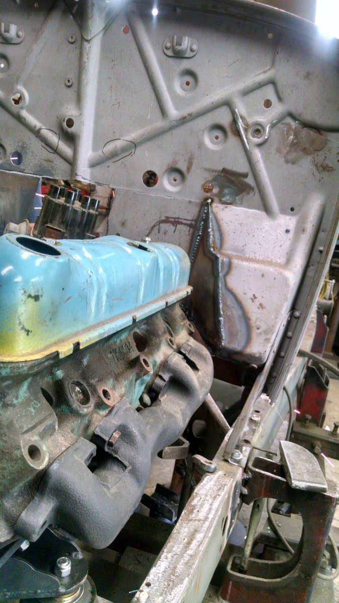

    Next problems are the brake and clutch pedals ....
    As you can see, the brake pedal will run into the bellhousing due to the Nailhead having the starter on the driver side ...
    We are formulating a fix - these pedals are great but not cheap. I only want to do this one time and not have to buy another set ....

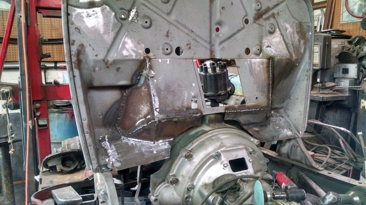

    Finally, the cut back of the firewall was not enough for the distributor. We will have to create a pocket for ease of removal and/or to replace the cap, rotor, etc ....
    This pic shows the firewall unbolted on the driver side to create the room needed to install/remove it. More pics to come on this and our other fixes ..... so much for rolling right along! Hey, but that's hot rodding - if was all easy and a piece of cake to "***emble", everyone would be doing it .....

    Not much more to update you more with but the rear pinion angle has been set. Some more pics.....
    I will bring my pumpkin next week to measure for the driveshaft ....

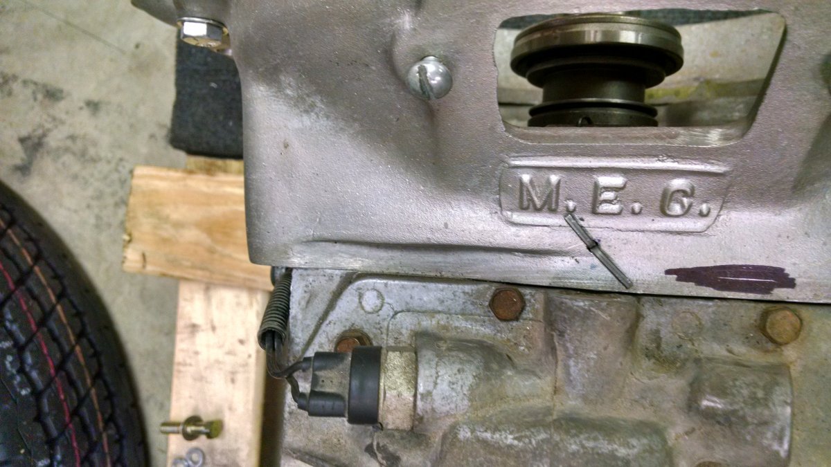

    So, builds are not without stumbling blocks and here is one for the Buick Nailhead gurus .....
    I removed the intake and lifter valley cover from my '58 364 and I think I have found out why it was put aside. First, it looks like it was rebuilt but I found a little bit of antifreeze in the lifter valley and one bent push rod ....
    So, my thinking is one of two things - it had an antifreeze leak at startup and maybe hydrolocked that one cylinder or that one pushrod was a bit too long? I checked on Rusell Martin's website and there could be a whole bunch of things that could be wrong, especially since for the engine after the fact.
    For the Nailhead gurus, I was going to get another pushrod, make sure the valve is not stuck, remove the rocker arm ***embly, make sure it is free, replace the rod, check clearances, then turn it over by hand and see what happens. One way or another I will also install new head gaskets. This is not an sbc and it has as many quirks if not more than a flathead - I am in a learning curve ....
    I will call Rusell Martin but I thought someone here might have some ideas ....
    Thanks in advance for any help you can give ....

    You have a nice build going on here, I would suggest tearing the 364 down if nothing else for peace of mine. I am taking my own advice, bought a rebuilt baby Hemi years ago an I will be tearing it apart for a look see. If you need any 364 motor, heads, etc. I have one cheap! Good luck.

    Thanks Brigrat, but man that is not what I wanted to hear, just looking for a magic pill if you know what I mean. I will keep your offer in mind, though, and I thank you .......

    Doesn't look like the intake gasket was sealed very well, that could cause antifreeze in valley. Check valve adjustment before pulling heads to see if that caused the bent push rod. If not once the heads are off you should see the smoking gun. I would try and be gentle on taking the heads off so you can inspect head gasket carefully............................................

    Updates - I removed the heads and found the intake valve was stuck and that is what caused the push rod to bend. Heads are off to my buddies machine shop to be gone over and readied for reinstallation. I will need to clean up the block a little as well ....

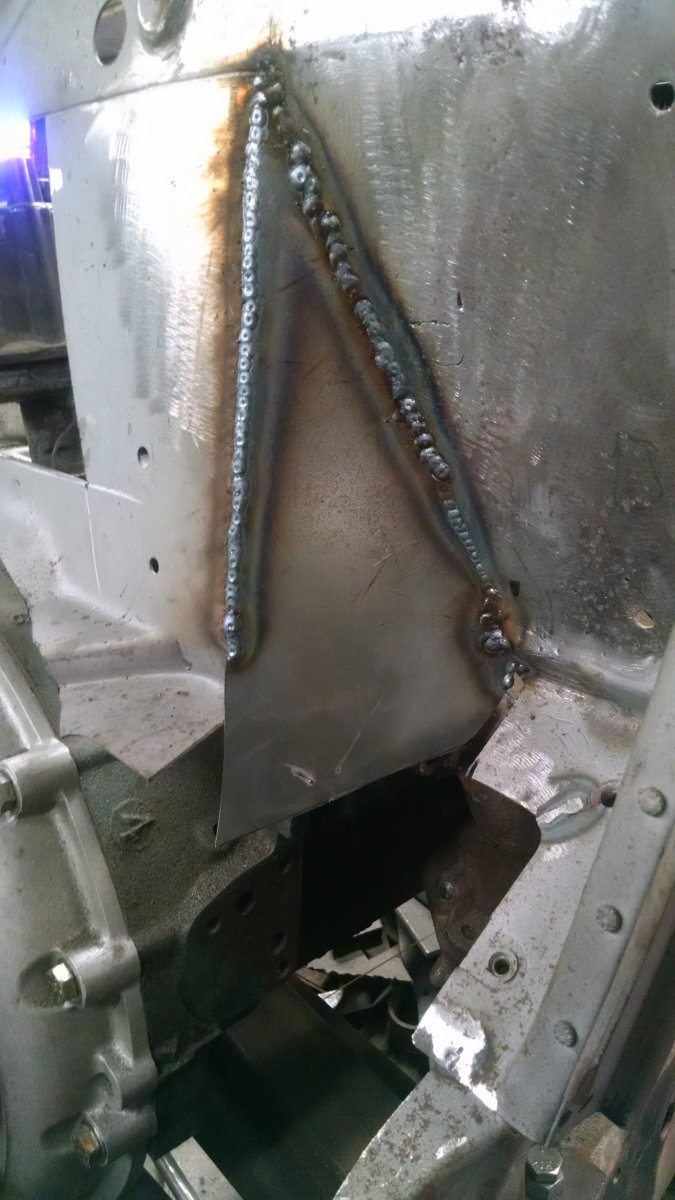

    We also worked on the pedals - in my recent post above you saw how the brake and clutch pedals are running into the adapter since the starter is on the driver side. We did some slicing and dicing to get clearance ...
    Sorry I do not have a pic of both pedals moved overf and clearing everything, we started working on the firewall on the driver side to make sure things are going to work. We need to install the starter to make sure but things are looking good ....
    You can see the pedals in the background in this pic and the firewall pieces installed are on the same plane as the stock front floorboard .... we also removed the exhaust manifold and head to m***age the firewall for clearance for both ...
    We also worked on the p***enger side and the result looks really good ....

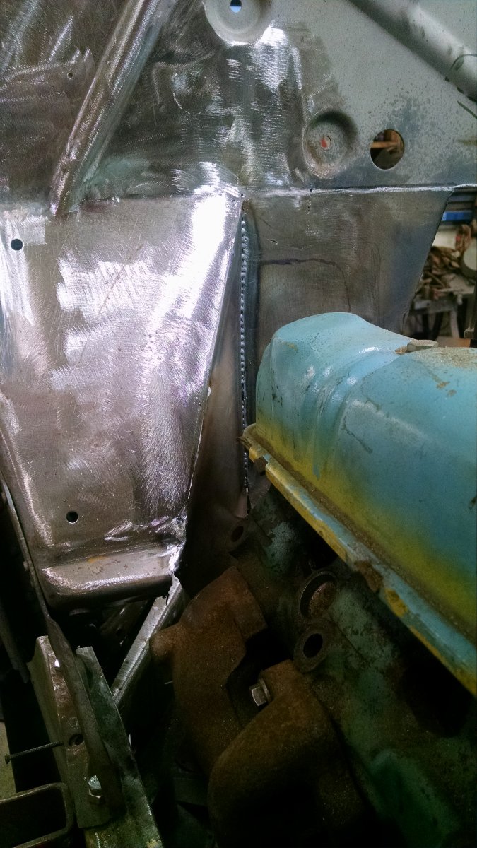

    More firewall work .... making room for distributor removal .... IMG_20161019_111417407_HDR.jpg
    The Nailhead distributor is short so if you remove the cap first there is easily enough room to slide it out .... need to clean up the welds and begin making the floor pans ...

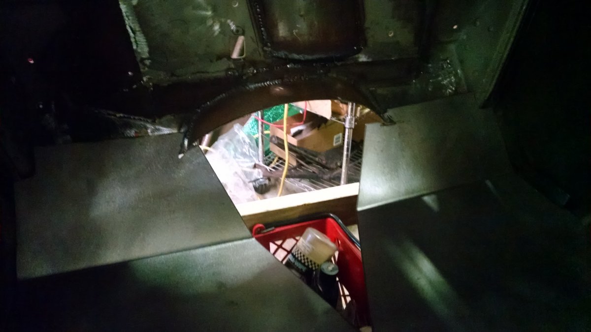

    Got the floorpan started. Jack gave me a template from which I made a paper pattern. Then Dave at House of Fab made the template into a pattern his plasma cutter machine could cut out along the lines from the pattern. Here are some pics ....
    Before starting I da'ed the metal clean so once plasma cut, I cleaned off the slag and Dave bent it in his brake matching the angle of the metal template.
    I will check the new piece against the metal template, trim off whatever needs to be done for a proper fit and place it in the car. I have left enough room to trim out the floor pan to match my engine and trans to then experiment with making a tunnel template.
    After cleaning up the firewall welds I will install both in the body and see how things look. The t******* for the tunnel will wait until I get back to the frame at Jack's ....

    Worked on the front floor pan today. Matched up the metal template with what was cut out and it needed some t******* ...
    I set it in place in the body and after a couple more cuts, the floorpan fit pretty good ....
    As you can see I put the firewall in place, more or less where it will reside, using the hood hold down bolt holes in the body to keep it in place. Although not perfect, I am liking it so far ...
    On to some paint on the floorboard and firewall cleanup ....

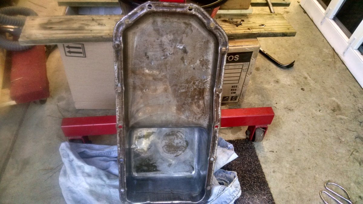

    More updates .... after a break for me to do a deck project for the wife, Jack and I worked on the rear boxing plates ....
    I also started taking the motor apart finally as well .... I dropped the pan to find this ...
    And fter cleaning it out some.....
    I then got the pans interior all spiffed up. Took out a gallon of that gloppy stuff at a minimum ...
    I also cleaned off the outside today and after pushing out a few minor dents, it will get a coat of paint. The oil pump was absolutely immersed in this stuff for probably 12 years or so and it is soaking in cleaner as I write this. I was going to rebuild it but I will give a call to Russell Martin and see what he has ready to go .... I keep chipping away ....
