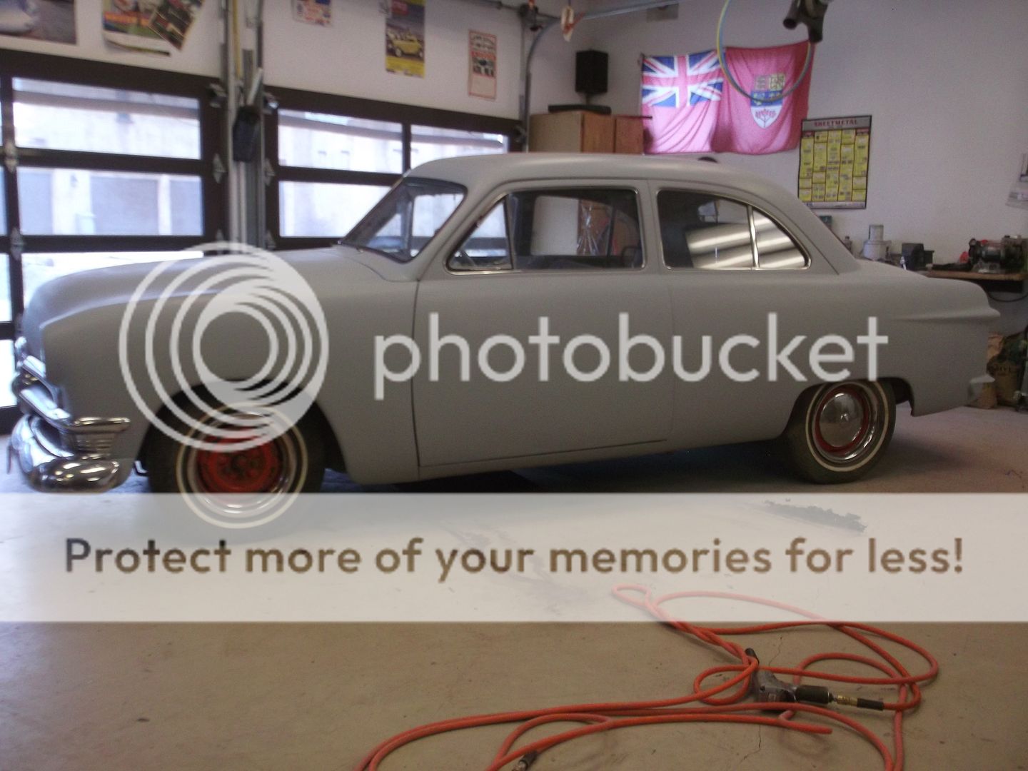

    Nose bleed no more.
    I love Aerostar coils. This is the fourth set now and they've worked nicely in all the fords.
    Taking the old coils out was an easy task. Just put a little tension on the lower A arm to compress the spring, undo the top and bottom shock nuts and removed one side of the sway bar. With the A arm unbolted, they fell out just nicely.
    Pretty easy to see the difference between stock and the Aeorstar (aka way cheaper than Jamsco) coils
    I replaced the shocks at the same time.
    The new ride height.
    Blocks in the back soon and its home.
    The only ***** of a job was trying to get the rear A arms bolted back into place. There's no room for a wrench or socket up over the cross member.
    I hope your motor is out when you do this little trick, it'll be a lot more fun.

    There's lot of slow days ahead. A lot more blocking and straightening, welding and mending. I'm turning to the electrical tomorrow. A new ignition and a little gas and we'll see if she'll fire up.
    I've had so many cars over the years, so many projects. Every one has been bought with the idea of being the keeper. All of them have been, " the one I always wanted."
    I fell in love with the first chopped shoebox I ever seen around 1975. Back then repop spotlights were the cool new piece of hard to find bling and it sold for $229.00 each - big money back in 75. To me, teh shoebox is to mercs what A's are to '32's. The ones the average guy can afford and can turn heads for 1/3 the price. Every one I see takes me back to the first black and flamed out one I seen.
    The last few years have been busy jumping from one car to the next because I love building even more than driving. I turned 50 this year and made a resolution to consume less and enjoy more.
    My plan is to build this girl, get to know her and if we're compatible, she'll be a keeper. That'll mean a chop, full interior, disks, shiny paint, the whole package. For now, baby steps and get to know her a little more.
