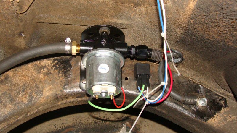

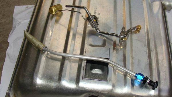

    I have gotten a bit of time the last couple of weekends to work on the 55. I did get the gears in the Dana setup and will be getting it bolted into the car soon. I had to replace to fuel tank and while doing so I added a 1/2" pickup to go along with the fuel lines for the car. I also got the battery tray and hold down made and mounted as well as the back of the car wired and plumbed.

  11. You go dblgun! What kind of fuel pump is that, and is it gonna make enough psi?
  12. dblgun
    Joined: Oct 24, 2009
    Posts: 348
    dblgun
    Ric, It's one of Carters compe***ion series and deadheads at about 8 psi. I've had good luck with them and they're much more quiet than a lot of pumps I have had. The down side is that they are not servicable so no rebuilding them.

  16. That sounds good, the last time I used a Carter like that 5.5 psi was all they had('83), and my mid 13 second Olds would run out of fuel in 2nd gear. If you need more pump later, the Mallory 140 is very quite, and you can buy rebuilt ones (which are actually better because they are fixed) from the trailer at Pomona drags for $100 cash. I usually keep one around just in case. Also if you need, I have several 6 vain mechanical pumps. I know you said probably not, but if you can, try to sneak out to Irwindale for Moon Eyes :)

    Thanks Ric, I too have a "box o pumps by Holley" and keep a couple i've gone through for spares in a pinch but damn they're LOUD! I have a Mallory 140 on my Chevelle wagon and it has given me good service also. The Dana has 4.11's in it which I am hoping will work out well with the 2.87 first gear in the trans. With a 29-30" tire it's not really enough gear for a 288-310 motor but might be ok with the 377. Camshaft selection will be important and the rollers I have now are probably too small and too big. What are your thoughts on gearing?

  24. good tip here on the pump location Dblgun, I'm ashaimed I didn't pick up on that. If you leave it high like that, it'll have problems priming, and the pump will overheat easly and fail. My car has a 3.27 first gear and 4.30's. It turns 2900 rpm @65mph with 29" tall tire, good all around set up for my 410 (4.165 x 3.750 )small block. Drag race only on mine would be 488-5.38 depending on how stout the engine was.The 377 would ultimately want 4.88-5.38's for race only and the 310 would be 5.38-5.86 for race only. A compromise on the 377 might be a 4.30-4.56 and for the 310 4.56-5.13. If you want to keep the 4.11's for more streetability, use a 3.750-3.875 crank and build a 406-420 incher. New cast steel cranks are $400ish and a ****/Eagle forging can be bought for $650ish and you could sell the 3.48 crank for $250.00 or so anyway

    Hey thanks for the heads up on the pump location, I always keep a spare with me. We rountinely use this pump series in motor mounted lift pump applications on trucks some reaching half a million miles now. It is used in conjunction with a mechanical pump so we'll see how it goes. As for the hose, I have'nt had any issues with a couple of feet of pushlock in any of my cars so far. It looks a ton better than braided and holds up to todays fuels better in my experience.
