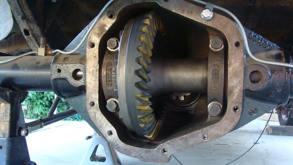

    I ended up putting more gear in the rear also..[​IMG]

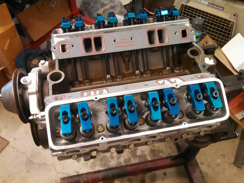

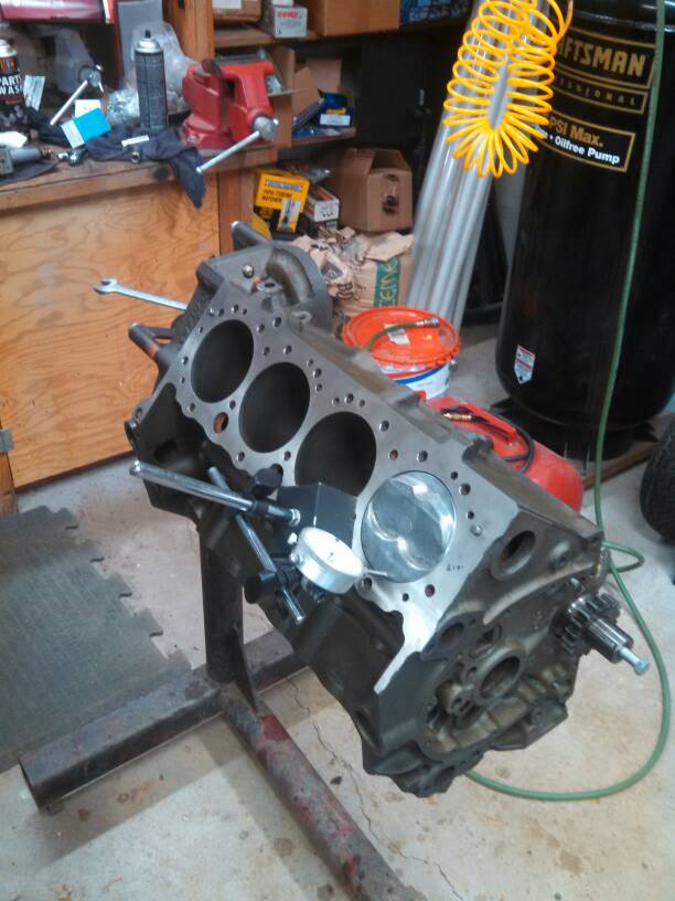

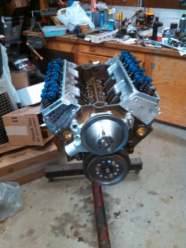

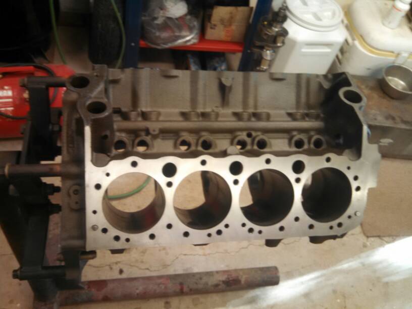

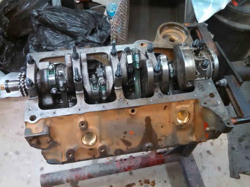

    Moving to Tucson required that I leave several of my cars in California for a while. I finally got the 55 here 18 months later which was June of this year. Never having stopped on a car for this long I had to regroup and it took a little while but I am again rolling along on the car. In the meantime I decided to put together a little 283 driver motor for the car. I started with a short block that was put together in the late 70's and was on it's way to the s****per. Although it did not have a ton of miles it had not had the easiest life and the ***embly looked to be marginal. I was able to salvage the block and TRW pistons. I added a set of NOS small journal Z28 rods and crankshaft. My pal Ric Panneton fixed me up with some obsolete rings and the short block was finished with Crower flat tappet solid cam. The block was decked and the ***embly balanced. I was able to talk Brodix into doing a set of aluminum heads with 1.94/1.600 valves and 62cc chambers so we now have a nice little 288 ci sbc. Who knew that the world would forget a time when the little Chevy was less than 4" bore and would not take 2.02 valves but it happened and now it is a ***** to find the proper pieces to put one together.

    Here are a few pics

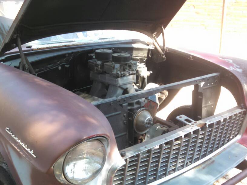

    The car arrives in Tucson
