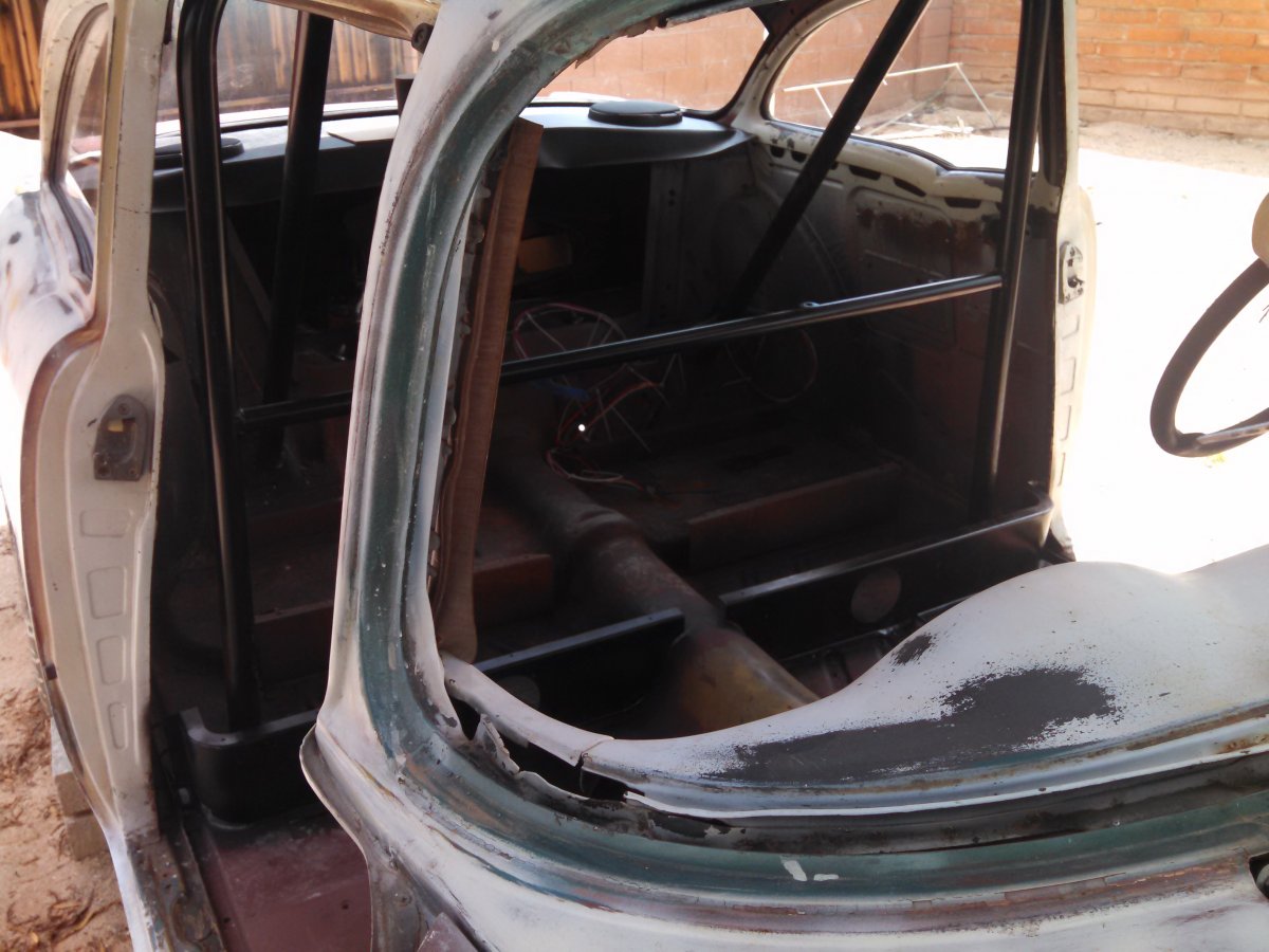

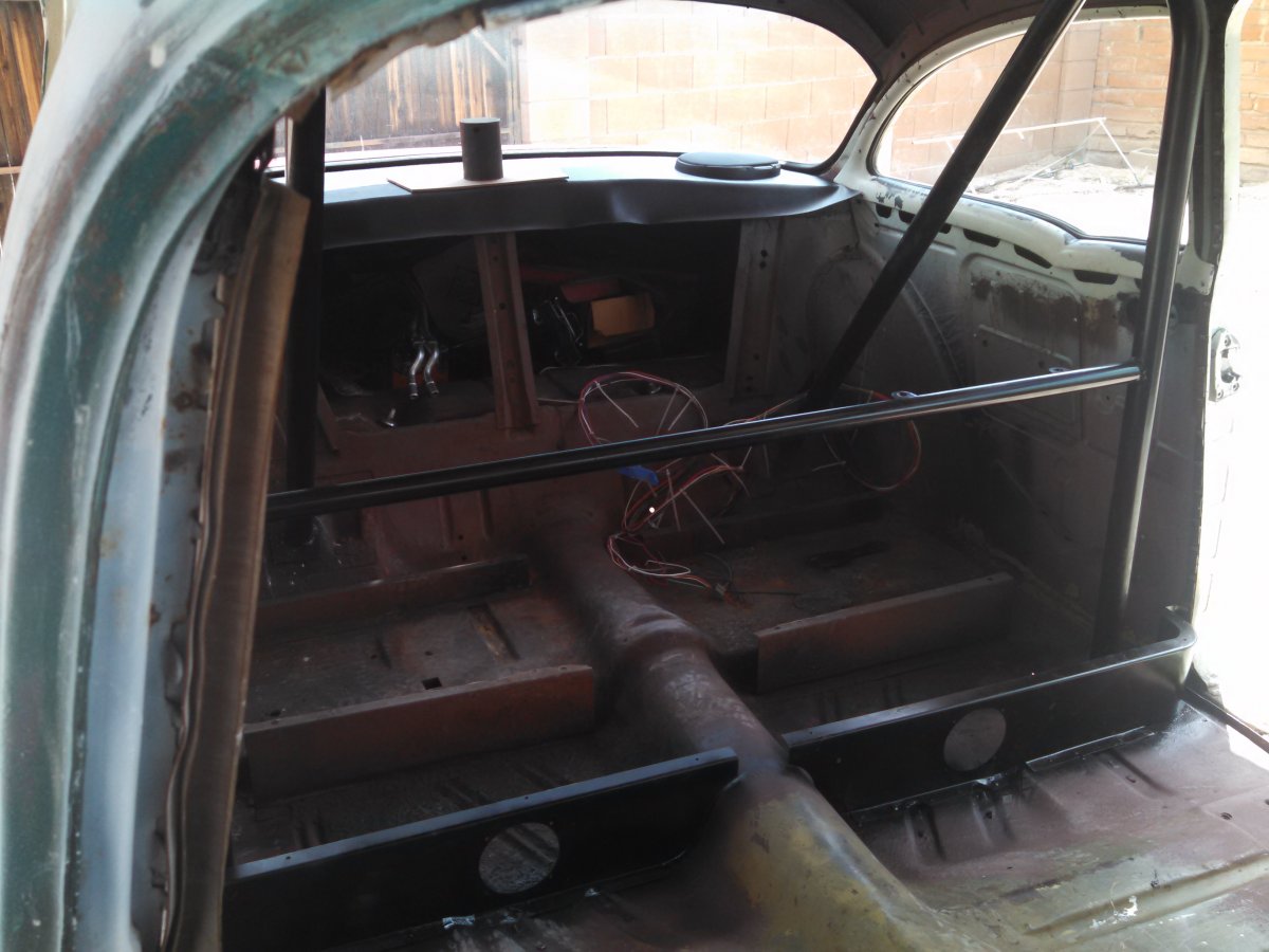

    Working on getting the rear stanchions and floor panels back in shape. Two of the forward supports needed to be replaced and I made a new panel from the remnants of of the old.

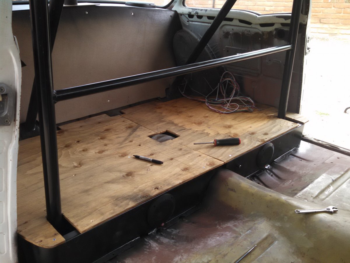

    Getting the rear package tray, seat closeout panel and shelf made and fitted. Not real ***y stuff but time consuming. Also attempted to get the windshield and back gl*** back in. The gasket for the rear gl*** was wrong and I broke the windshield getting the gasket on so the day ended with me fully pissed off.
