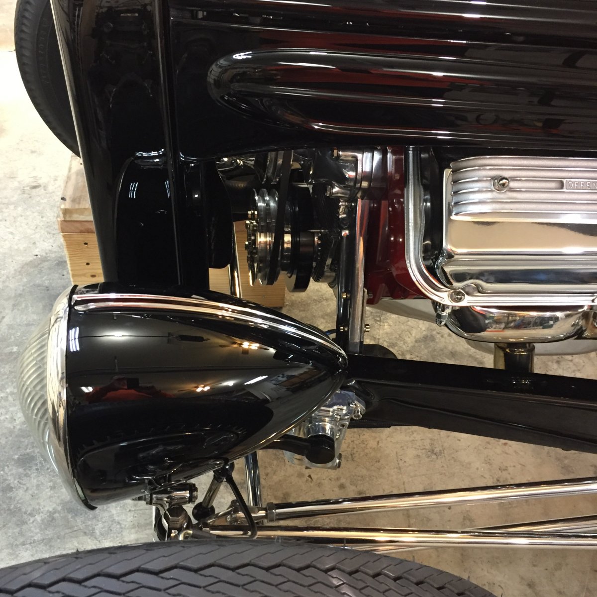

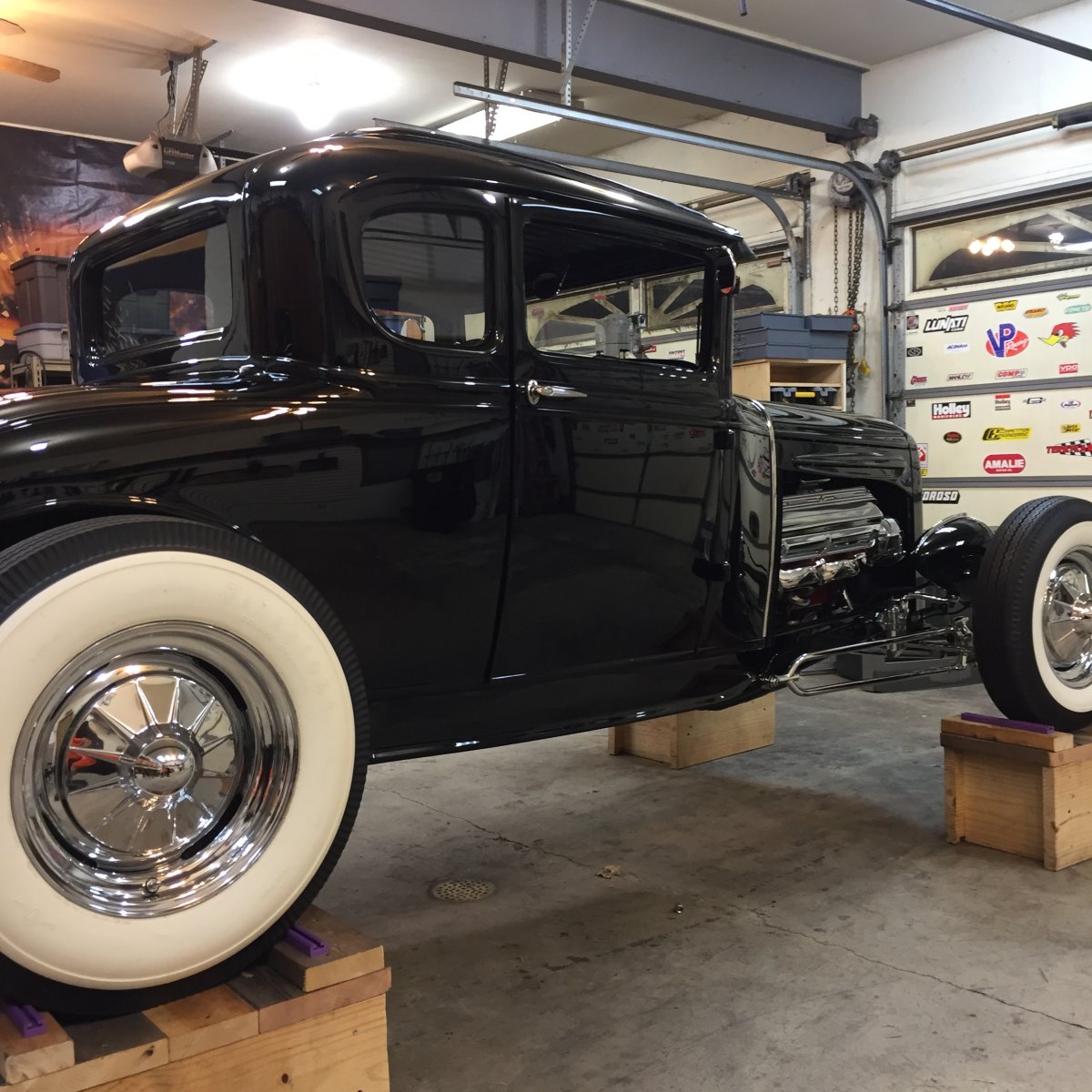

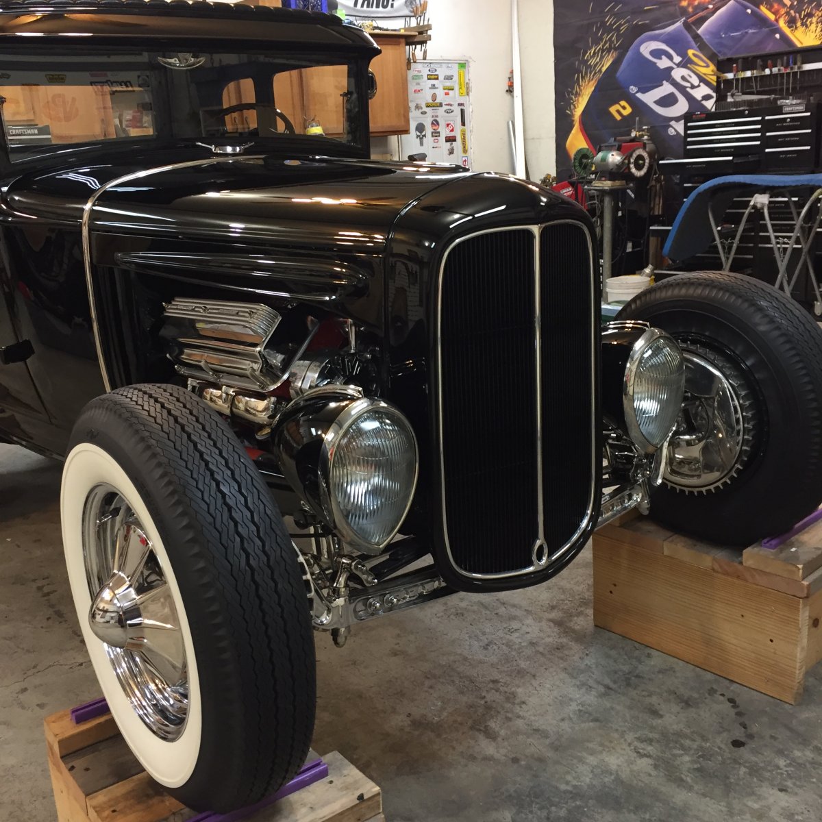

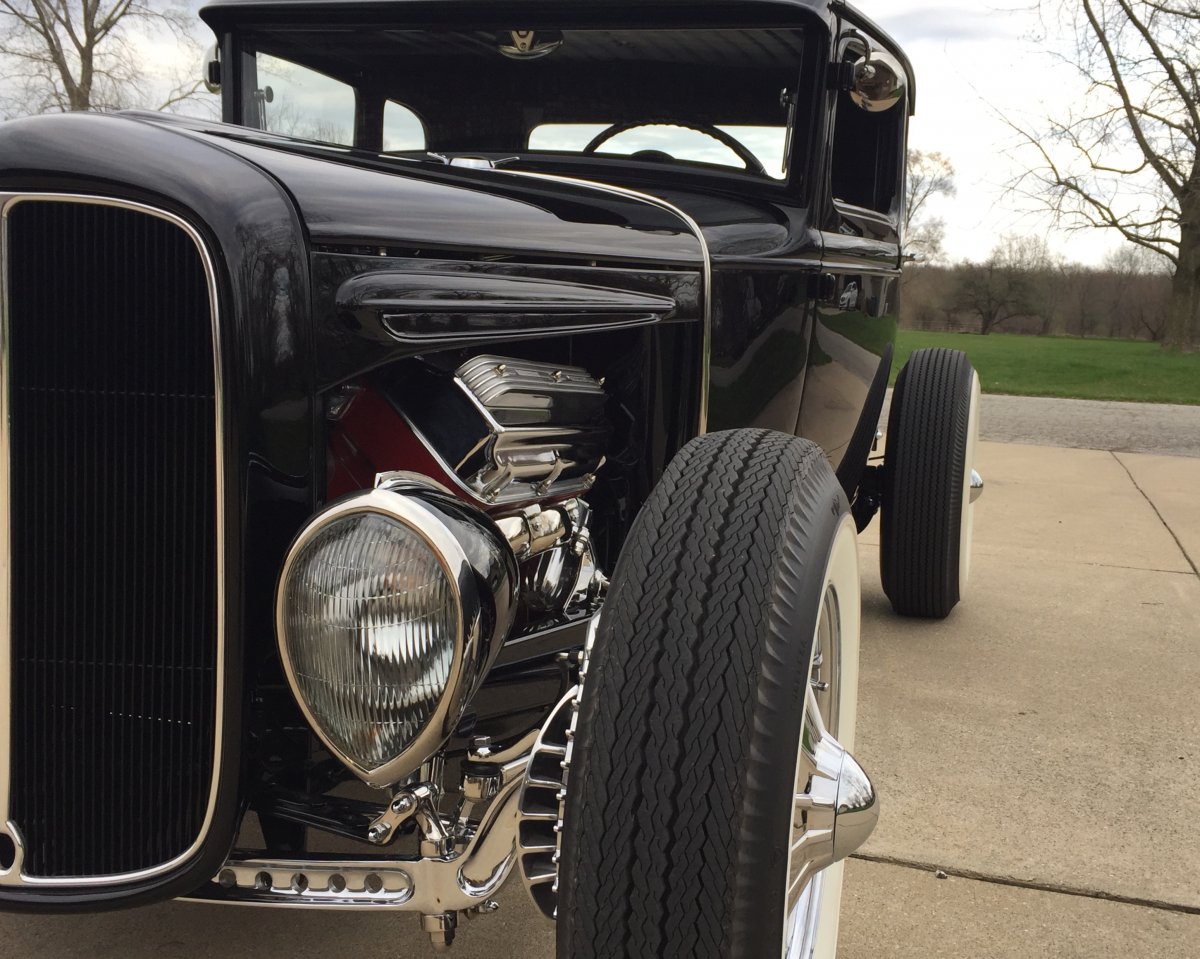

    Sneak peak at changes for 2019 season
    36 Packard/37 Ford headlights mounted
    A8EAD438-A64E-41AC-BB6C-C624FD115A3E.jpeg 173D1329-499D-4E21-ABAB-39DCD3EB2FD0.jpeg 626A9D95-0F28-4374-AC59-7EAD4FA68D55.jpeg 0DFD28F4-863C-4220-A4F6-CF03309D50FD.jpeg

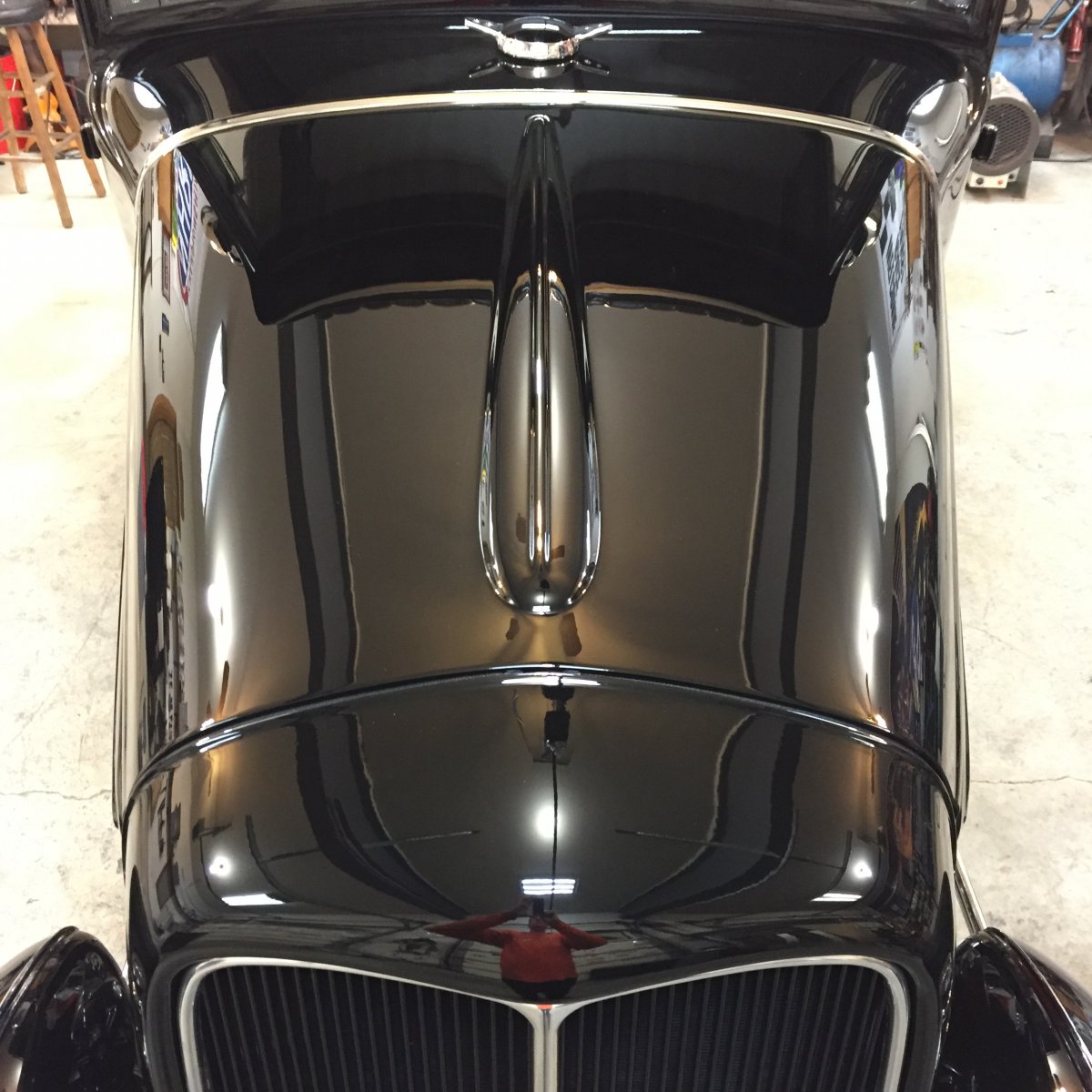

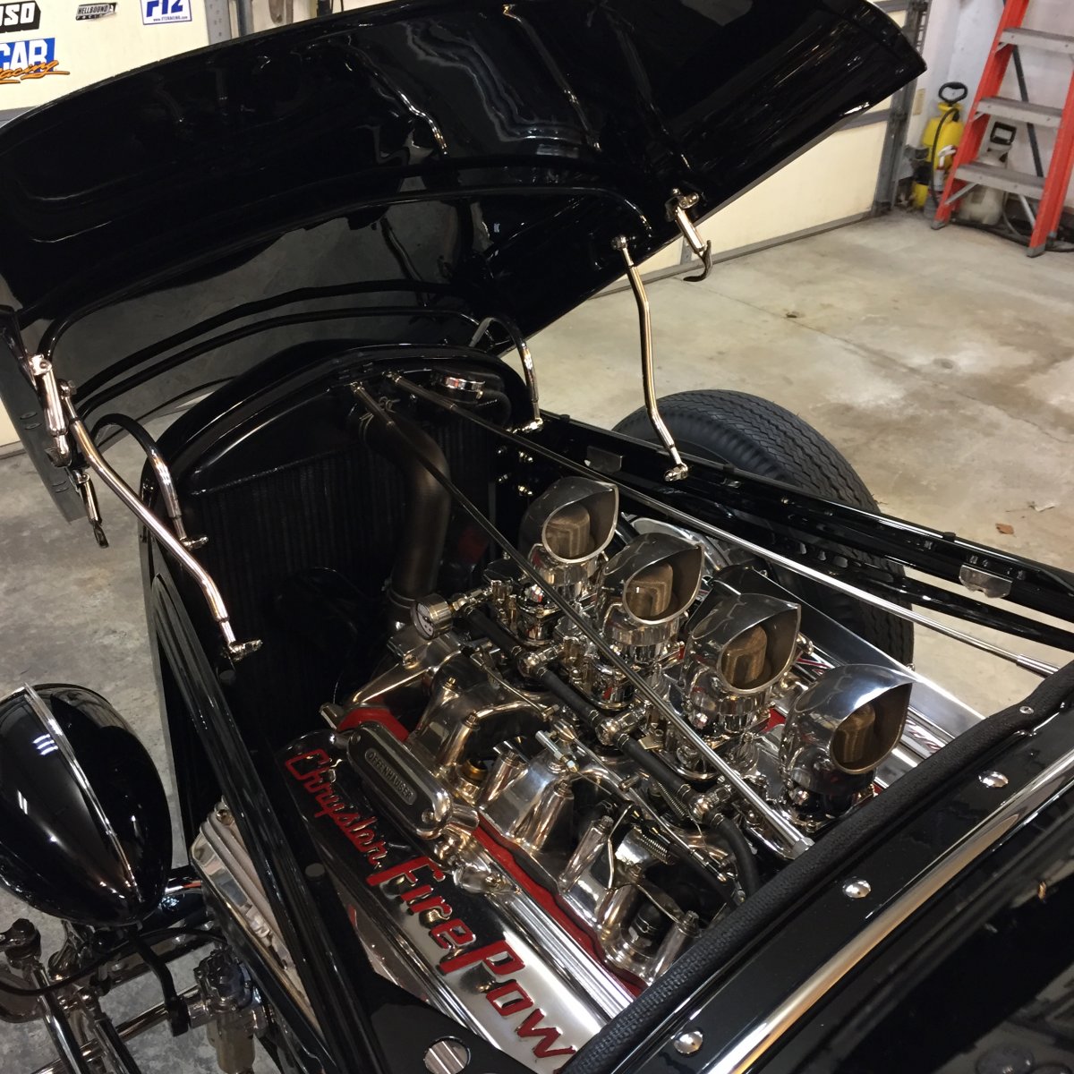

    Hood mounted with forward opening hinges
    2DE26147-4422-486F-B787-53E2BB88EF4E.jpeg A9E85BEF-D1E4-4200-9028-FD9054192B62.jpeg 655B93ED-E021-4E55-9B10-437AAD1FA777.jpeg

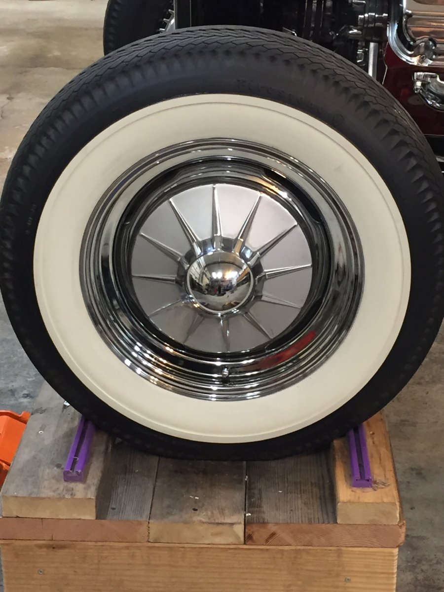

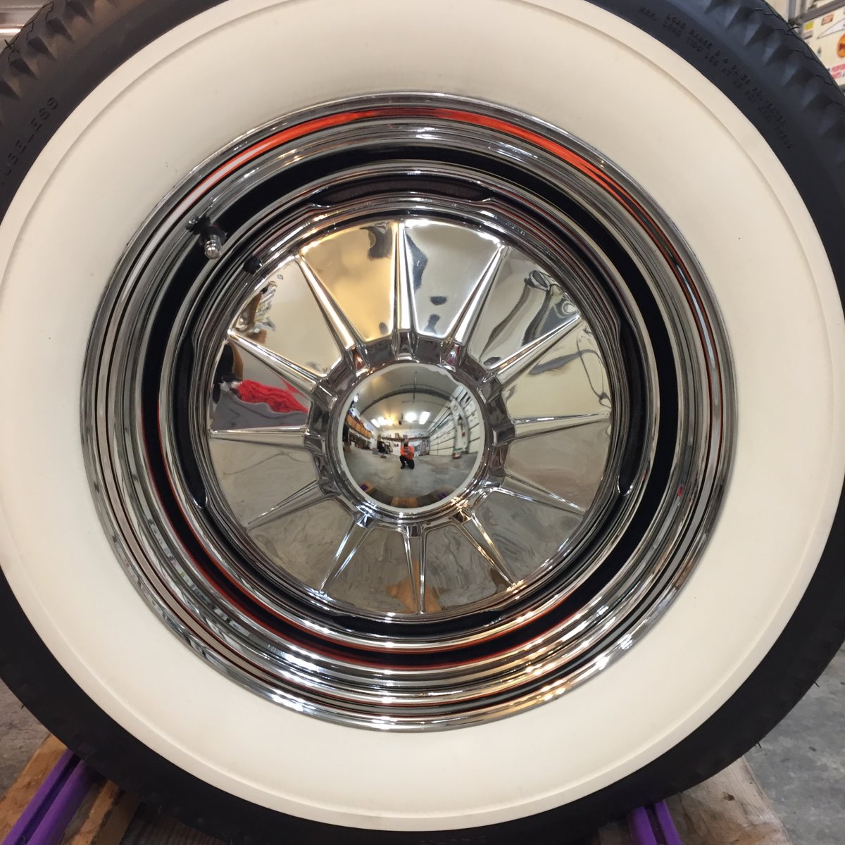

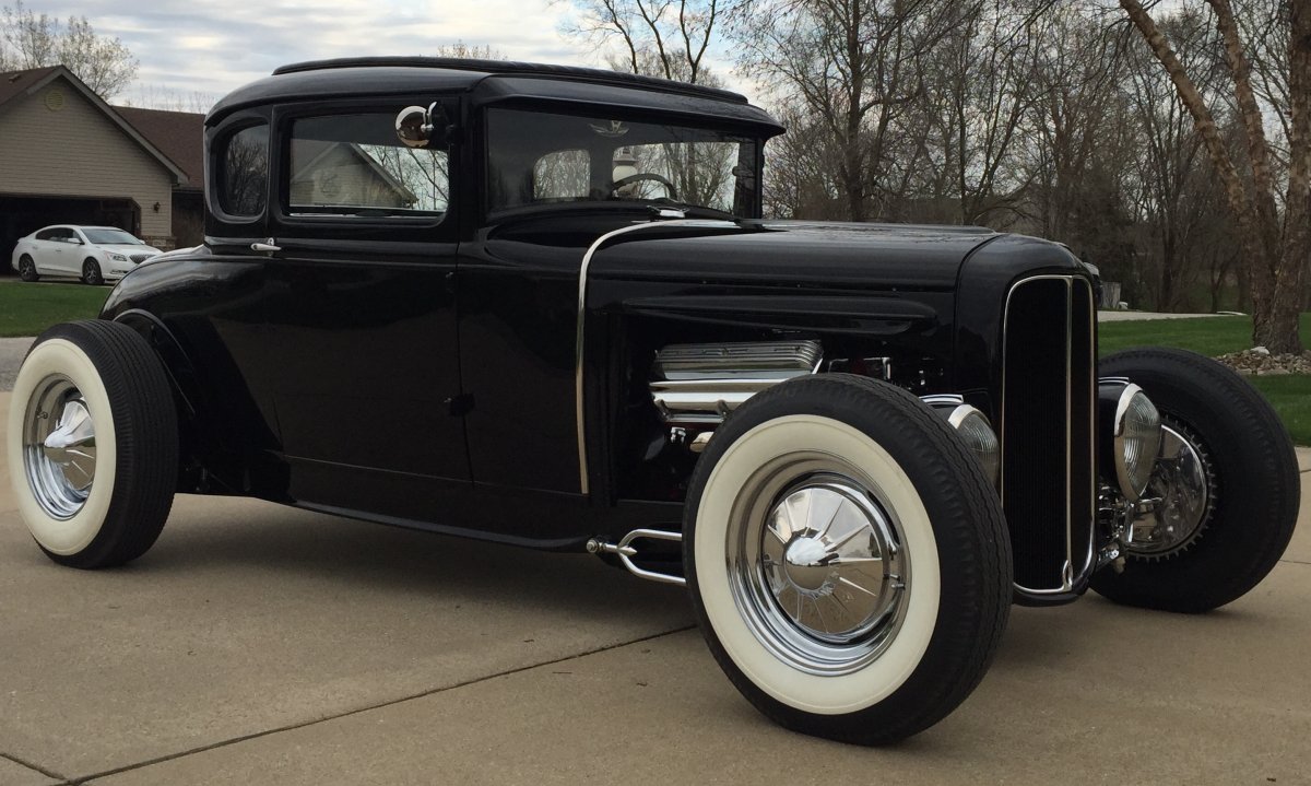

    61 Corvair hubcaps with some mods
    C170F23D-0CC2-4033-ABDB-3E4266837572.jpeg A70D7205-370E-4034-BC42-BA902E2E8A42.jpeg

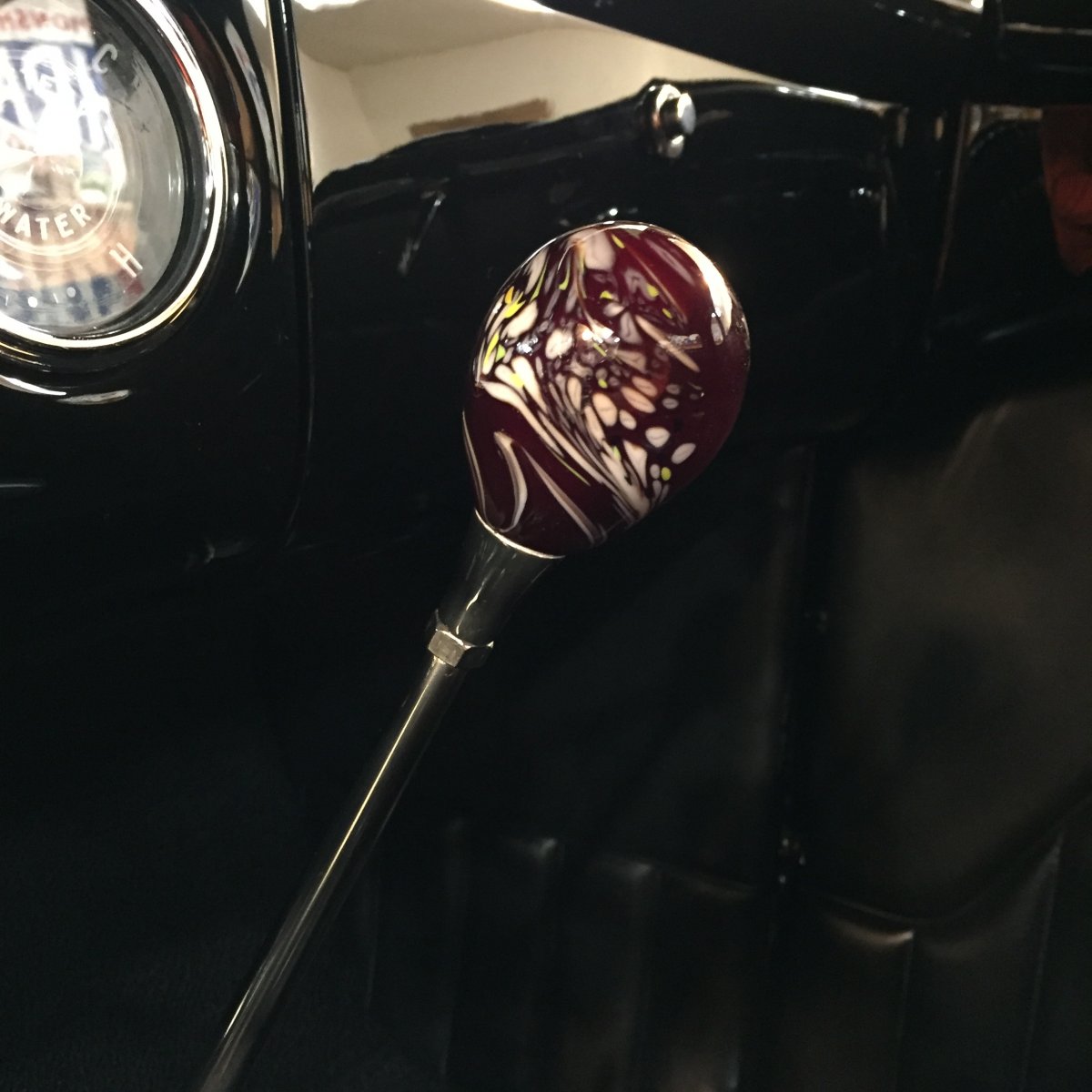

    New horn ****on and new shifter knob

    All great changes! Really like the headlights. Noticed you have something inside the carb scoops? Just a “plug” to keep the dust out when you’re not driving the car?

    Thanks, on the carb scoops those are screens in them

    I am really liking the melding of the 36 Packard/37 Ford headlights - they are really a work of art.

    That shift knob is wild! Any more info on that?

  17. what mods did you do to the hubcaps? did you chrome them? they are amazing. car looks better with them.

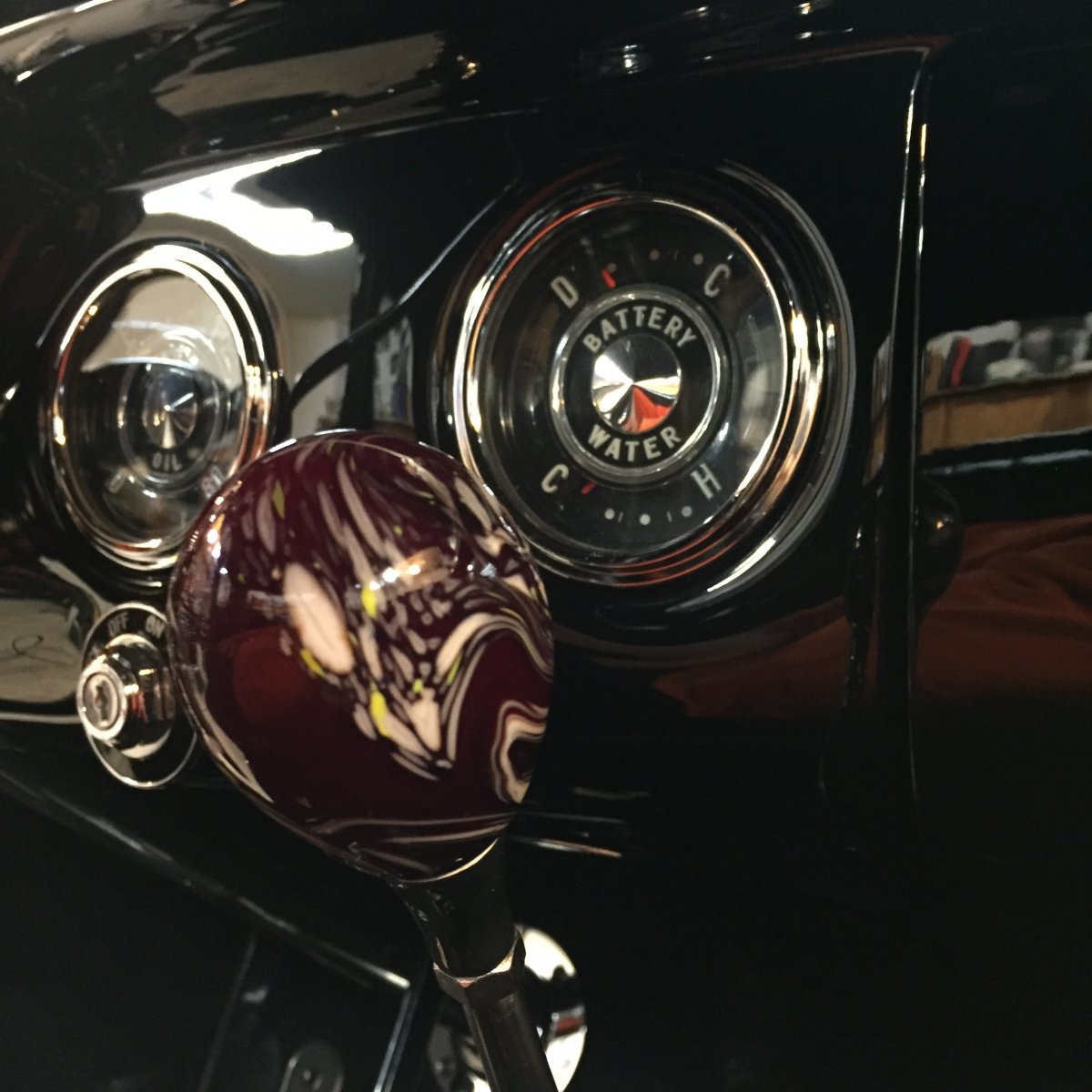

    Thanks! I struggled to find what I wanted in the typical gl*** shift knobs so got a little creative.
    I found it on eBay, it is just a decorative gl*** egg. It was unfortunately hollow but fairly thick so I filled it solid with epoxy and the custom stem I made goes all the way up to the top of the egg on the inside so there will not to stress anywhere on the gl***, the gl*** does not touch the metal stem anywhere

  20. rsss396
    Joined: Aug 30, 2009
    Posts: 130
    rsss396

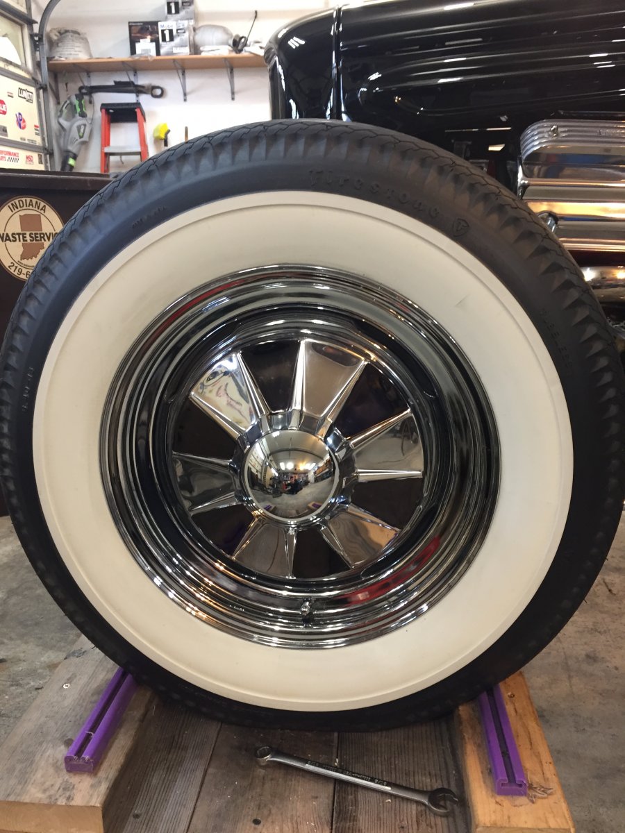

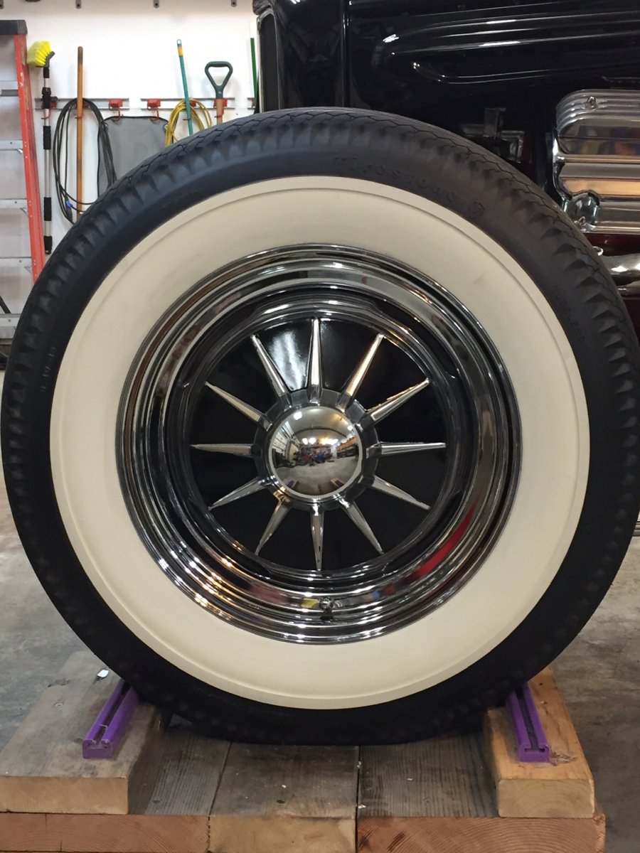

    47960A38-A0C4-4824-A269-74B2C93B3E73.png 57AE8873-AE9F-4A9A-836E-FAFFFF0AE525.jpeg 9317BAB5-952D-488C-BA64-C7B171761A54.jpeg 5D22CA4E-1FFC-4FD8-9305-455E68D02C60.jpeg
    Lots of work went into making them work haha even though they are held on with a simple 3/8 bolt
    Each wheel has a metal axle wheel hub cover that has a flange, I center drilled them and welded 3/8 nuts
    I then took laminated wood and cut it on my milling machine and rotory table ( lathe would work also) to the angle of the hub cap and to the axle hub cover. This keeps everything centered
    The hubcaps themselves get cut down to just the center section and then I polished them
    They can be done other ways using paint to accent, I have extras that I may make for spares
