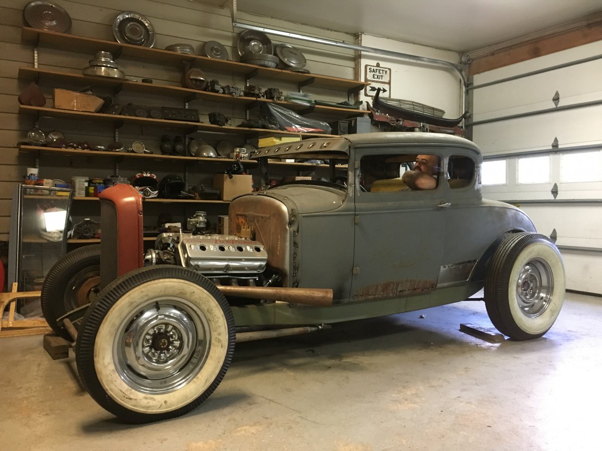

  1. Here's how it sits as of this posting...
    Decent body but the subfloor had been hacked up, so new one went in with Steadfast rear rails for the '32 frame...
    Made a threaded bung for steering box so the bolt wasn't poking through the frame...
    Model A tie rod ends for the wishbones...
    Original Model A axle that's been dropped, standard vega cross steer stuff...
    P&J shock/headlight mounts...

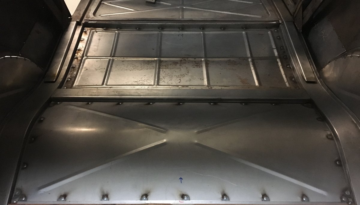

  4. Wheel well repair time...
    Wanted it to match the c-notch in the frame so went ahead and made them...
    Aftermarket tail pan was a real POS so cut the ends off and redid them so it'd actually fit. New trunk lid fit and hinged as well...
    Had to make the rear floorpan due to the Steadfast subrail kit...
    Welded flange nuts in some square tube for the fuel tank mount as getting to the backside will be about impossible once it's done...
    Then made a panel to separate the trunk area...
    Angle bent on the top. Over 48" wide so I had to make it in 2 pieces...
    It's in the hole!...
    Fuel tank mounted up...

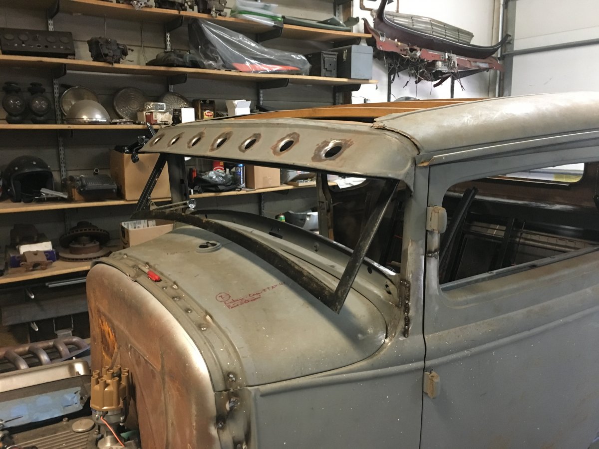

  5. Dimpled holes in the visor...
    Layout...
    Drill...
    Dimple...
    Admire hard work...
    Hacked up some 2x3 tube and welded in flange nuts for the seat mounts...

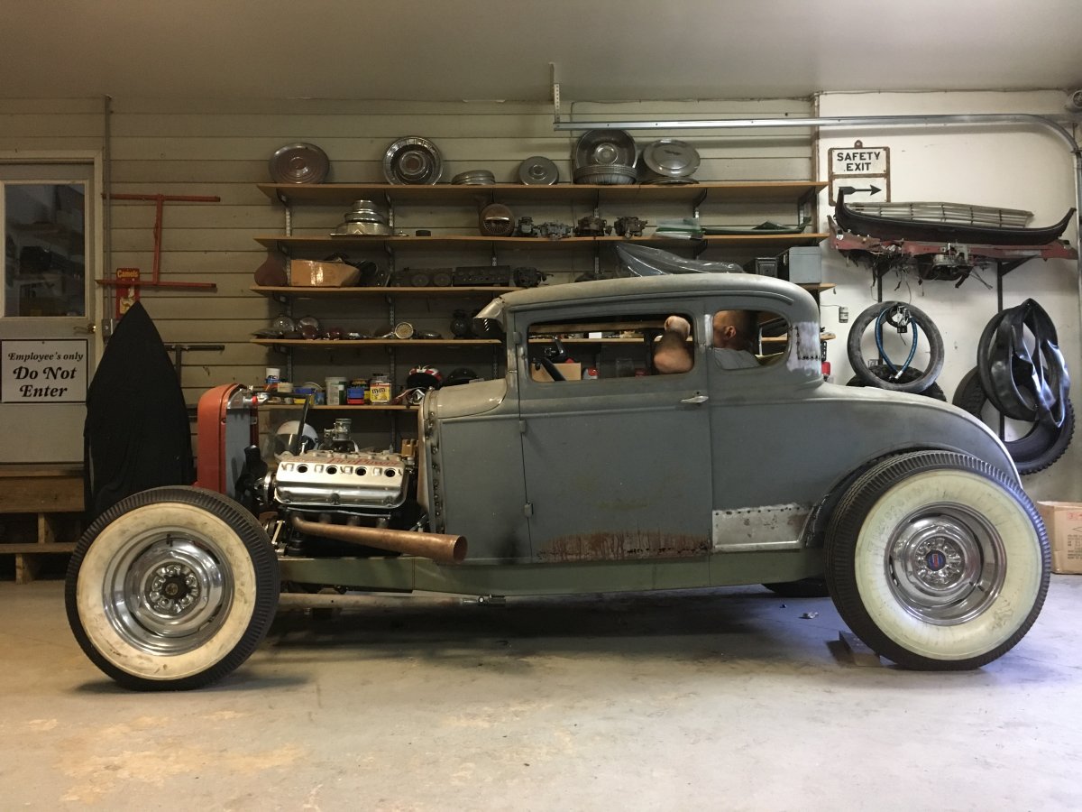

  6. That's pretty much up to date. Roof gets cut off tomorrow. Stay tuned...

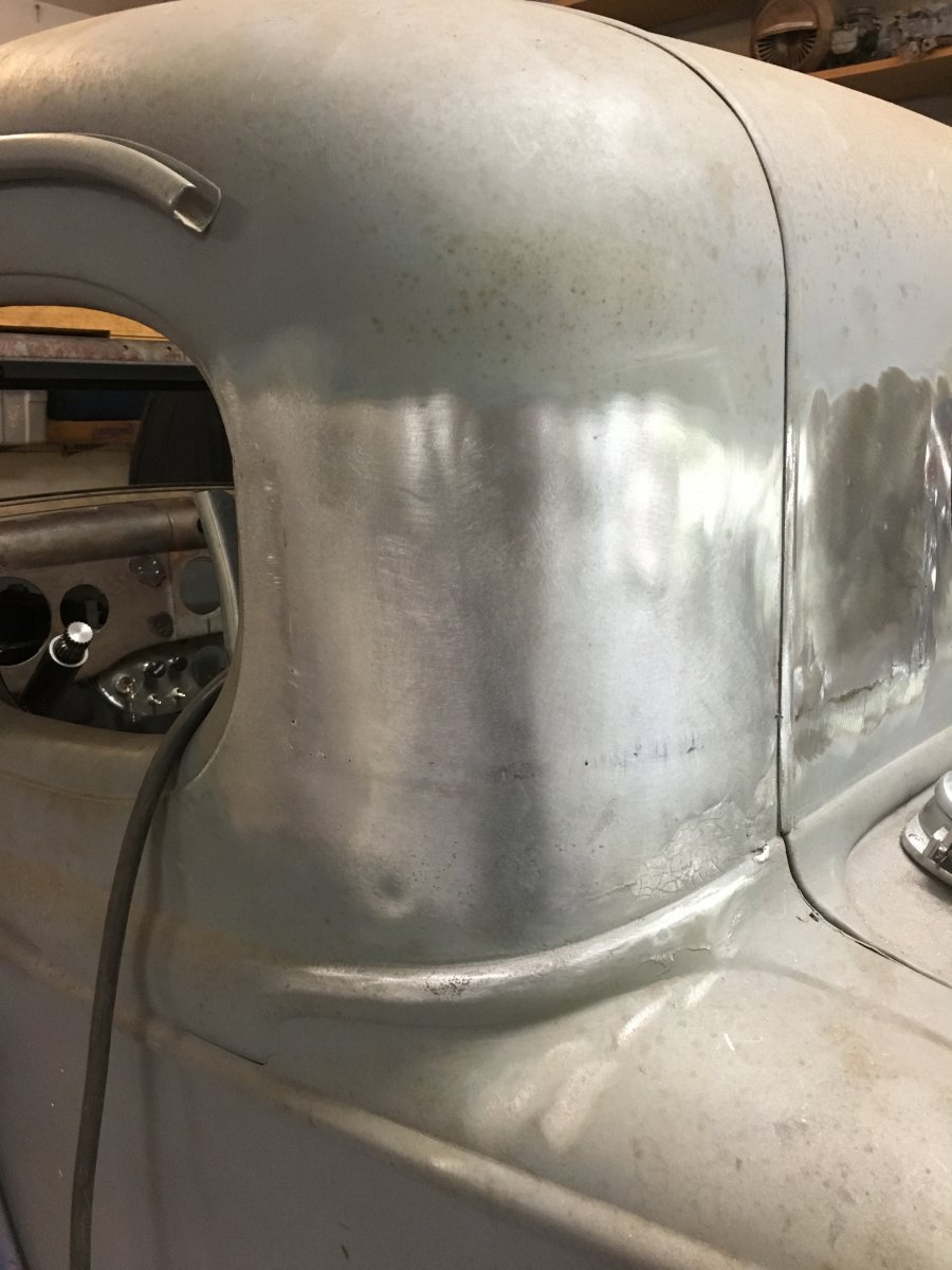

  26. Didn’t want just gauges in the lower panel. Tried to avoid the “add on” gauge panel look. Like a clean/smooth dash as well.
    Well I’m not gonna post the pics where I messed up :D
    Thanks Gary! Soda free haha. Powered by water these days believe it or not.
    Ok. Coming up!
    Yup, 36 Ford.

  28. Starting to finish up some of the chop welding. It’s gonna finish off pretty good.
    Chopped the windshield frame down. Gonna have to move the pivot points due to the upward curved ends in dash. Cost of looking cool :D
