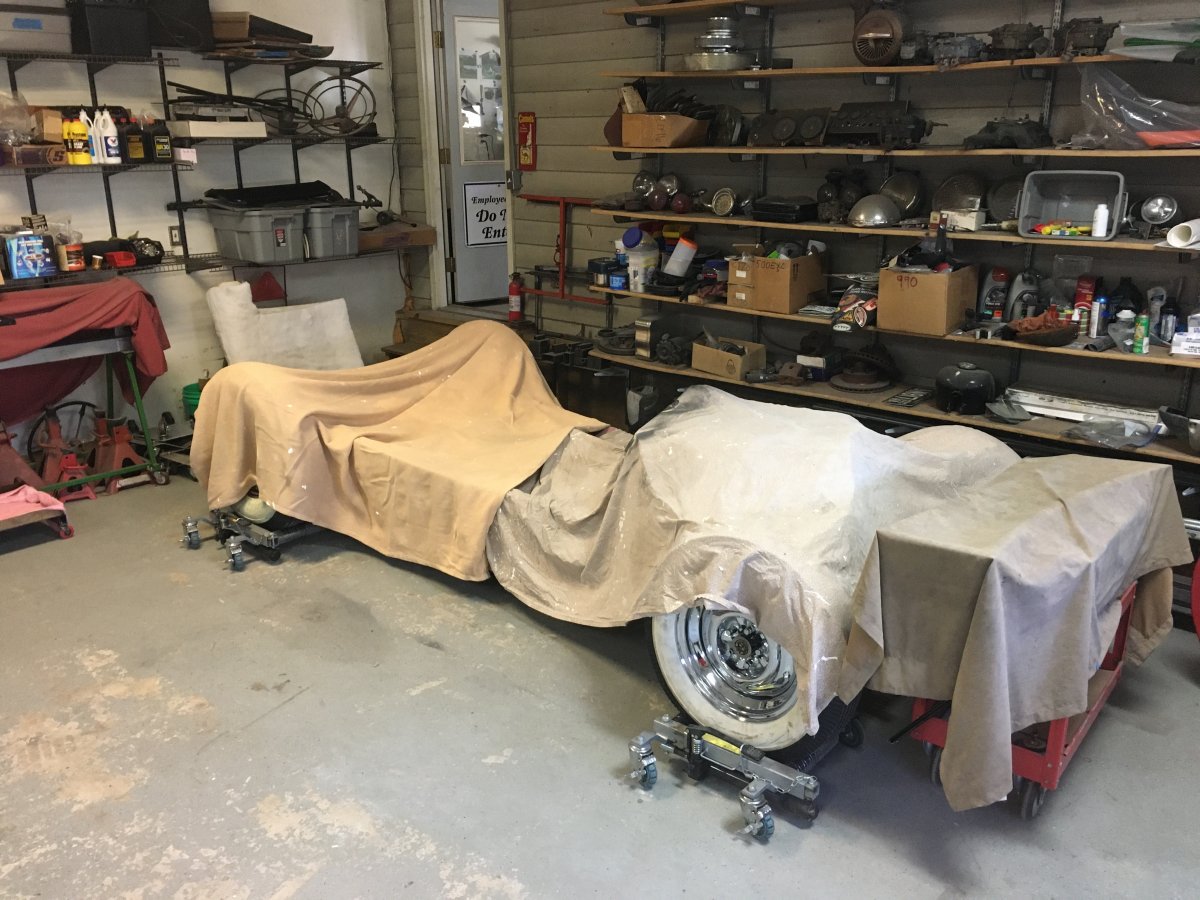

    The poor ch***is sits covered up and shoved off into the corner of the shop. Body is still at the painter. It’s gotten some dents and dings hammered out and been sandblasted.
    I’m off to Bonneville Speedweek real soon to work pit crew on the 640 XO/PP Virginia HAMB Special. Taking some time to travel around the West after that. I’ve got a ‘53 Mercury to finish when I get back. Once that’s done, I’ll go pick up the coupe body and paint it myself if not finished.

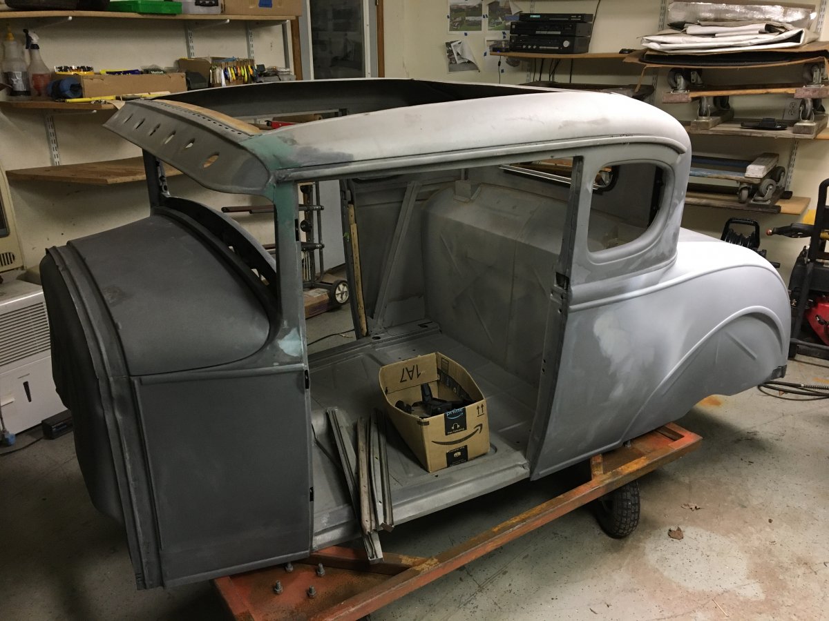

    Got the body back from the paint shop today with the help of @D-Russ and @Scott_Rod Thanks guys!
    Looking forward to getting started on the bodywork and paint. Can’t wait to see this thing on the road!

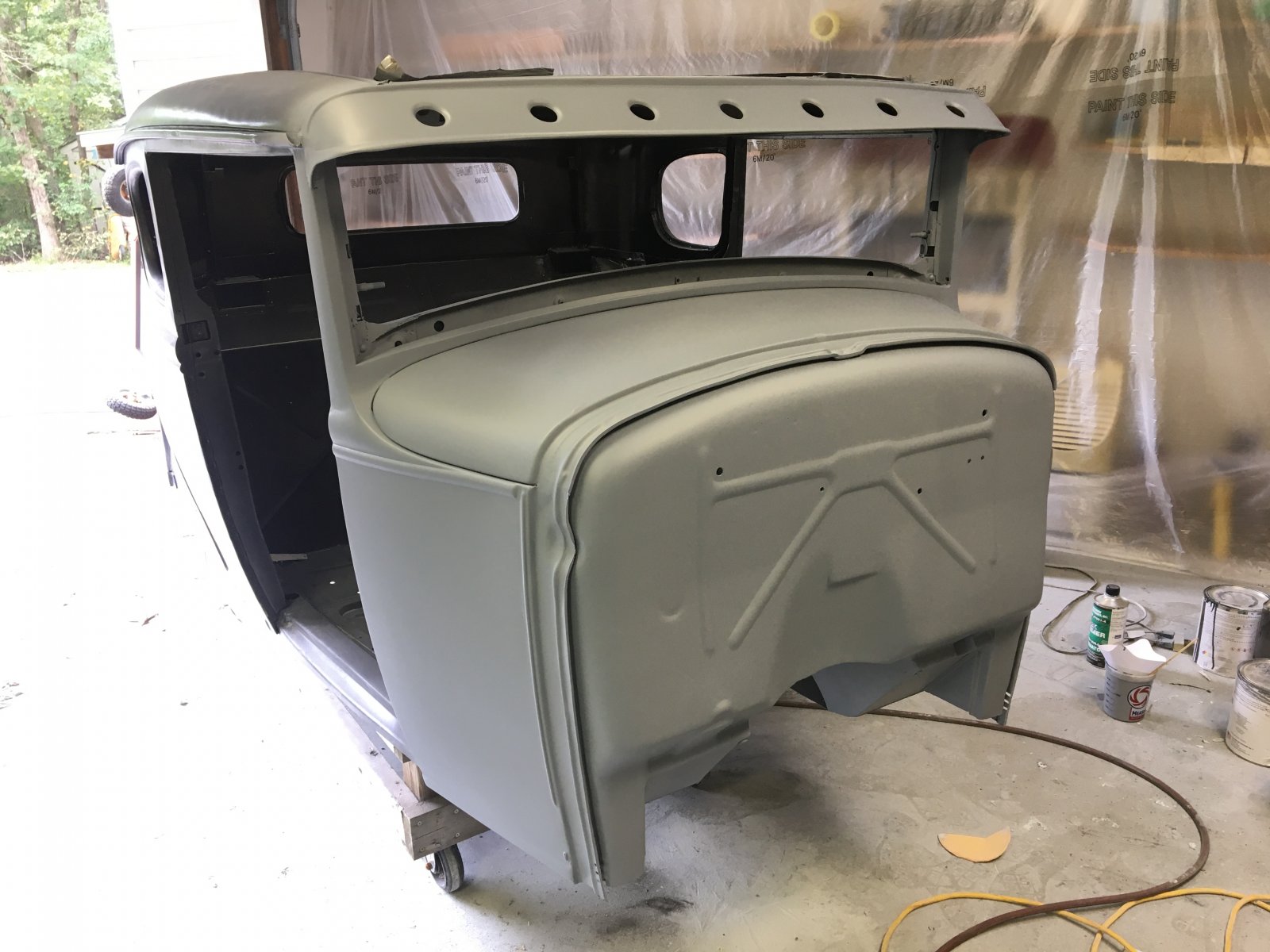

    Alright alright alright! Outside of the body has been re-sandblasted and epoxy primed. Any progress is progress, it’ll get done sooner or later...

    Long time coming but worth the wait. So, what color is that exactly ?? Looks great, soon it will all be in one piece. :);)

    Can’t wait to see it on the road. Gonna be a nice one! Body is going to be same as the frame. Ford lead foot gray.
