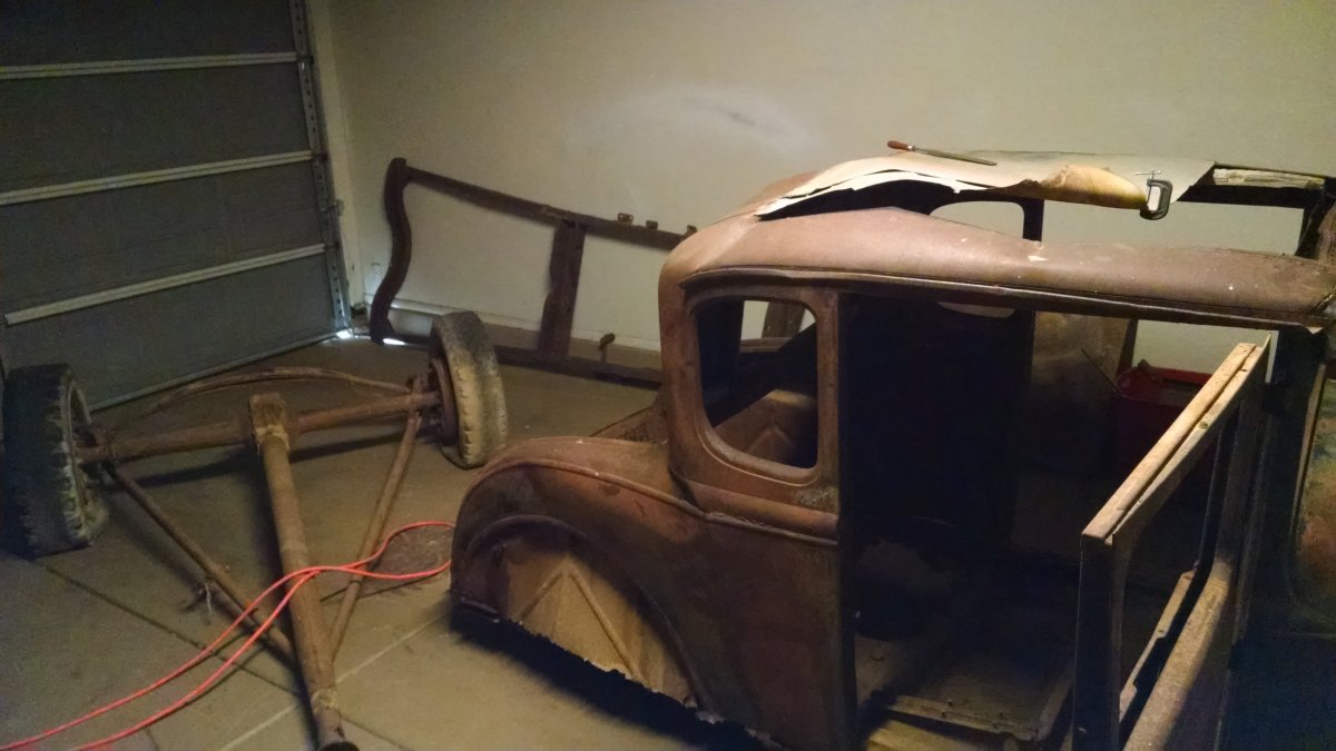

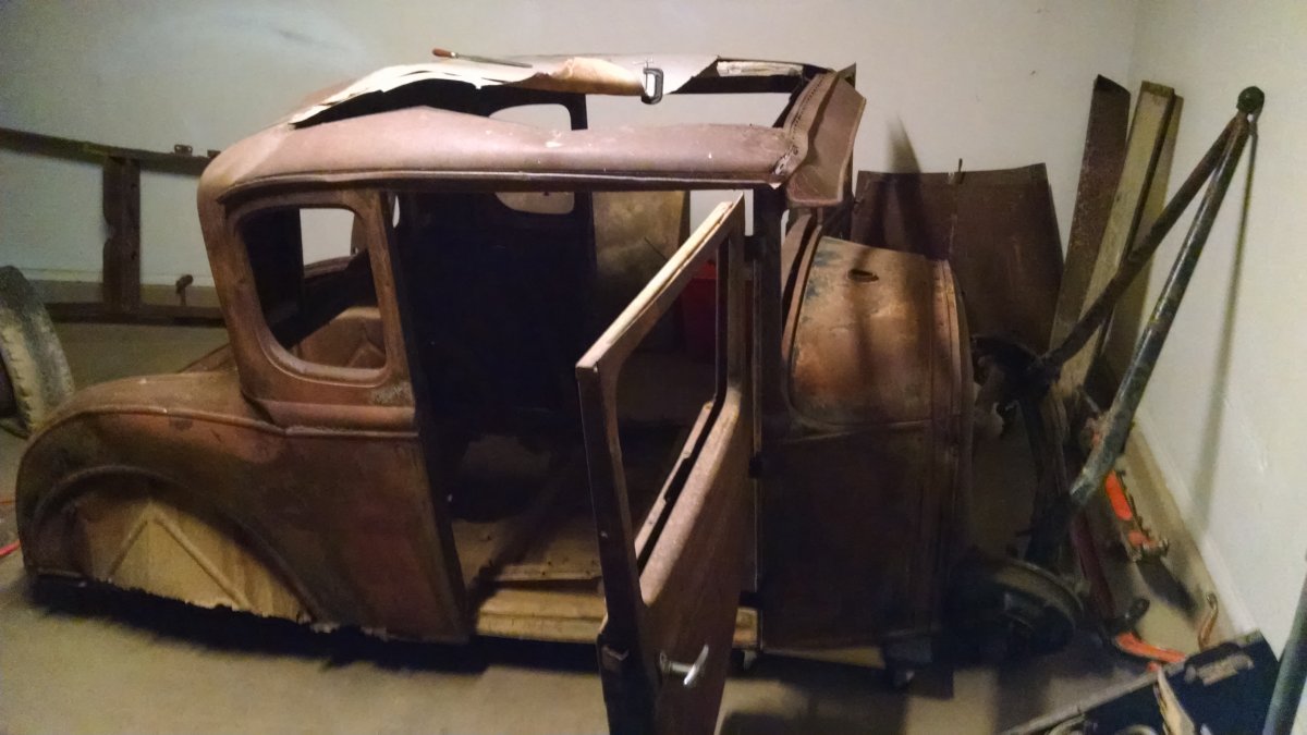

    My father collected pieces to build a Model A hot rod for about 25 years. He p***ed away in 2008 without having fulfilled the dream. I collected all the pieces and started the process of building the Model A hot rod that he would have wanted to build about two years ago.
    The body is a 31 I believe and it was pretty rough in the beginning. It was crushed slightly on the p***engers side, the doors wouldn't close, and it had about 100 lbs. of dirt inside, lol! Furthermore, someone had attempted to braze some sheets of galvanized steel to the top which was an absolute nightmare to remove without causing any further damage to the top! IMG_20151223_120239728.jpg IMG_20151223_120246498.jpg

    flatford39
    There's been a lot cars here that were definately built with less than you are starting with. Good Luck.

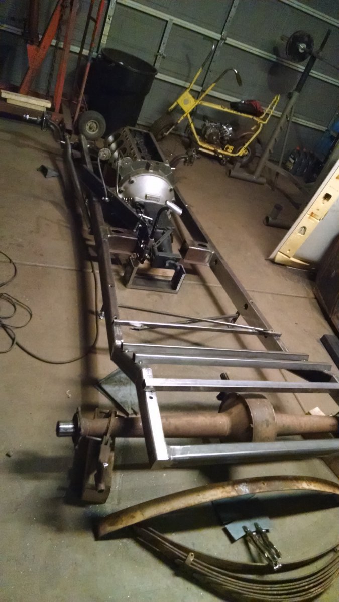

    Konan1184
    Here I started mocking up some of the pieces. The gearbox is a Muncie 3 speed from a GM pickup.

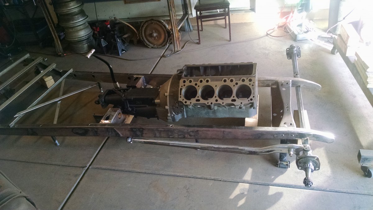

    Konan1184
    Using the old man's 401 nailhead. It's already been sent to machine shop but I found a crack in the block AFTER machining:(

    Konan1184
    More mock-up. The front axle is from so-cal. The ch***is is almost completely boxed in by this point.

    flatford39
    OK you look like you know what you are doing. Interested to see how you fix that split in the lower bead under the quarter window. That body actually looks better in these pics than your initial pics.

    Konan1184
    Well I thought it would be cool to flip the spring mounts so that they are on top of the axle tubes instead of underneath. I'll fab up some latter bars like the ones that so cal makes. Photos to come...

    Konan1184
    Oh man. That is probably the toughest thing that I am up against as far as the body is concerned. The p***enger side is even worse! I think I am going to have to find some patch panels for both sides.

    modelamotorhead
    Usually a machine shop will suggest that you magneflux an old block and give you a call before proceeding with any machine work on a cracked block. Sorry to hear about the cracked block, maybe the machine shop will suggest a cure for the crack, possibly furnace welding it.

    Konan1184
    Yeah that was a real bummer. There's a company in California called lock n s***ch that I was thinking about using. Apparently they have been fixing cast iron for decades. So what I was thinking was lock n s***ch and then a shallow pour of hard block to stiffen the block up a little. Thoughts?

    modelamotorhead
    I must be getting senile, I forgot all about Lock-N-S***ch. Good stuff and it holds tight. I've used their products to repair cracks between water p***ages and valve pockets on flat head blocks. You should be good to go with just the Lock-N-S***ch system on your nail head block.

    Konan1184
    Glad to hear that you have used them with success. I would have it baked and welded but since its been machined already it would need to be re-machined and I would really like to avoid that since I already have the rods/pistons/crank/cam, etc. ready to go.
