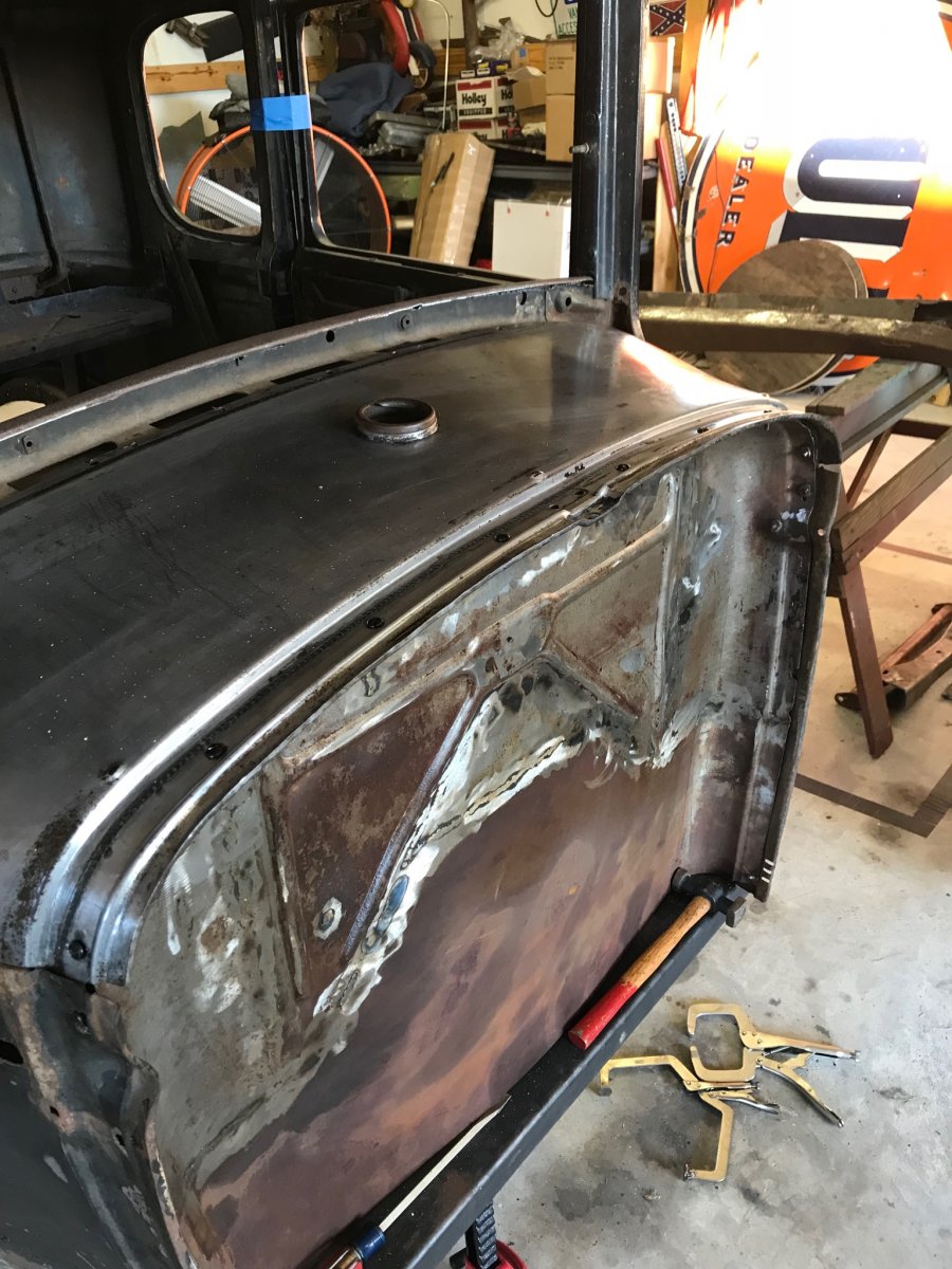

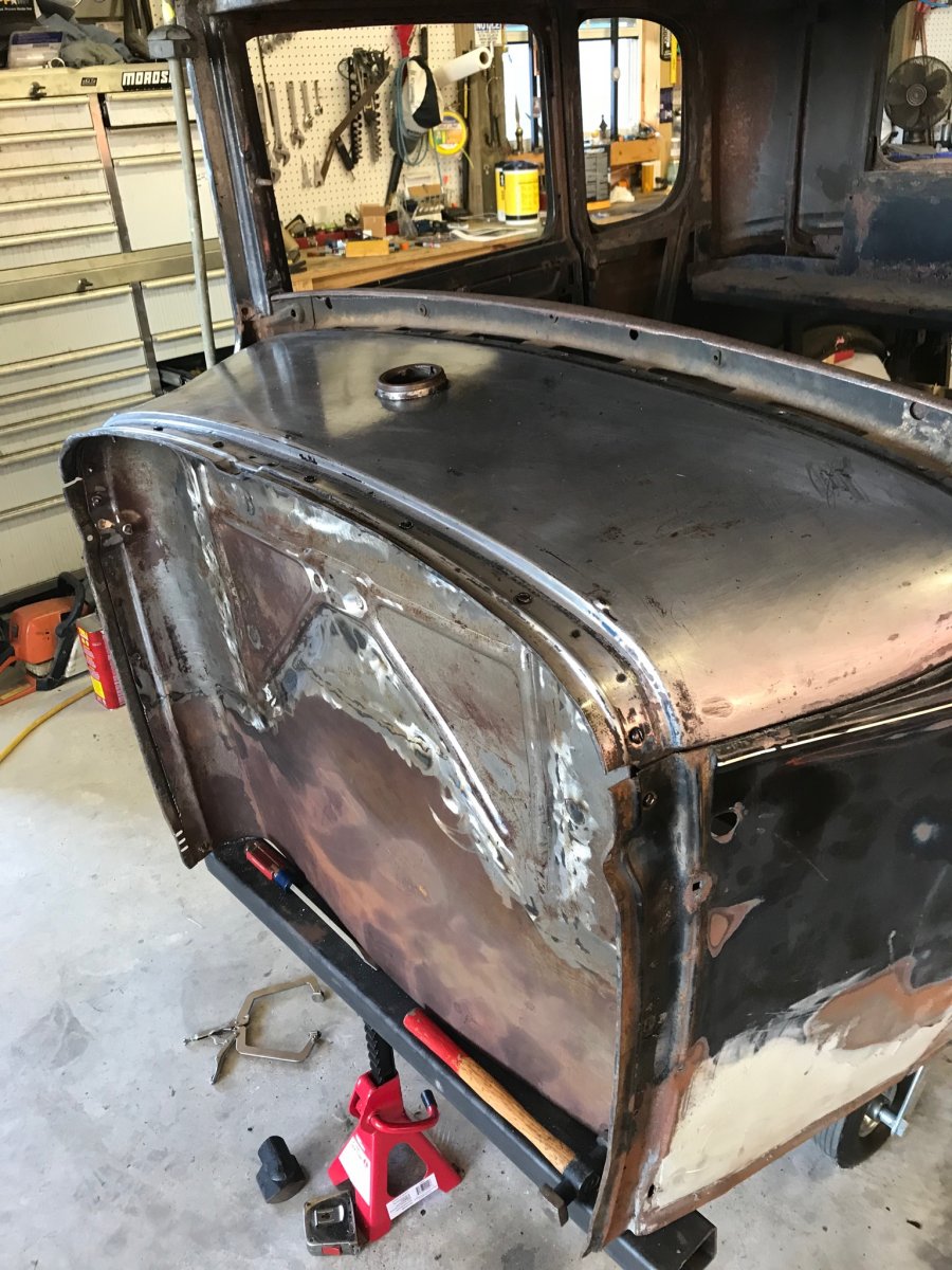

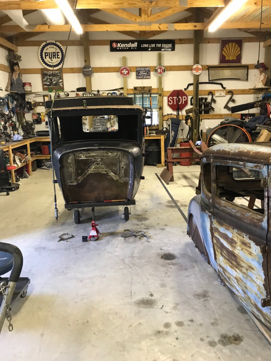

    F6AF0781-A125-433D-A7AD-A531477EF510.jpeg 22DB1E62-F748-4C67-9160-97F699EB6DC1.jpeg 532F4978-51F8-467F-8874-DACCF3E4B420.jpeg F6AF0781-A125-433D-A7AD-A531477EF510.jpeg Here’s a picture of a firewall I just flipped it’s a lot of work

    Thanks for the photos. That's exactly what I would like to do.

    Did you clean all that steal with a media blaster or did you use a grinder?

    Also, how much of the front side of the gas tank did you have to remove?

    EB8A5F7E-F2D1-4069-B998-F15BEA92A3D1.jpeg I removed 4 inches of the gas tank , I used a 36 grit 4 inch disk to remove some of the paint and to clean the the welds. Took a phishing hammer to help straighten out . Still not perfect but it will do as I’m putting a hood on this coupe. I used air craft paint stripper on the rest of the car.

    I love the look of it reversed and not having to worry about the distributor being so close and not being able to run a mechanical fan. I ll cut the tunnel in it will I fit the body to the frame.

    Great info. I think I want to attempt that as well. I want to run an HEI distributor and that distributor is about as big as they come so Ill need the room.

    Very nicely done, and I did notice you took the time the cut out the center and keep the bead work facing forward, nice work. Bob

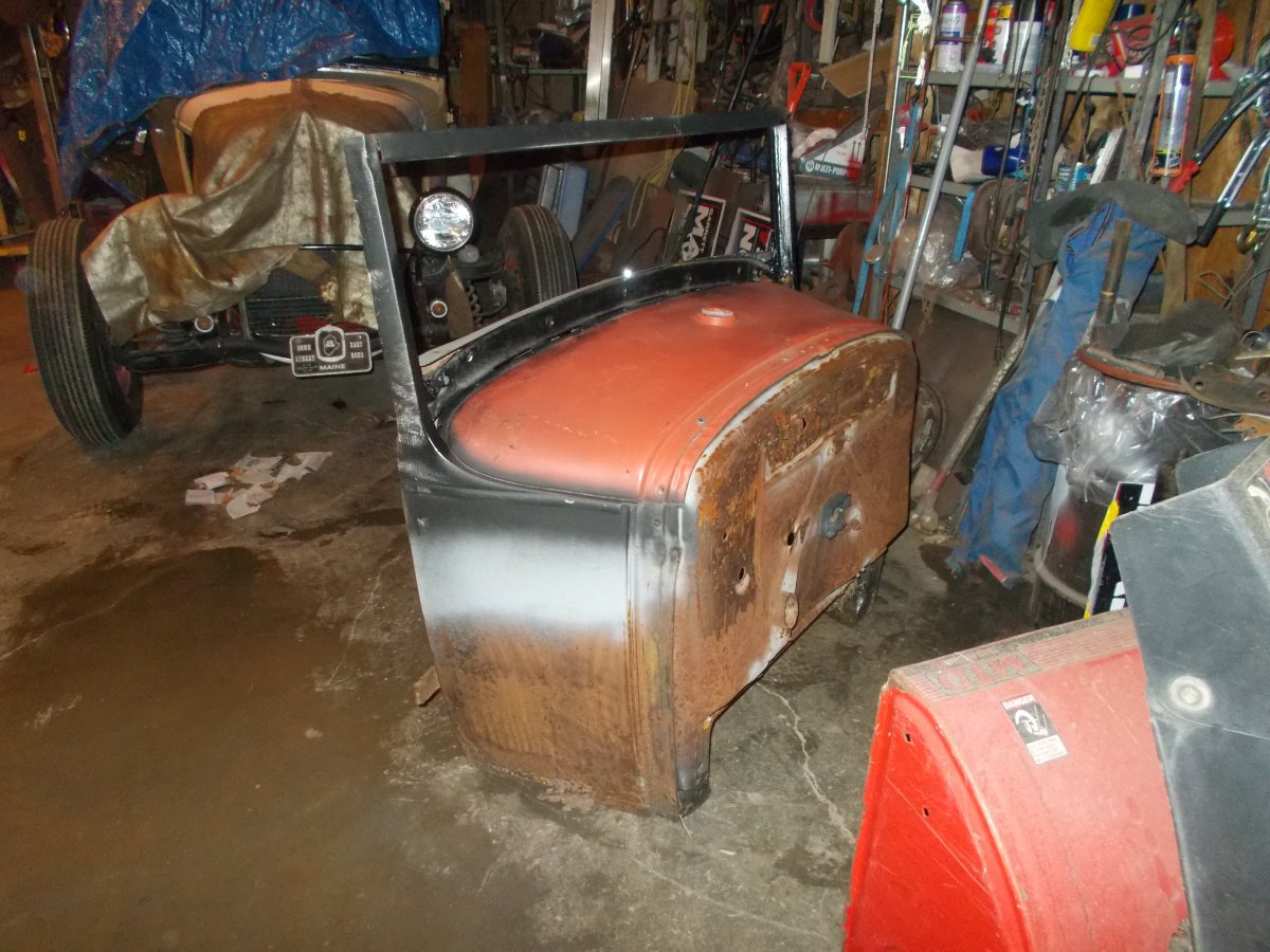

    mikie likes it... after seeing your's I am gonna reverse the firewall in my '30 coupester project...
    I may not re-reverse the beadwork... I can live with them being innies…
    that is my '30 sleeping in the back... and a rrrrrrrrrr snowblower in front...

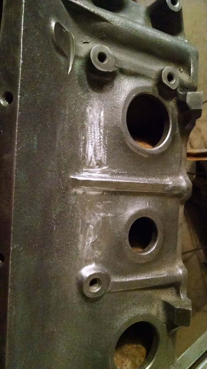

    This happened to me, don't worry, save it with loc-n-stich.
    I just got it bored, and somehow overlooked it. The machinist missed it also.... But after the repair, 8 years later, it's still good!
