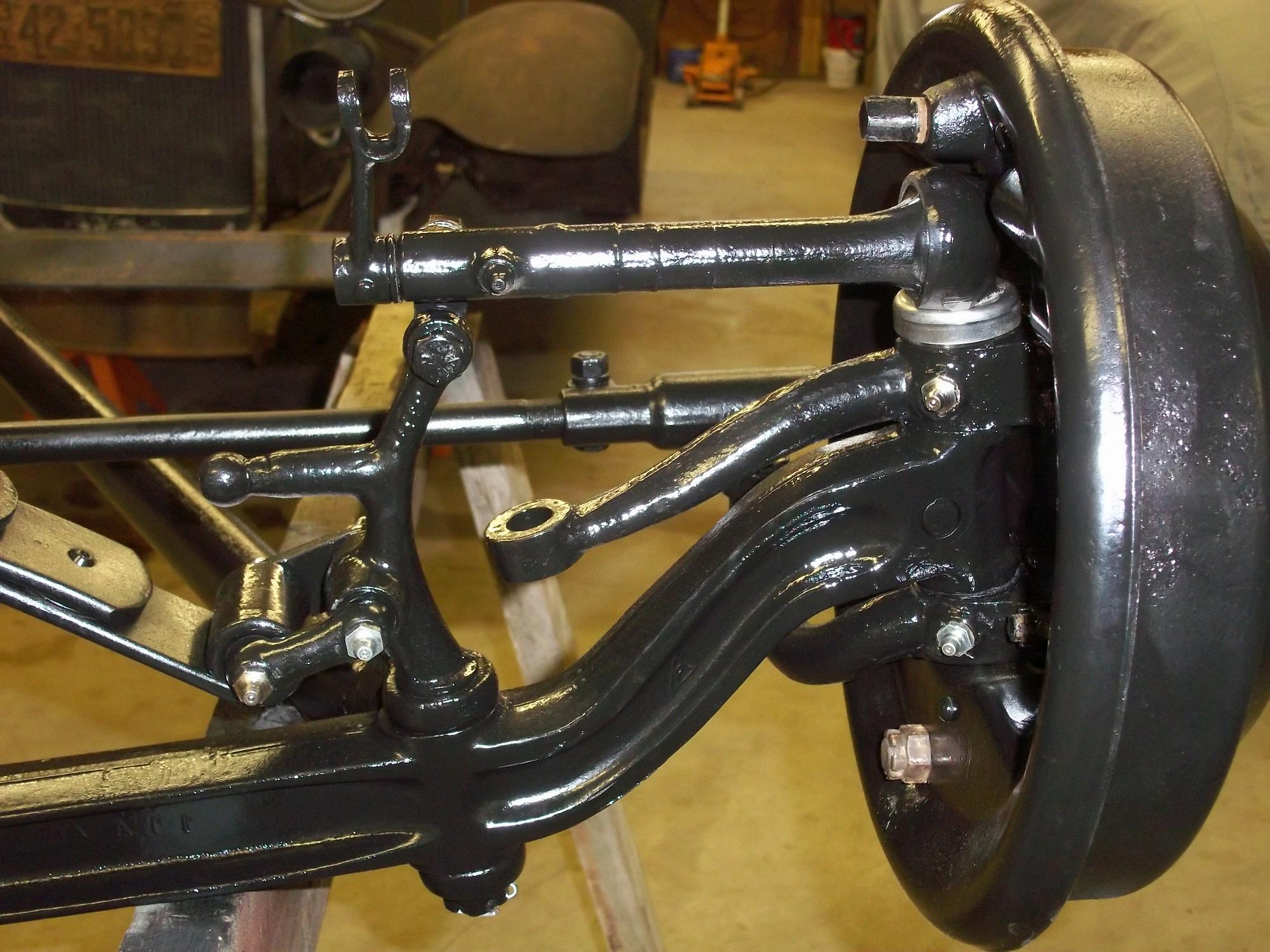

    Hello, I am doing the same setup on my '30 Coupe, including the 4" stretched, dropped axle from Okie Joe, '32 spindles, '32 spring perches (extended) and reverse eye spring. I wanted to ask So-Cal Tex if you are running the tie rod above the spindle steering arm or did you reverse it and run the tie rod below the steering arm for clearance? Thanks! - Ian
  10. Stovebolt
    Joined: May 2, 2001
    Posts: 3,629
    Stovebolt
    Here's a picture of the setup So-Cal Tex runs - as can be seen, the tie-rod runs above the steering arm, mounted from the top, which CAN be run by resizing the hole with a new taper from the top.
