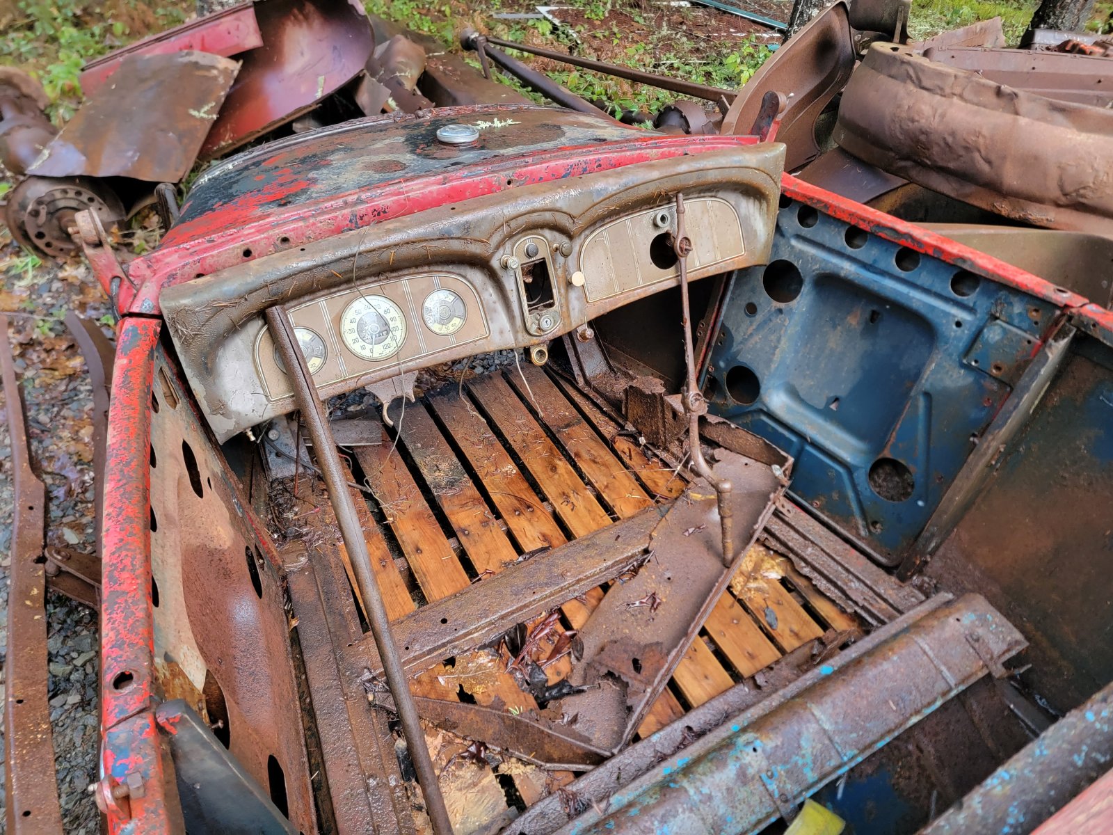

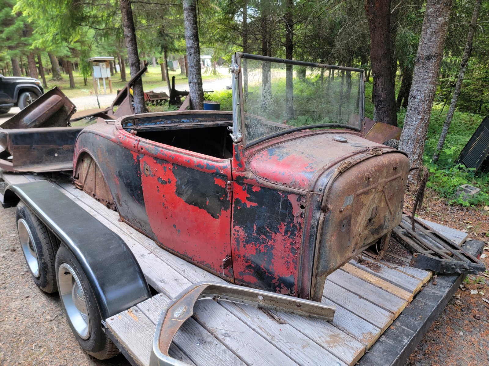

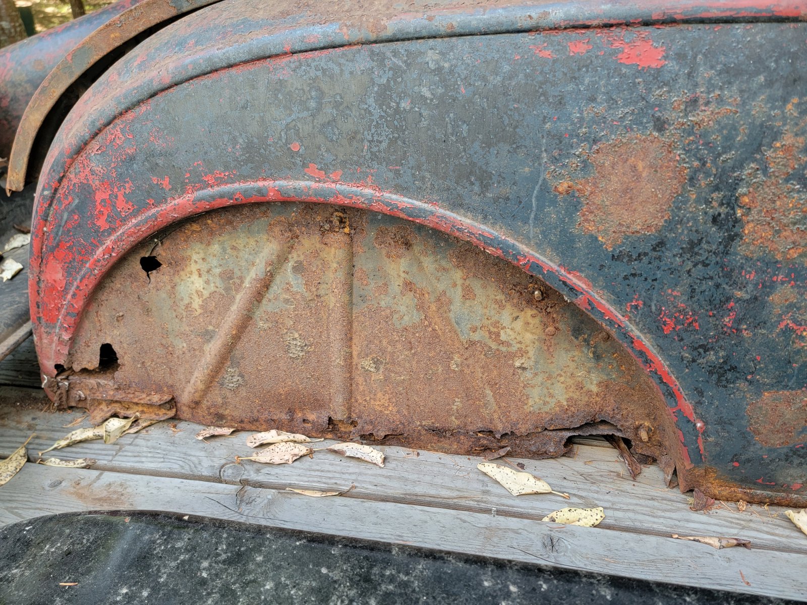

    This is my 1930 model A roadster. It will be built on original 32 rails with a 59ab flathead and a 39 3 speed. 20230624_185623.jpg 20230624_185625.jpg 20230624_185617.jpg 20230625_143825.jpg
    Believe it or not I got this body in trade for something I had no money in simply because the previous owner found this body to be too rusty. Backstory on that...
    I bought a hoard of old model A's for a price I was very happy with (see my youtube channel if you really want to know how much) I got a call one day from a guy who wanted some rear fenders for his model a roadster. A few minutes into the conversation he tells me the car might just be too rusty and he thinks he may just cut the back off and make a pickup out of it. It was all I could do to not shout NO into the phone! I told him I had a fairly rust free pickup and would gladly trade him. That is how I came to own this car and it has been a dream of mine to build a model a roadster on 32 rails most of my life! Thats all for now, more stories and pictures to follow.

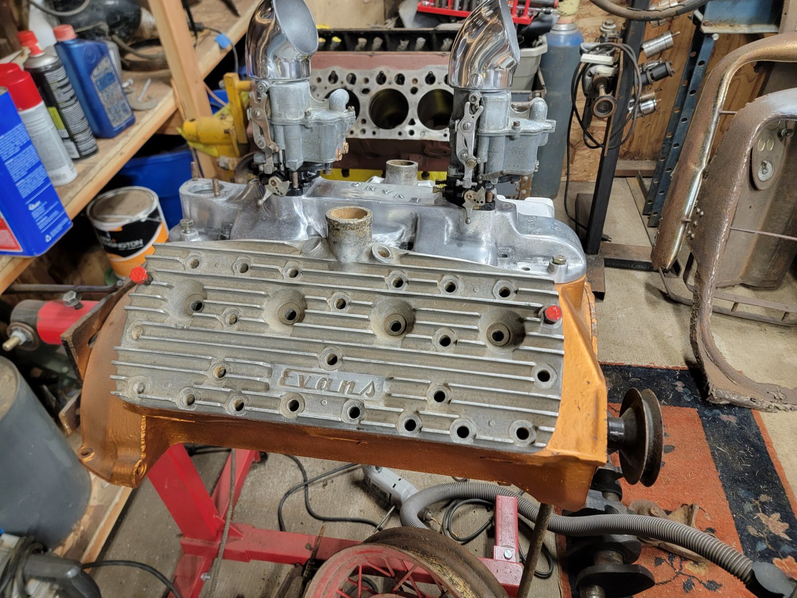

    The engine appeared to be in decent shape. Although being parts I got from a guy who got em from a poor ol fella who had a stroke and was liquidating his dreams. I had quite a hard time of figuring out what was going on.
    received_1611701885974228.jpeg received_235931918954304.jpeg 20230417_085716.jpg 20230416_104848.jpg
    Plug wires cut and stuffed in the looms, pistons pulled, .060 pistons all with decent looking rings but one that had no rings at all. 8ba pistons and crank so that was a bonus. No lifters however the block had been drilled for adjustable lifter adjustment. I do have an old 8ba that has a full valve train as well as the adjustable lifters which will be a donor for this build. Cylinder walls all look good so I am thinking hone it, check it, new bearings, new rings and I will be chugging right along. As of now leaning toward an Isky max one cam. Won't be anything crazy but should be a nice streetable rod.
    I have always had a thing for early evans speed parts. I sourced a decent 2x2 intake and since evans heads are near impossible to find and when you do they are 800-1200 I made a deal with a friend for his edmunds heads. Oh and while at GNRS I grabbed a pair of frog mouths from h&h Mike. 20240211_095014.jpg
    The heads needed some purdying up so I immediately started soda blasting them.
    ....theres a punchline

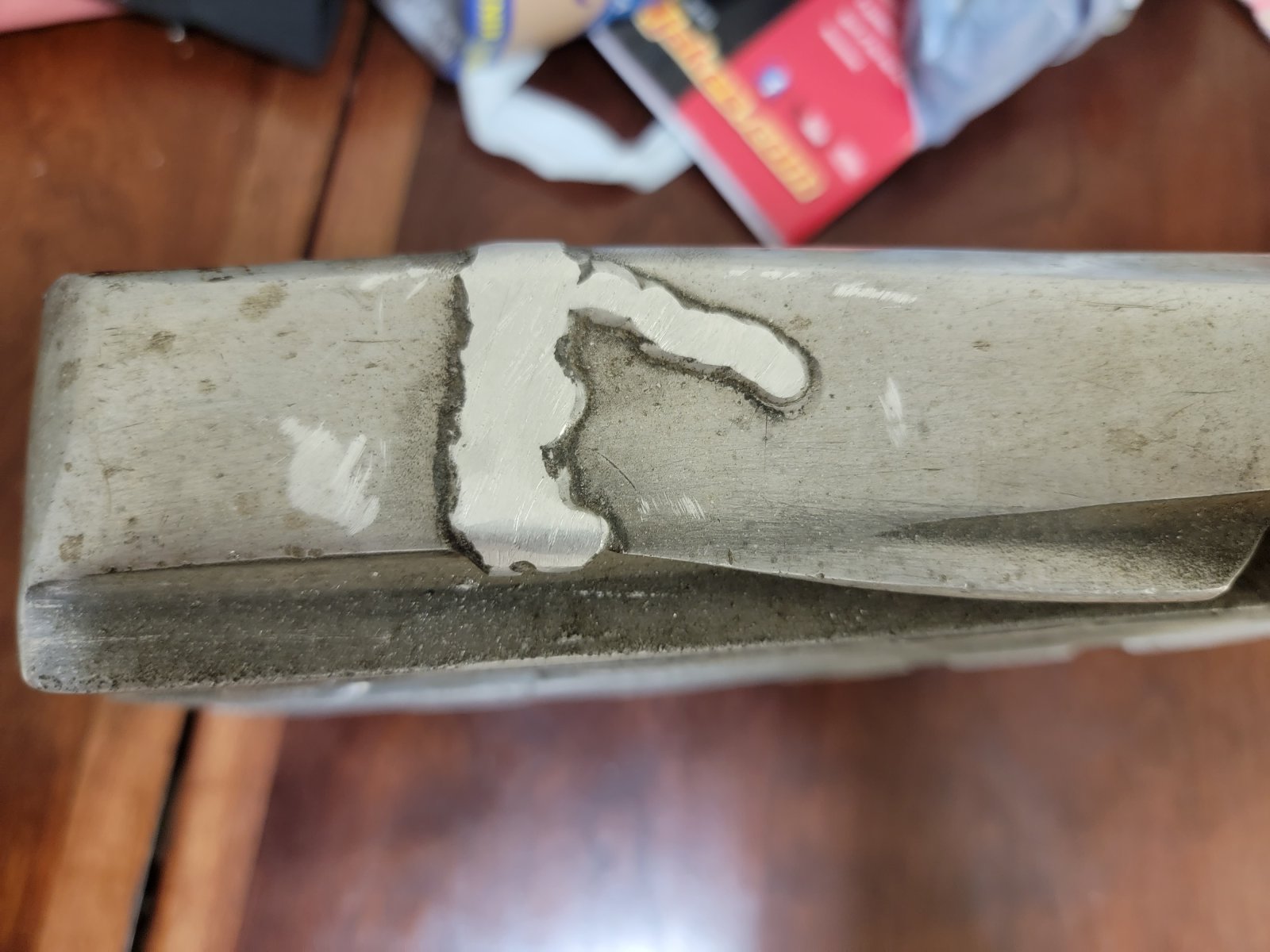

    Okay so to the humor.... although believe me, I wasnt laughing when it happened. So my deal for the edmunds heads, 350 bucks! All I have to do is help my friend list and sell some stuff. Trailers, cpl cars etc. I help, I get the heads, SCORE! I mean Ive been looking for evans heads for 2 years and found zilch....whatre the odds of me REALLY finding some? I even saw this car at GNRS that made me sad about that fact
    Looks killer right? Scott Millers roadster! Yeah... so I now have my edmunds heads. Whats this? Someone on the hamb lists a mismatched pair of heads!? And ones an evans!?? 150 bucks!? Sold fast too. Matt Murray (iron trap) picks a hoard of amazing speed parts and I spy 2 sets of evans heads!! (We are talking about the day after I just bought edmunds heads) I reach out quick, they send me a pic of some early block letter evans heads, chipped fins all over but mostly solid looking...ish...how much? 800 bucks? Yeah I was considering it. Couldn't afford it, had a hundred bucks in my pocket but theyre hard to find when you're lookin! I mean look how pretty that setup is above! So I'm scrolling marketplace the same day. Pondering it all. I see some 8ba offenhauser heads for 350! Decent deal! I go look at what else he has....8ba evans heads! Way cool! Annnd....59ab evans heads...350 bucks. I just spent almost all of my money on the edmunds heads and here they are, the heads of my dreams 30 minutes away for the same price. Not funny, no, I wasnt laughing. Luckily for me, I know the guy. Sold him a 21 stud a while back. I go check em out. They're cracked but well repaired and have been run on two cars since with no issues. He lets me put 100 down on em since thats all I have left besides moths and belly****on lint in my wallet. I owe him a big favor!
    Color me happy now though :D
    25 min with a ******* file-
    I think theyll work out just fine, welds look CLEAN!

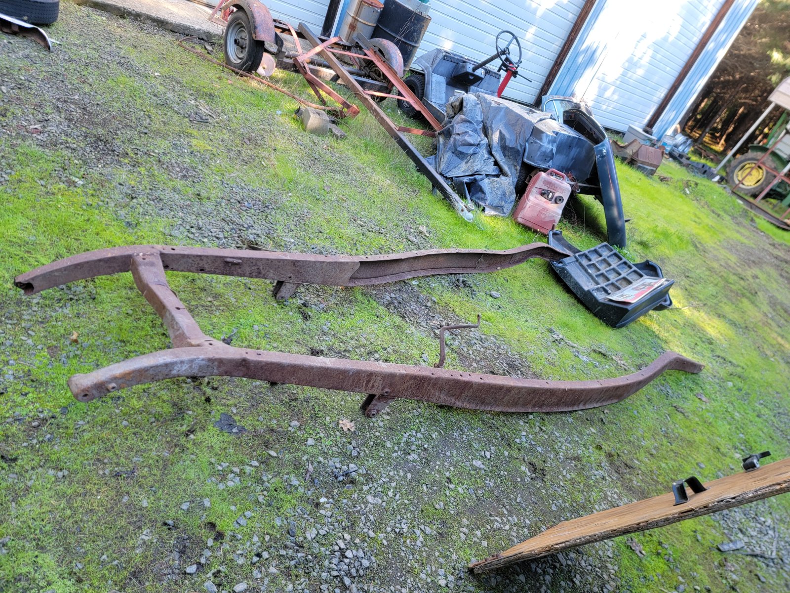

    The Frame:
    The frame was tricky, let me preface by clarifying an important point. I am NOT wealthy. I fund my builds by bartering, trading, buying and selling parts and cars. A 32 frame isn't a cheap date. I found an original locally for 600 bucks, sold so fast I think the guy was still typing the ad for it. Another ad a ways away showed a set of repop rails for 1k. Probably doable but would take some saving. I have a model a frame but that just isn't "the dream" if we are being honest with each other, repop 32 rails aren't the dream. I'm not knocking em or anyone who uses em. I just want as many original parts as I can muster. My buddy Scott decided to take pity on me. He offered to trade me his original 32 rails for the value he paid for them and let me tell you, it wasn't a mountain of cash. So I race the winter snow storms and go see Scott. He lives 6.5 hours away. I need to go see him anyway, I have a whole pile of parts that're his and need to go home. The trip is also chronicled on my youtube channel. 15 hours of driving later and I am home with an original set of 32 rails. Thats the good part. The harder part? I'll show you...
    The street rod these were on was hit...HARD. They are pitted and just need lots of help. A daunting task but I am not one easily daunted. Only problem I can see is that I need a frame table and here we go again. Steel is EXPENSIVE!!! The cost for materials for me to build a frame table rivals the cost of nicer rails! Well I start digging. I spot a frame table an hour away 100 bucks... I was first on it and aggressive, polite but firm on the fact that I was coming not wanting to appear wishy washy as so many others in the world of marketplace and craigslist appear. It wasn't convenient but I got it done. Frame table, CHECK! I may very well be building one of the least expensive roadsters in the last 20 years although I will gladly credit that to luck and great friends!

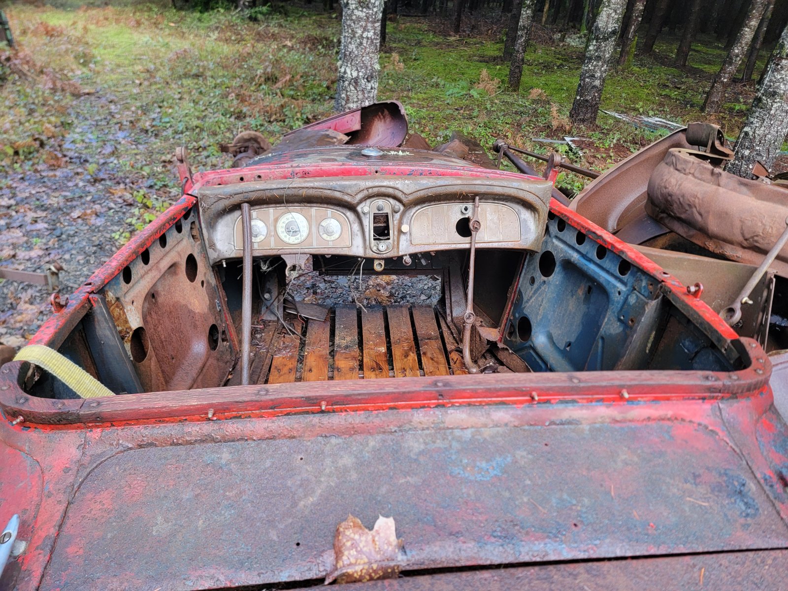

    In my opinion, and my opinion may not add up to a hill of beans. I think one of the big areas a traditional model a roadster needs to shine in is the dash. A 40 dash retro fitted, a slick polished insert. There are so many wow factor points each and every car I see with a wicked dash treatment gets. I have to find the right amount of cool, period correct with a little cleverness for good measure. In my hoard I have a 36 packard. The thing is rough in every direction but one. It has one helluva dash in it. With a slick 120 mph speedo.
    I do a little measuring and the things perfect! So? I hack it out! I prop it up in the body just so I can see what it'll look like.
    I send some pics to Scott and he says "that dash needs a waterfall in the center like a zephyr." Dude has an eye! So thats the plan. 36 packard dash with a narrow waterfall to the floor. Will take some figuring and a whole lot of mocking up and measuring but will look real slick if I can pull it off!
    I will also have to source some kind of a clock for the glove box and address the missing ashtray area.
    I pulled the cluster and took each guage apart for a gentle cleaning. Will likely strip the paint and polish parts of the insert for a more flashy look

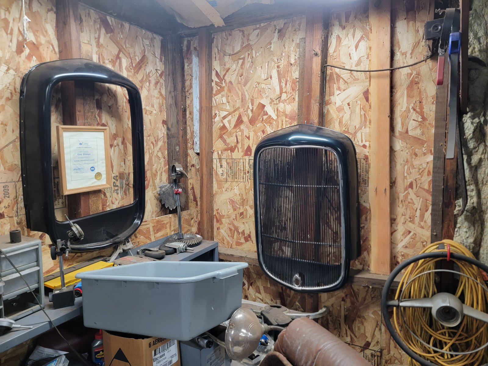

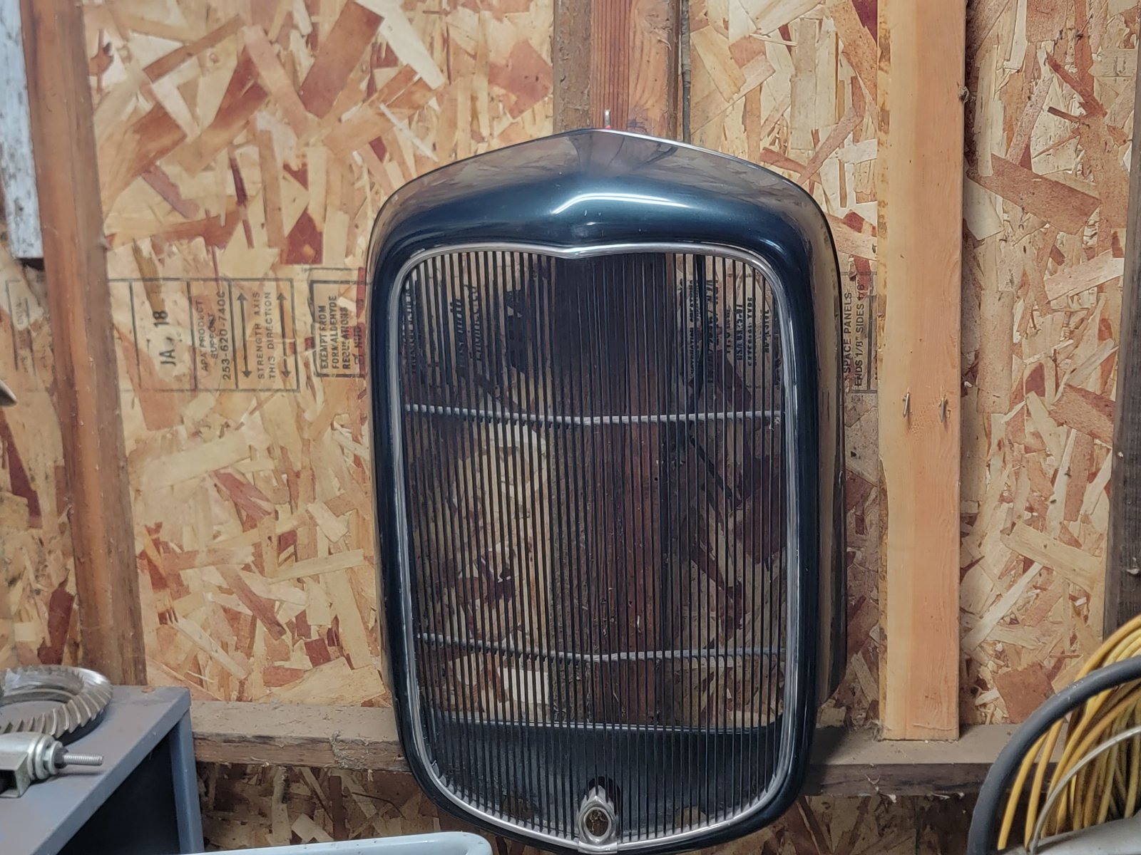

    Color me tickled! Today the grill fell into place. I had previously planned on using a repop shell and insert. 1k-1200 that it seems these are going for these days was out of my price range. Well I was able to convert my 350 dollar edmunds heads into an original 32 shell and insert. Happy days!
