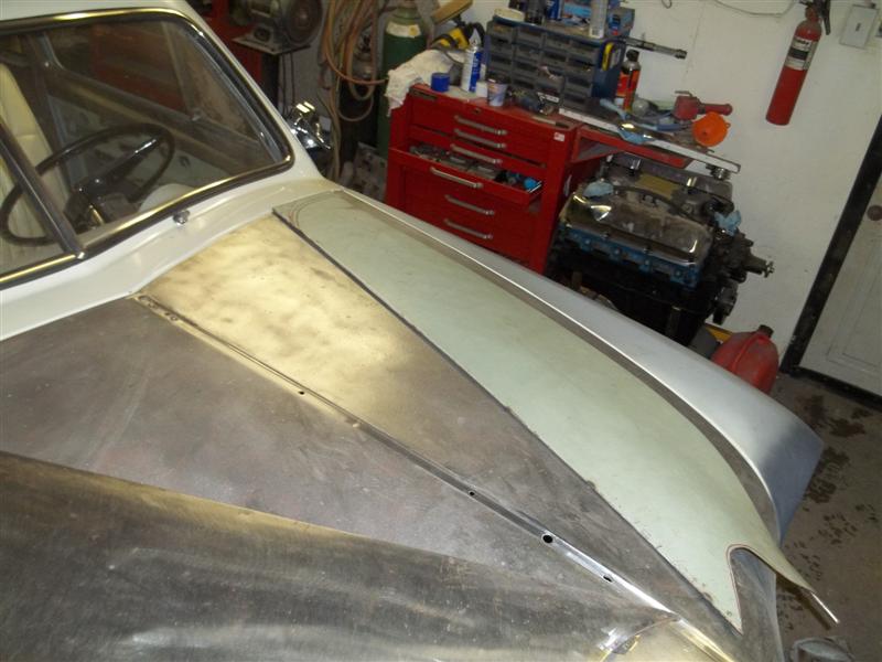

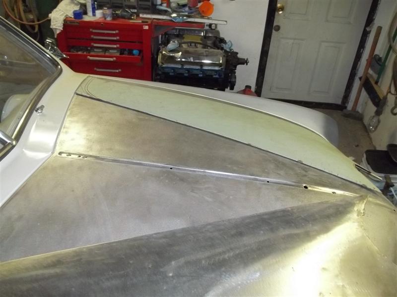

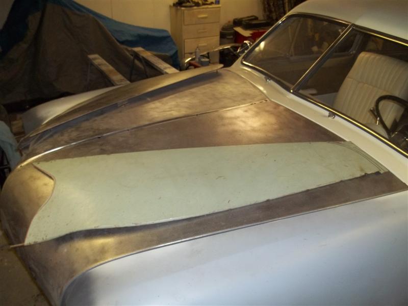

    Well i got got my *** back in gear and thought i'd tackle a left skirt. The right was mocked up a few years ago just to get an idea where i was going. The hardest part about making right and left parts is duplicating a rt and lt. So i got the 2 haves from a old 50 hood. This gives me a 50 inch skirt with complex curves to start with some m***aging. The frame is made from 3/4x1/8 flat bar and for the bottom edge is 3/8 round bar for strength. The top edge and sides are 3/4x1/8. Top section is just straight, easy. The ends are heated and formed to fit. The bottom required a more complex form in both directions. That's why i used round bar.There is enough material on the tin to fold over the frame like putting on a door skin and tacked.Pics show what part of hood i used and some of the frame made. More pics later as i go.

    Made from flat 1/8 plate. 3 pieces shaped, welded, ground, weld some more, grind some more, twist it to fit, hammer it, tap it, sand with 80 then block sand with 220. Lots of fartin around. In the end, they are almost the same, kinda. :)
