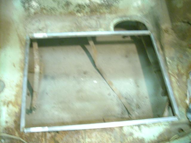

    gas tank time. Tried n true mustang tank. Easy install. I'm going to cap the mustang inlet and have the filler on the right side 1/4 panel. The tank sits closer to the right and shorter to the 1/4 for a cleaner look. Just don't care for the filler in the trunk.

    I like the idea of runnning the filler out the side - pretty easy to weld-up too , since it's brand-spankin' new .

    Yes, going to do the extra work now not later when the tank has gas in it. Now's the time. Win win situation

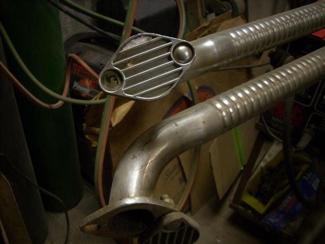

    Picked up a nice set of ripple lake pipes last night. Apperantly they are rare old Fentons according to some hambers. The knowledge base here on the Hamb is incredible. I have a feeling these pipes are going to be the crowning jewel of the car. Some might say it's a waste to put them on a budget build like i'm doing, but........

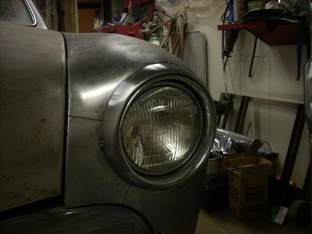

    Got a start on the merc headlight rings. I cut the bezels down by 3/4 inch. Stock mercs looked like cannons sticking out the fender so i thought i'd soften them up abit. Headlight bucket ***y set back about a 1 inch or so from the inside of the fender.

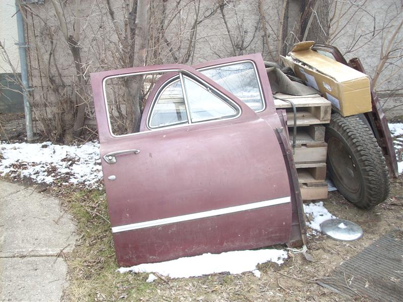

    A buddy and i bought a 50 for a parts car cheap. Lots of parts. We each paid a few hun. He wanted the overdrive ***y and rear end and i got the rest basicly. We both come out ahead. I'll use the frame to build and use the other one for a roller. Got a beautiful trunk lid, rear bumper pan, 1/4 panels, roof? nice tight hinges and latches, trunk centre pan and spare well is nice to, 4 rear nice doors complete, Hood was good enough to make my fender skirts. etc etc. . Back yard looking bad ,real bad.

    I like it - all except those lake pipes ... you can throw them away in my garage & I'll dispose of them properly ;) .

    You might be right. They do look a little dated don't they.:)

    Oh dammm you are killing me with those side pipes...I have been looking a long time for some of those...great score.
