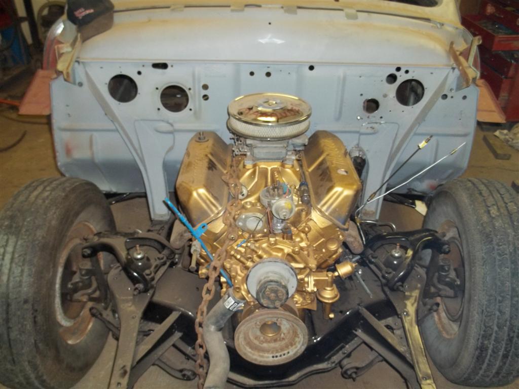

  10. Yes i used a rack from a caviler. I'll post some pics of the install before i put the body back on. I realise i've lost some turn radius but my rpu isn't that great either, but very managable. It will be far better than the sloppy old manual steering box. Right now i'm dialing in the racks steering 'u' joint shaft to the 5 liter headers . Stock cast manifolds would have givin me lots of room but i like the headers.
    The exhaust pipes are off the shelf 5 litre but aftermarket. Fit is near perfect.
  11. I'm not sure what the booster is off of. A friend of mine gave it to me. It's small and only a single diafram unit. Should be a nice little assist with the long pedal from a early sixtys gm truck. Made the firewall bracket, swing pedal bracket myself. Bracket ties the firewall and dash together with a 6 inch or so square plate on the inside of the firewall to rid of any flex in the pedal. The master in the pic is 80's corvette for 4 wheel disc brakes but will be changing that in favor of a disc drum master later.

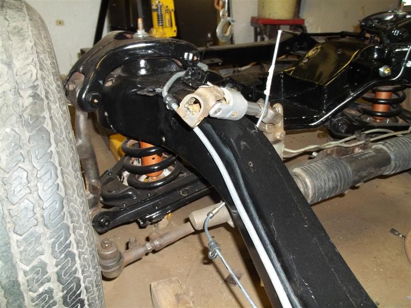

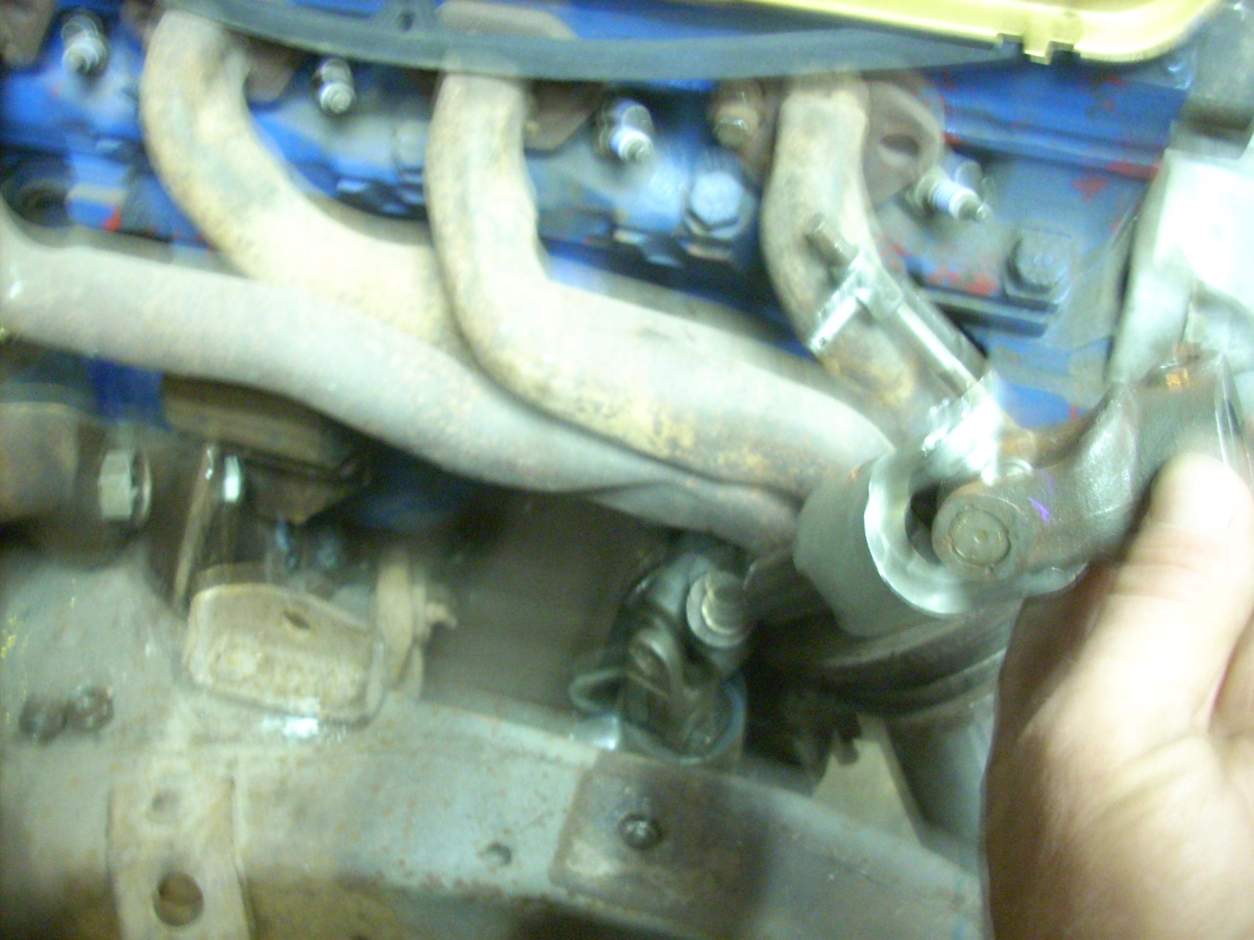

  12. I took a few pics tonite but it's hard to make things out as the engine is in the road and my crappy camera is going south. But maybe you can see abit in mock up form.
    I'm holding up in near position the universal steering shaft of the rack to column. It's the stock cavy unit and trying to make it work since i'm a cheap bastard. Kinda big thou, but it' way down under and can't see it that well anyway. May have to shorten it a few inches in the end but don't know till i get body and column back in.
    I also notched the front x member and boxed it for the front sump oil pan. I chose this route for clearance for the rack which worked out real slick.

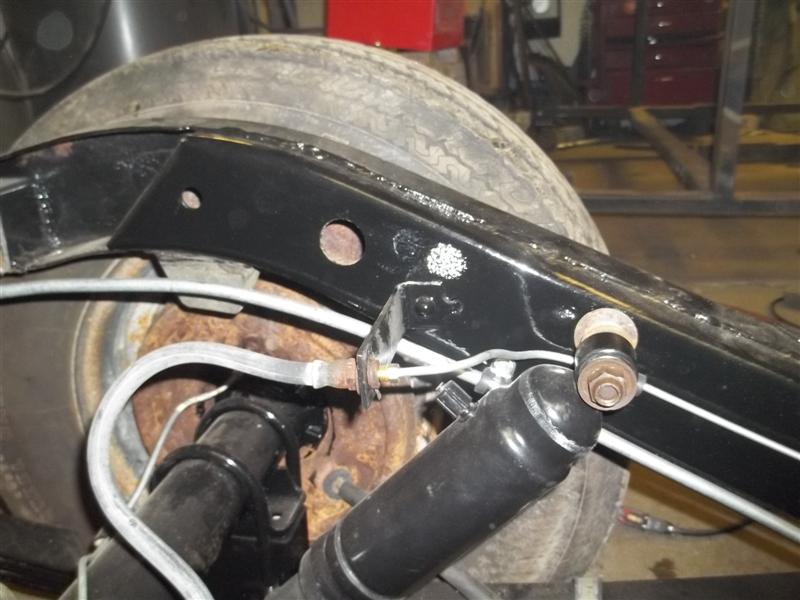

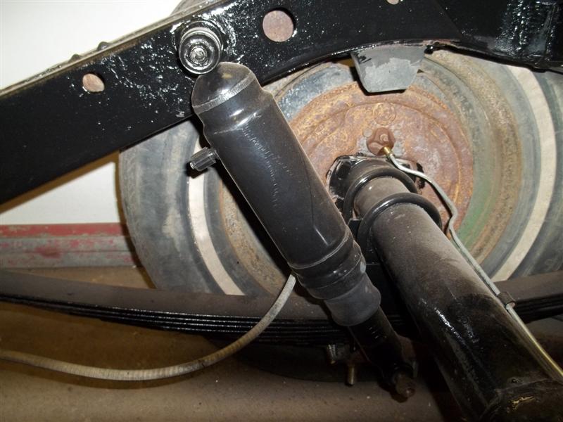

  18. After a bit of thinking what to do with the rear shocks, i decided to relocate them abit since the factory position was just plain stupid. So a few things. I flipped the axle plates from side to side with the shock stud now facing up. Reason? The shocks where below the scrub line with 3 inch lowering blocks. Flipping them makes them still fairly border line but much better. Still have to trim the U bolts as they hang too low as well.
    I moved the upper shock bolts approx 4 1/2 back from stock using the same technic ford did with the steel sleeve in the frame. I still have to do the left side but you get the idea from the pics. Makes a big difference in shock angle. Maybe not ideal but better. Left side is going to require moving a few things around but no big deal.
    The shocks i'm using are monroe max air. Went with air so i could bump up the rear a little if i had a load.
  19. Did the other side today. Had to relocate the brake line bracket but no biggy. Just another step forward.

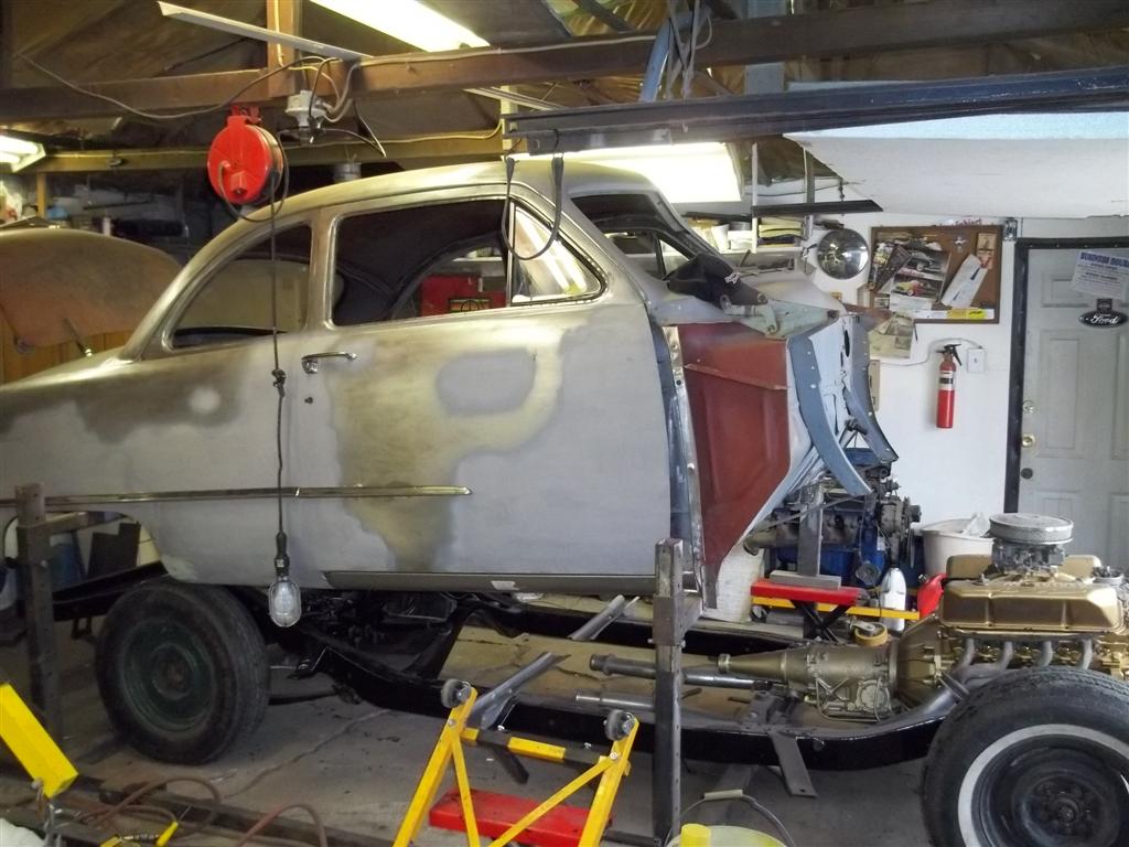

  23. I got the body resting on the frame finally with the help of a fellow Hamber. Waiting for this day for along time. Now to shim the body so the doors close again,

  25. I think i'm going to be ok with the steering column and rack hook up. It's close to the headers which was my concern but i think i can make it work with a bit of juggling to get more clearance. The stock cavalier 'u' joint shaft, shortened slightly, comes with a vibration dampner and thought it might be to fat at the headers. I can change it to a smaller one if i have to for more clearance
  26. Body bolted back on the frame with the doors closing again, Some shimming required to get the doors working. I also have the rockers buttoned up as the mid floor braces. Sure glad i waited till the body was bolted up first before the rockers and mid body floor brace was welded in. Those EMS panels are heavily made and the result is solid as a rock
