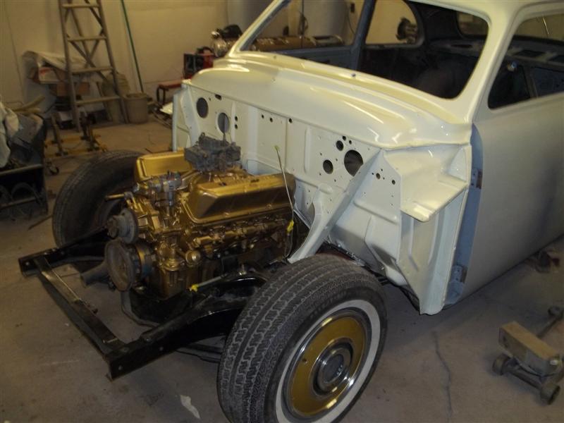

    Moving right along here. Got a little paint on the firewall today. Getting ready for the last install of the power train.This is were things start getting fun.
    KoLoR ? KooL VanillA. I'm usually not a fan of whites on rods but i like the vintage hue it projects and easy maintanance vs dark colors. Looks so much better in real.
    I also changed my mind about the original coils cut down and went for the aerostar coils up front.

    Someone requested motor mount pics earlier and it's a bit late but here's my own version of mounting a sbf in a shoe. Repo flatty mounts used as isolaters and simple bolt on brackets i came up with.
    Oh got the motor in today. This is starting to be too much fun.
    The areostar coils are going to be just right. Not that low in the front i don't think but it should ride good. The roads around here are brutal and i plan on driving this thing. A lot.
