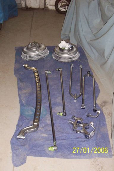

    not really. I used the Alsa Corp Mirrachrom on these parts. Turned out pretty good. Sure as hell a lot cheaper than chrome. Cost about $200 and I still have half a bottle left............for next project.

    The drums and suspension parts...

    suspension parts....

    It's a pretty simple process. Preparation is the key (which I am lousy at).
    First step is to prime your parts. I used high build primer. Secondly, sand the primer and spray with a black base coat. Third, clear coat the part. I used the clear coat that Alsa sells. You have to let the part sit for a week after you clear coat it.
    The next step is the tricky one. Using a touch-up gun, set at a really low volume with the compressor at 20 lbs, you lightly fog the part with the MirraChrome paint. When you first apply it, you think that it is going to be kind of foggy. It's amazing to watch though as the gases escape from the paint. It turns shiny before your eyes.
    It takes about 24 hrs for all the gas to escape and then you can clear coat it. The clear coat really gives it a gloss.
    I've probably left a few steps out but the Alsa website has more info (www.alsacorp.com_

    You couldn't do those drums in chrome and get a good job.
    The chrome won't throw between the fins, nickel would be thin and corrosion set in pretty damned rapid.
    That is very cool stuff.
    Especially if it has any endurance.
    Ceramic coating are getting better all the time too.
    Won't need chrome before too long, except for resto jobs.
    Well done.

    Wild Willy.......I was your guinea pig! The coverage is amazing. I used approx. 6-7 ounces for all those parts. The key is to gently 'fog' it on to the parts. The challenge is to make sure you cover all the parts. It's so reflective that sometimes you lose your place in spraying. There is also a new machine applicator that Alsa is selling that imitates chrome's reflective properties to a 't'. I didn't see it but the local distributor was telling me about it.
    Bugman........yes, they say you can polish the base clear before you apply the MirraChrome. I didn't do this. Apparently, the shine is even better if you do polish it. They also say if you use a hair blow dryer or heat gun the gas escape faster.

    AHotRod.....I have no idea how much it would take to paint an A sedan. I used approx. 6 ounces for all the parts.
    It really is easy to use. The trick is having the compressor set at 20 lbs and a very low volume on your spray gun.....to the point of it almost shut off. The product has to be fogged on, as they say in their web site.
