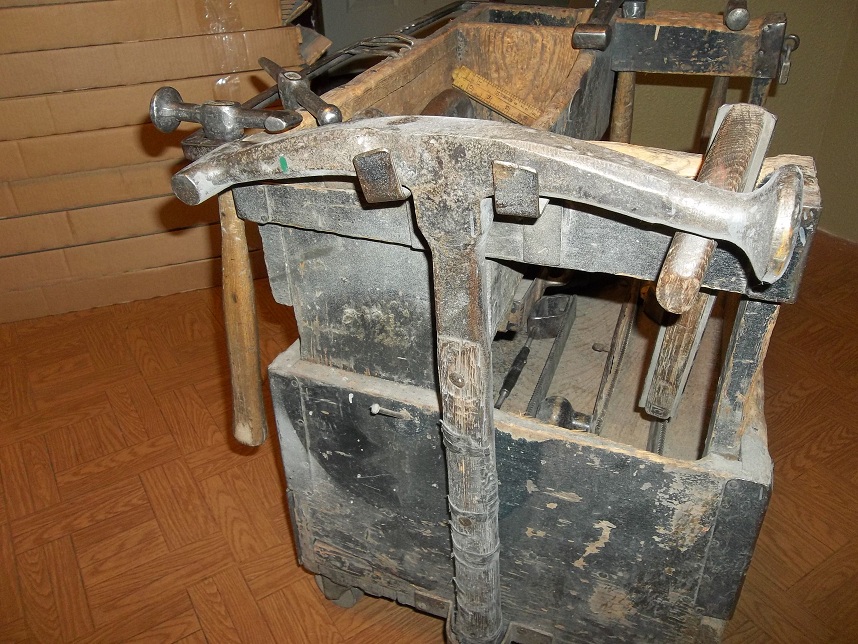

    Does anyone recognize the maker of this hammer I got the other day,,there is a circle and an S within it,,only $3.00 and you can never have too many hammers..

    The imperfect results if they happen are going to be from the guy swinging the hammer.:)
