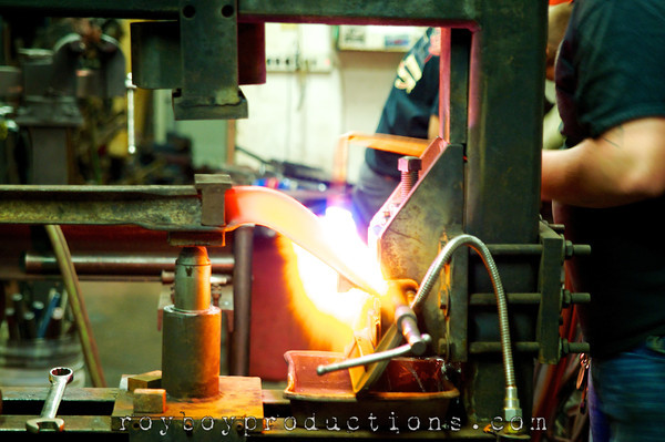

  1. Been looking at threads regarding dropped axles for ages now, and decided its finally time I took the bull by the horns and tried it out myself. Im building a 28 Tudor and had a Magnum axle which I was going to run, but considering the issues with those axles of late and the fact that the dropped Ford ones just look drop dead gorgeous it was a pretty easy decision to shelve the Magnum and drop an A axle.

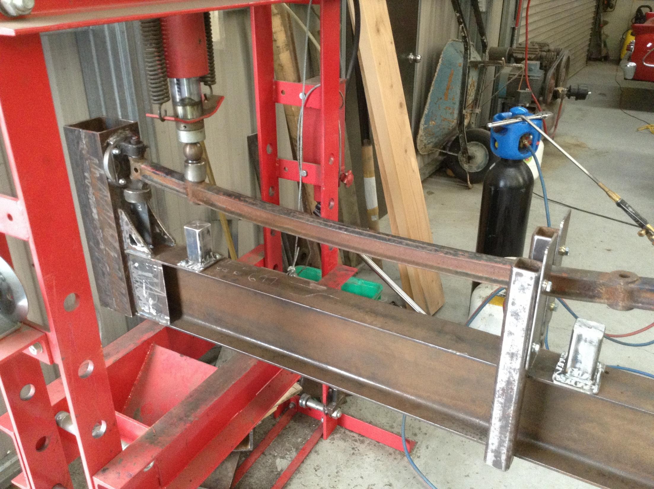

    I whacked a jig up over a couple of nights at the shed after looking at various ones built here on the HAMB. I made it with bolt on stops which give a drop of 2 1/2 inches but you can bolt on spacers to decrease the drop.
    Got me a $30 A axle at the Mcleans Island swap meet, got the big old heating tip out and went at it. Ive gotta say that im pretty bloody happy with the outcome and I couldn't really believe how easy it actually was.
    Just dropped another for a rodder up Temuka way this arvo as well, im now hooked haha, anyone down this way want an axle dropped call me cause im addicted!!!

    I really like your jig......sweet

    Are you just using acetylene?

    Show us some more picts of you jig !
  11. Yes I agree more info on the jig like degrees, angles, measurements and such. Looks like a sweet jig.

    I've always wondered how you get the bend area hot evenly. Rosebud tip I guess.

    I've always wondered how you get the bend area hot evenly. Rosebud tip and acetalyne I guess?

  19. No im using LPG (natural gas) and Oxy, its alot cheaper than acetylene.
    Thanks for the comments as well guys, I will try to get up to the workshop this arvo and take a couple more photos of the jig.

    Good work, and like the others, I would like to see more about how your jig works.
