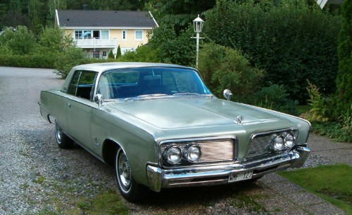

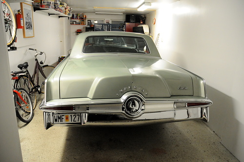

  17. I have a very weak spot for '64 Imperials as I used to own one. Mine was a very nice untouched car, PIne mist green with a pearl green leather interior. The car was close to perfect, not even a hint of pitted chrome anywhere, only partly some faded paint and dried interior. Even it it was nice I replaced many small parts with even better N.O.S parts, and brought a new chromed rear bumper (2000 USD!).
    Next on my plan was to slightly lower it and use reproduced Chrysler wire wheels and period perfect bias ply narrow white walls (Supremes do not fit an Imperial).
    However, the car was sold and replaced by a '51 Lincoln, my current project.

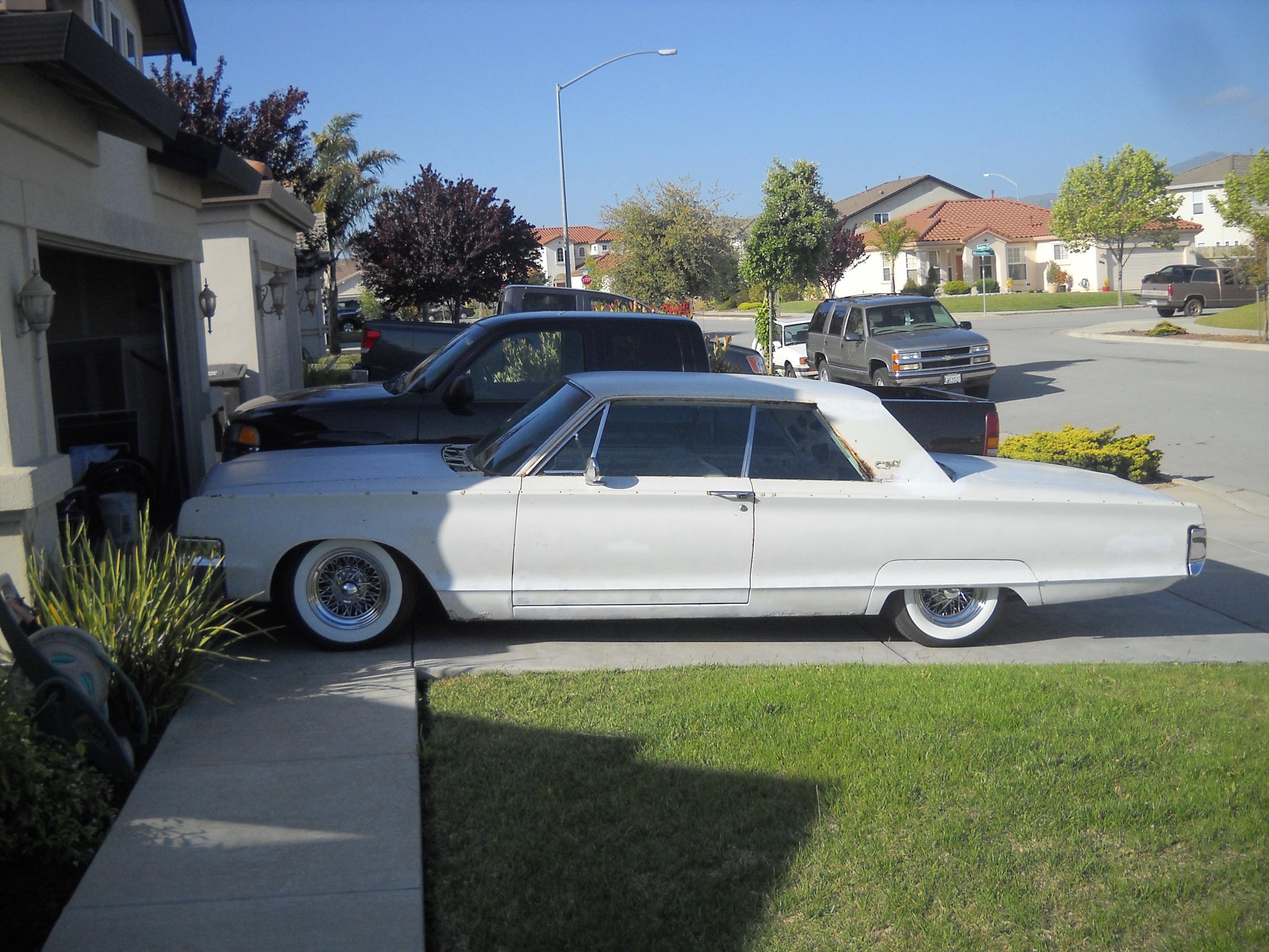

  27. Searched my files and found an old photoshop of what I intended to do with mine. The original wheel covers looks real good as well, deep dish with cast centers. They are real heavy items!

  28. Well I ordered a set of skinny whites today. I wish I had the stock Imperial Hubcaps, but they were gone when I got the car. I'm still trying to think of a good cap for the car that would be correct for the era look I'm going for. Wheel vintiques has some cool bullet center caps, but they said they will only fit they're wheels. Also I put the car on jack stands and was going to turn the torsion bars...do I need a special tool? The hex spot on the end is bigger than a 1" bolt head. Should I weld a big nut to a rod and make a tool??
