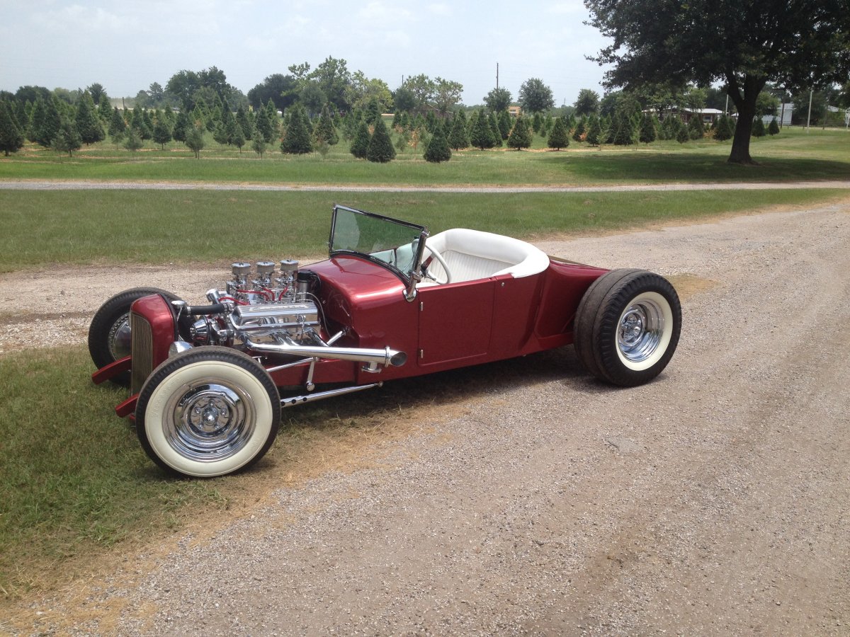

    IMG_2122.JPG Well Me and my dad just got done with a 27 roadster we've been building for a couple of years. it is a close copy of the roadster he built in 1959 and showed across the country as the Satan's Chariot.
    Its a steel ford body channeled 6' over a 32 frame with a 327 chevy with a powerglide trans.
    hope ya'll like it ! IMG_2123.JPG IMG_2121.JPG IMG_2120.JPG ACH]

    Outta the Park!!! Everything about it is "Just Rite"! Job well Done.. Sure that will be in magazines in no time.. Cheer's..

    I love the whole look of that rod. Looks like something right out of a 60's Rod & Custom magazine.
    You nailed it!

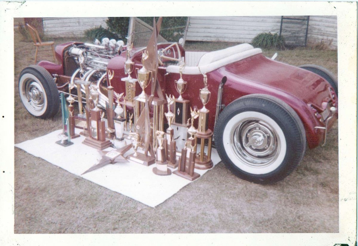

    thanks everybody ! Here's a pic of one of the version of the oringal car satan6 (2).jpg

    So what ever happened to the original?

    we're not sure last time we saw the original car it was at the del mar swap meet in Houston around the early 80's guy wanted 2500 and dang I wish we would have bought it back then

    Looks great, looks like the original went through a couple different versions and the new one selects the best aspects of each.
    Does the car have '32 winshield posts? Something about that windshield is very unique.

    yes it's a modified 32 windshield,the body has been widened 4" and I reshaped the cowl to take the later windshield
    The original car was widened 6" and channeled over a 34 frame but dad never liked the way it turned out so we did this one on a duece frame

    Wow, didn't even notice that, very well done. Is it widened 4" all the way front to back, or just at the cowl? Every inch counts in a T, seems like a worthwhile modification.

    I widened the cowl and spread the doors and tub and left the turtle deck stock. it really looks right
