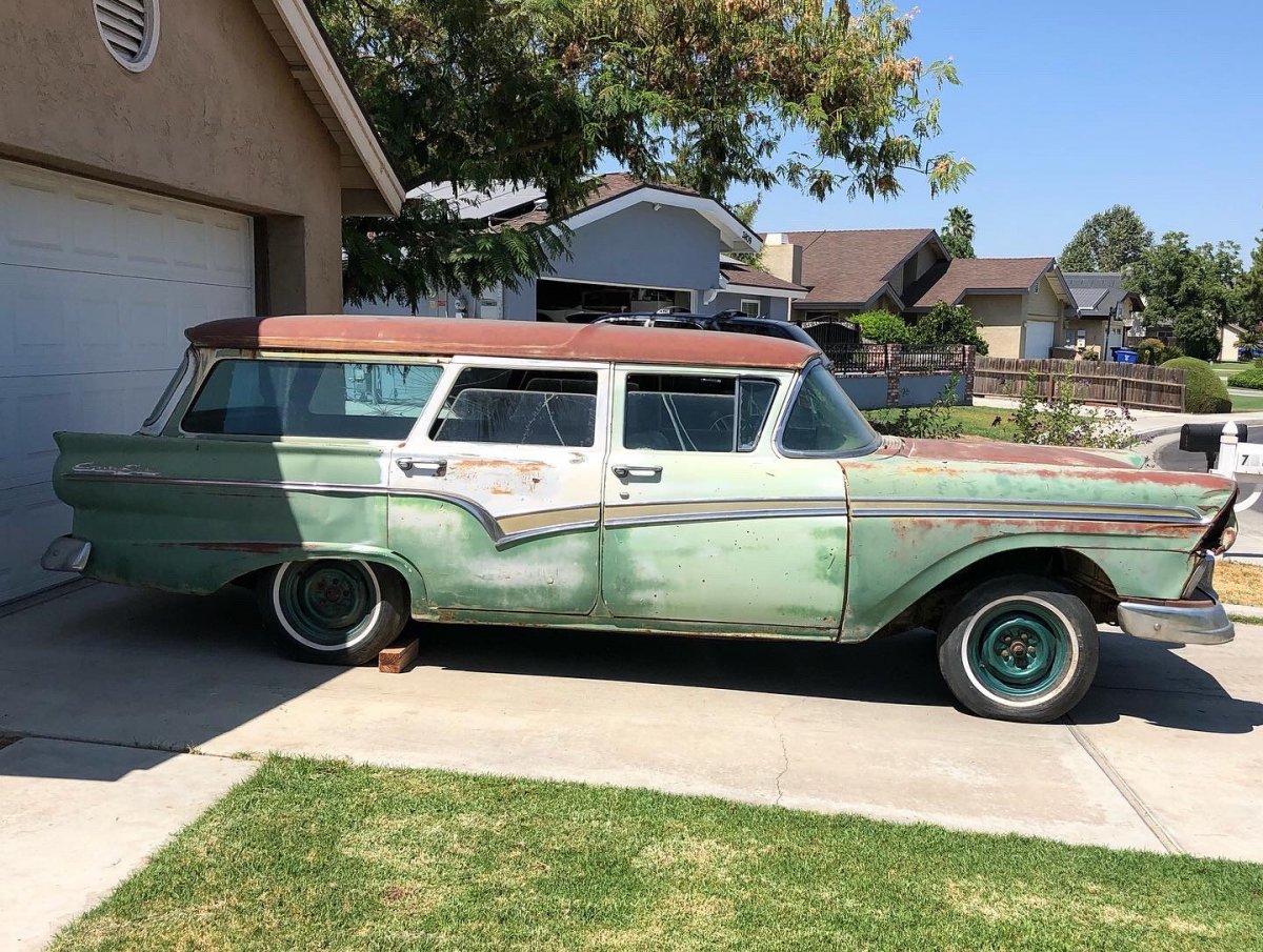

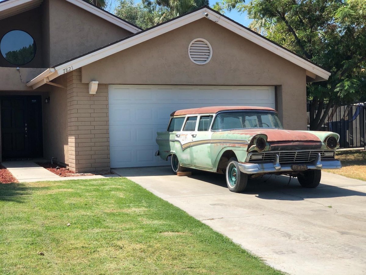

    I’ve been out of commission for quite some time! I was a young kid back in the day when I’d be on this site asking questions in regards to my old 58 fairlane. But now I’m 30, got a house, a stable job, and I have patience to work on a long term project.
    Curious as to where to really “start”. My dad has a 390 engine he’s willing to let me have. The wagon currently has no motor. Should I start with rebuilding the engine and get that dropped in here? Or work on cosmetic stuff first? Where did you first start out with in your current or past projects? B1A3C8A9-1C9A-4B29-BF30-BC623A9EF45F.jpg FF0BB703-E011-4012-A26D-18D292ABF63F.jpg 47171136-804F-4DB9-B3B8-AE1FDE9EBAB4.jpg 47A48C07-2321-4FBF-8D6F-93A359976549.jpg 4440E9A0-53CC-45A8-B5EC-8D970EBB3DD5.jpg

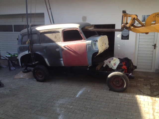

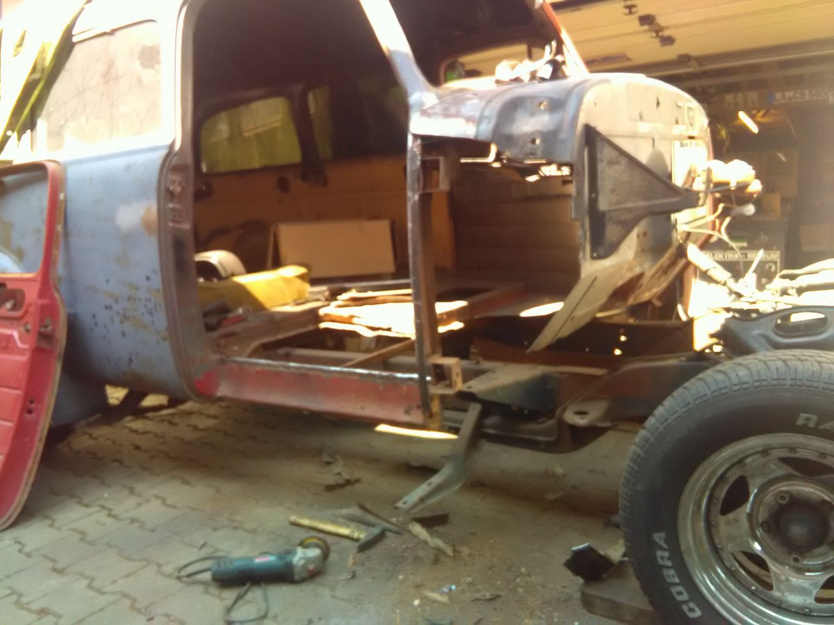

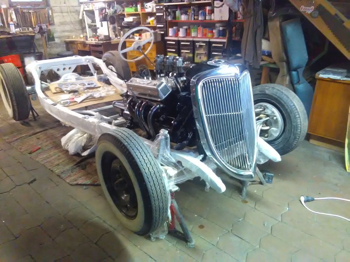

    If there is a lot of rust in the floors or body, I usually brace the body, lift it from the frame and repair the rust issues. While the body is on the rotisserie I paint and rebuild the frame and suspension parts because it is way easier to get everything clean and nice whitout the body in your way. I also put the engine, transmission, all the brake and fuel lines on the frame, while the body is off. When the frame is done I at least seal and paint the underside of the body and the firewall and shoot the inside of the rockers and braces with cavity wax or lanolin before I put the body back on. Then it depends on the car, if I want to just drive it and leave it " patina´d" I´m done, if not, I get the gaps straight and nice, bodywork finished and after that is good enough it goes off to the paint booth.
    Here are some examples:
    1. 64 Wildcat low buck project. Car was rustfree, all it needed was a good cleanup and everything rebuilt, I sold it as is and left the choice of color tothe next owner. 8 years later he is still driving it like that.
    2.My girlfriend Dani´s suburban, truck was a rust and bondo bucket, but she wanted a reliable daily that looked not restored but a little rough
    3. My 34 Ford , an old Hot Rod that needed a little TLC
    Every car needs it´s own treatment... Some need less work, some more. 1964 wildcat 061.jpg wildcatdez 012.jpg 1964 wildcat 169.jpg IMG-20170410-WA0008.jpeg IMG-20170410-WA0019.jpeg fl7.jpeg fl12.jpeg CRPH4062.jpg IMG_20161002_190249.jpg IMG-20170402-WA0004.jpeg IMG_20161115_185426.jpg IMG_4445.JPG
