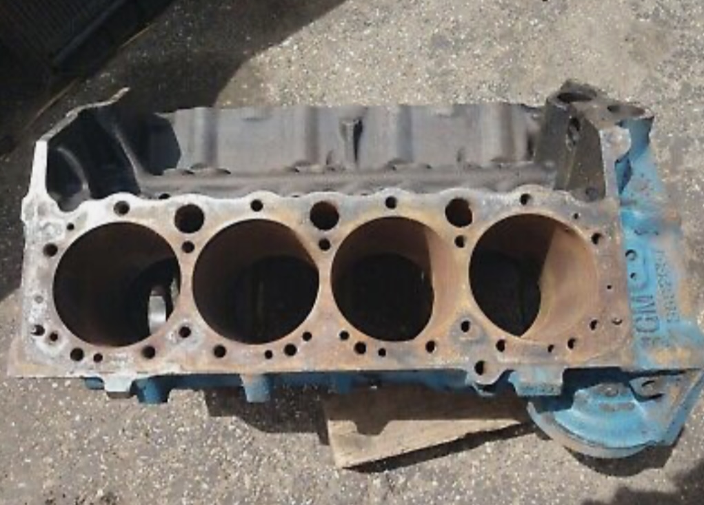

    >>I could try to come up with a 56 265 and make it look like the factory 2 4 bbl version on the outside but be a little bigger on the inside. >>
    If it was mine, I'd leave it a 265 and only try to do things to make it seem a little bigger on the inside.

    Use a 400 block and machine off the side motor mount bosses. If you can find it, there are some with only 2 side core holes, albeit a little bit rare. With some effort, it can be made to look pretty close to the old blocks. If anyone looks closely they’ll notice that it has a spin on filter. No problem, just tell them you updated it to get away from the fussy o ring of the original canister filter setup.
    Heads and intake, you’re on your own there. Maybe start with an aftermarket aluminum double hump casting and modify it to look like the power pack heads. And weld a boss to move the valve cover bolts to match the 55-58 staggered valve cover bolt pattern. Paint it Chevrolet orange and you’ve got a stealth 400 that mimics the 265. Get really crazy and put a 4 inch striker in it and 30 over bore, and you have a 433 thumper!
    Hey, I love spending other guys money…
    bchctybob and Just Gary like this.

  27. DDDenny
    Posts: 21,566
    Yeah, the problem there is you'll always be looking over your shoulder, those Camaro guys will hunt you down and give you a verbal flogging.:eek:
  28. partsdawg
    Joined: Feb 12, 2006
    Posts: 3,845
    partsdawg
    from Minnesota
    Scary looking block in that article.
  29. patsurf
    Joined: Jan 18, 2018
    Posts: 2,136
    patsurf
    that crankcase must weigh about 60 lbs.!!
