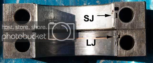

    I just found the important one
    The slinger groove in the block needs to be machined [while line boring] or cut down the slinger on the LJ crank.

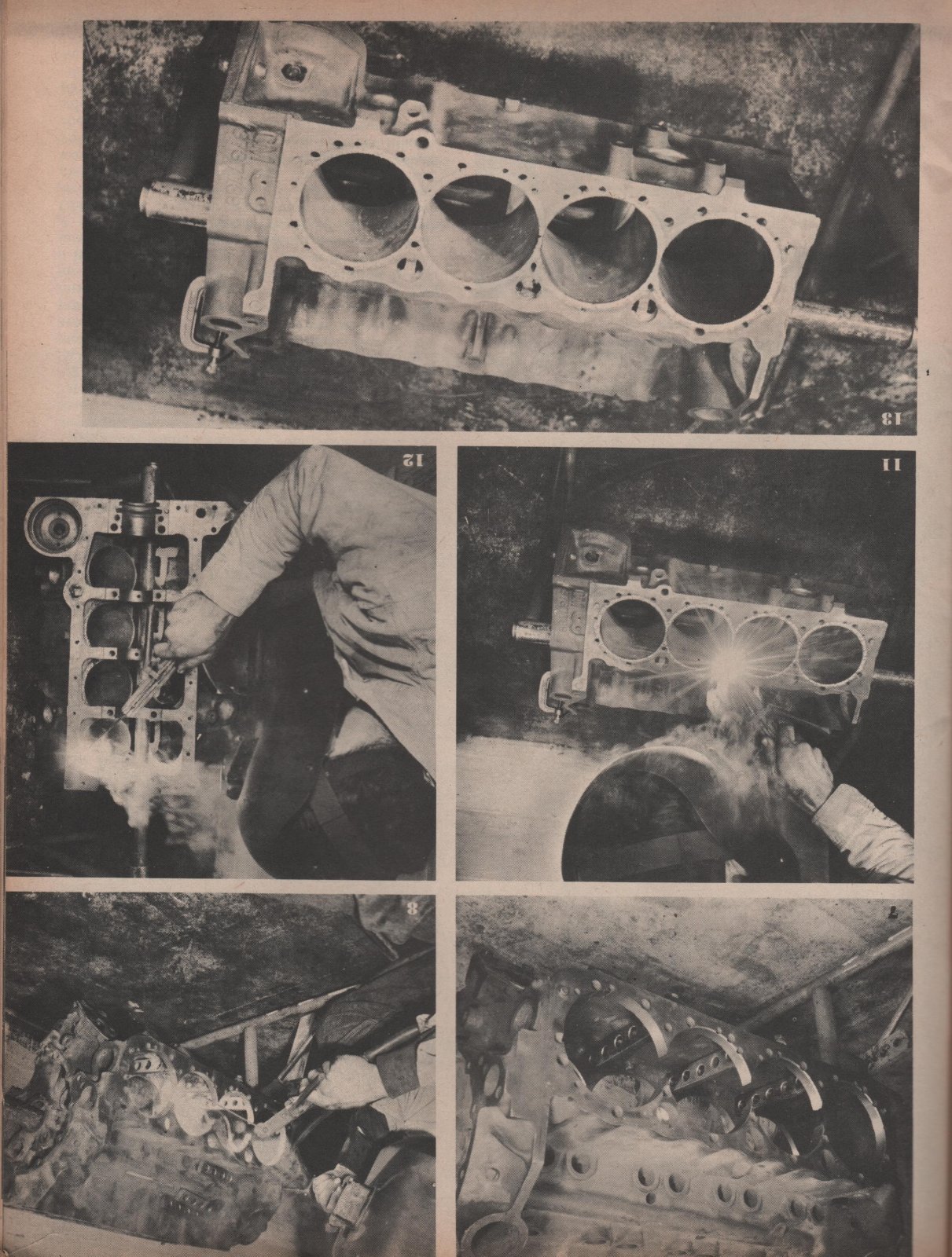

    Image (14).jpg Image (15).jpg Image (13).jpg Image (18).jpg Image (19).jpg Image (17).jpg Sorry about the order.
