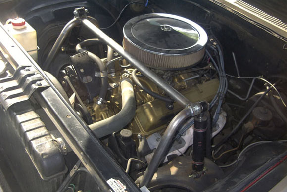

    Here is Donnie's Olds.....
    they show the shocks fully compressed....(bags down....)

    heres the cross tube support....
  28. ESnacky6
    Joined: Aug 28, 2002
    Posts: 1,067
    ESnacky6
    and here's the other side....
    pretty damn trick if you ask me....

    man wait till i chrome the support and flake out the shocks......because i can...hahaha....that's when i get to detailing out the engine compartment...this set up work so fuckin cool.......just make sure if you go that route you have a good welder fab it up for you...you dont want your welds braking and the whole thing comin up and destroying your hood.....

    that is not at all what i was picturing! that's pretty fucking trick. hhmm.....still not sure if that's the route for me.
