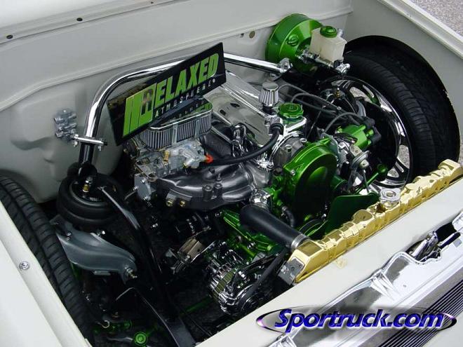

    thats pretty much exactly what i was planning. cant tell for sure, but does it unbolt from the frame? i was planning to either have the bar going across unbolt, or the whole ***embly unbolt from the frame. it seems like it might be hard to pull a motor with that there.

    yea those bars are spinged steel. maybe they clamped something on it. it was a long time ago when i saw it. but yea welding on it would **** it up preety bad and throw it all outa wack.

    i know you are kidding about not needing shocks .riiiight????????.....ever drivin a car with no or bad front shocks?..the shimmy and/or wheel hop is awful.....not so much fun......
    and as far as not wanting to see it......i actually think it looks pretty cool.... especially when its chromed etc........besides its a custom the hood will only be up for checking the oil etc.......i know some will ***** that its not '' traditional...but then again either are bagged cars that lay on the ground....
    just an idea for you......if you go another route i would be interested to see what you do.....i will tell you i love this set up....and after having mine this way. my buddy is redoing his rivi just like this...........

    yeah dude the whole thiing unbolts as a unit......haha i said unit.........you will love it.......

    That's a cool shock mount. I may need to think about something like that for the Cad. Mine barley fit between the tie rod and the control arms right now and it's at a wierd angel I think. As for the sway bar. You'll hate life with out it sometimes. Mines disconected right now. Needless to say it drags side mirors. I have a mixed feeling about what Dr.J posted. They make sway bars that are hollow. I had one on my last car that was made from 2" tube. Worked awsome too. Thinking of making one like that for this car. I see the theory behind it being made like a spring but I don't think it's a standard practice.

    side note: lownslow... the shock mounts are sweeet... really dig that! Ever look at a lot of pre-runners? many have the same setup... figure if it works well with THAT kinda abuse, it's gotta be great for the street...

    lownslo--here's a bag setup like your shock setup--pretty cool idea--

    That "lever" set up is similar to what Extensive Metal works is using on their Hummer H2 and Escalade. Overkill if you ask me. So what is the consensus on welding to the sway bar. What if some sort of clamping device was made to clamp the shock mount to the sway bar. I currently dont have shocks on the front of my bagged daily driver and it is not to bad in town but freeway driving makes me sea sick. I have thought seriously about a prerunner style mount but in order for that to work on my application I would need to cut my innere fenders and relocate a bunch of **** that I am not willing to do on this thing.

    The lever end of the Anti-sway bar attaches,(with extensions) to a bracket on the lower control arm somewhere, usually, (generally speaking, your car may differ.) Expand the use of that bracket by welding or bolting a dual purpose bracket to it, or near it.
