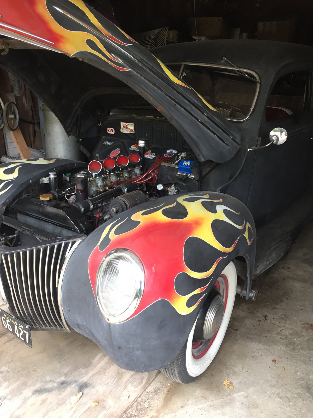

    I see no reason it to use the flat motor. I been driving my 39 ford since the late 1990s. Country driving and big city driving. Never need to worry. Still as dependable today as when I first built it 6A798994-FBF0-4691-9B92-81E4D6EFF5D5.jpeg

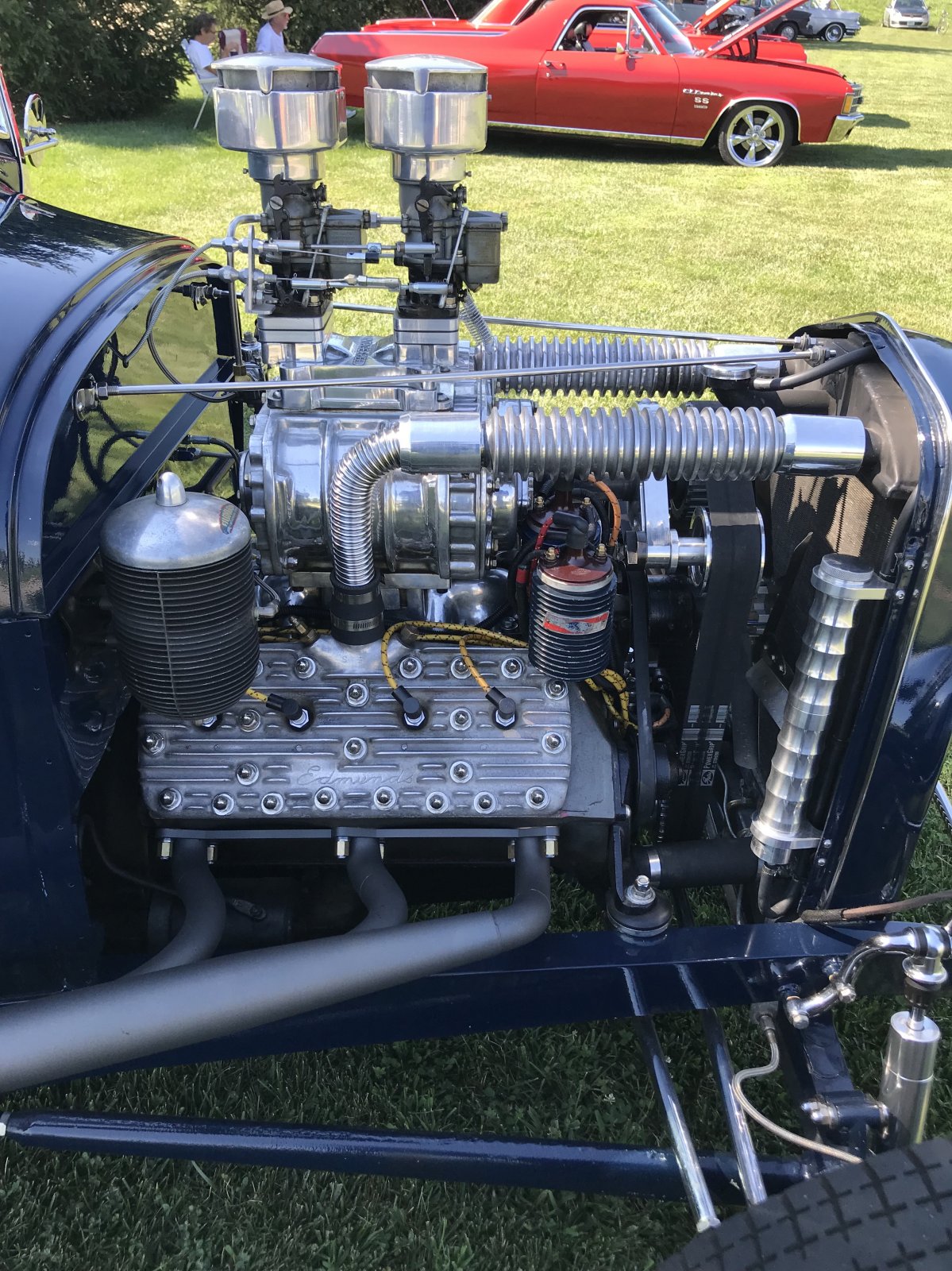

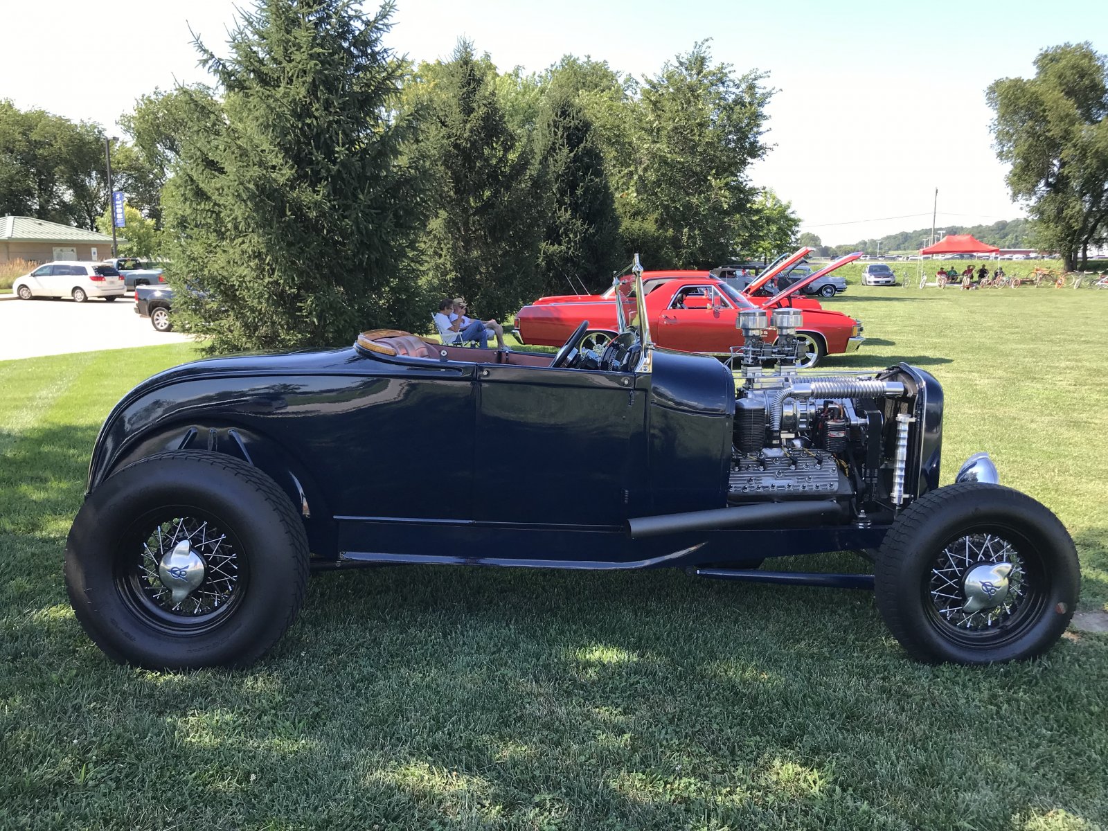

    upload_2021-8-9_18-52-50.jpeg upload_2021-8-9_18-53-50.jpeg Very reliable. Over 50,000 miles in last ten years, only 1 issue; switched out distributor while on a 3 day 800 mile reliability run (took 10 minutes), never overheats and runs all day long at 70mph.
    1948-59ab: 286 ci, Stromberg 48’s, 3-71 blower: 6lbs boost, Harman-Collins 1400 distributor, t10 five speed: 2.95 1st; 70 overdrive, Ford 8” rear: 4:11 trac-lok.
