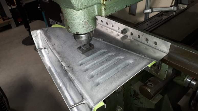

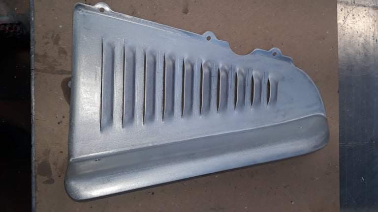

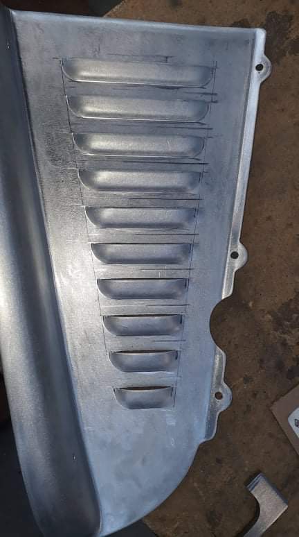

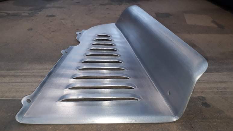

  5. Small heat shield I did for under a 32 Pickup .
    The machine I have for this is a Vibro-Shear , similar to the Pullmax.
    Shrappy

    Nice work @Shrapnel, is that all done with one die or several?
  9. Cheers Loudbang.
    These are cut to length , as opposed to punched at a set size .
    Takes 4 or 5 p***es to cut and shape each louver.
    Shrappy
    john worden, loudbang and Stogy like this.
  10. Cheers Stogy.
    These ones are cut to length , not punched .
    Upper Tool is like a 1” long punch , lower Tool is also 1” long but has open ends to allow for the length of cut to be made .
    Takes 4 or 5 p***es to cut and shape each louver .
    Not the quickest of process’s , but means than can be almost any length.
    Shrappy
    hfh, loudbang and Stogy like this.

    Cheers Shrappy...Such an interesting way to form Louvers...How old is that method of forming? For all I know it might be the original...

  14. See if this works Stogy . It’s a link to a video of louvers being cut into a panel.
    The method of cutting louvers has been around a long time .
    If you look close , you’ll see him adjust the bottom die up (Lifting the panel) after each p*** , making the louver shape deeper with each p***.
    Some guys will do the cut in one p*** , but this can often mean there’s more work required to tidy up the louver .
    Hope this helps
    Shrappy

    :rolleyes:...Thanks for sharing that @Shrapnel...in metal shop we had a pullmax...we used it for shearing and dishing metal...It's obviously a very diverse machine...that's really cool...
    Is that a Roof being punched?
  16. All Good Stogy.
    I’m not sure what panel that is . It’s a random video I found on line .
    Yeah , the Pullmax and Vibro-Shear are both very versatile machines .
    Shrappy

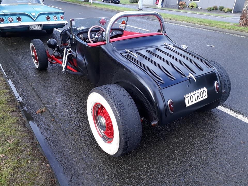

  22. 7273D89B-EAF6-428B-9EA9-8B8B15E4EDE5.jpeg A9FCFE65-6E63-4F46-8052-9517E6700B15.jpeg
    Our Roadster from behind.
    This car was first built as a Track Nosed T . Unfortunately the trunk lid is the only louvered panel left from its previous Track Nose Life .
    Hood Top and Sides , Rolled pans etc , all of which were louvered using a Vibro-Shear to cut them in 1980ish , have all long gone at the hands of previous owners to us .
    Shrappy
