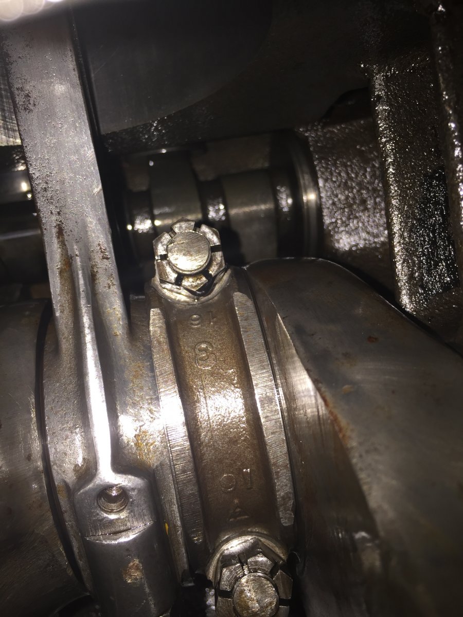

    Took these pictures today of my old engine. Someone did some work to it. Check out the polished crank and over sized main caps. IMG_1813.jpg

  5. Koz
    Joined: May 5, 2008
    Posts: 2,787
    Koz
    Nice! Just for the record, the studs in that motor were only put in maybe a week or two before you got it. All the threads were chased at that time and there were no damaged, helicoiled, or pulled threads anywhere. I checked the decks with a SS edge and they were dead on. I do not believe the block was ever decked, which on a flatty with their typically thin decks, is a good thing.

    I found some interesting info on what was done to my crank. Apparently I have a Mercury 4" stroker crank that has been lightened considerably and then polished. Also the main caps are pretty stout and also polished. Apparently the crank could have been lightened by up to 12lbs. That sounds like a lot of work. This info makes me really interested in trying to get my block repaired. I got a card recently from another HAMB member for Rayco Machine in Amesbury that I'm going to have to look into soon.

    Here is the quote I found on The Ford Barn and a photo.
    "This first picture is a 4-inch-stroke **** crank that was lightened (by 12-plus pounds), given a serious aero carve for reduced windage, and a bit of polish to ***ist the aero plus remove stress risers from the surface. The red "X" on the front cheek is an indicator for some heavy metal to be added here for balancing."
    My crank appears to be the same as the one pictured. I found this interesting. 380668980.jpg

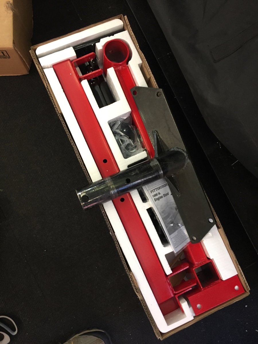

    I got the engine stand adapter today thanks to @Cliff Ramsdell. I also got my heads and will be bringing the to get polished and powder coated today or tomorrow. Getting closer.:D IMG_1838.jpg IMG_1837.jpg

  26. Cliff Ramsdell
    Joined: Dec 27, 2004
    Posts: 1,381
    Cliff Ramsdell
    I love the heads natural but can’t wait to see them finished.
    Glad I could help with the adapter, makes the job go smoothly.

    I saw a flathead with a black block and polished heads with red between the fins. Looked really good. As far as my old motor I think someone broke a stud and tried to drill it out. They obviously failed. The drill probably walked and they may have also cracked it from the stud hole to the valve. I think it can be fixed but is it worth it. I don't know. If not, your right, there is a lot of cool parts I can use on a new one and I will.

    That crank is GOLD. Good score even if you need to find a new block. It may be easier to use a better block and re-do the top end work then transfer the moving bits from this one over.
