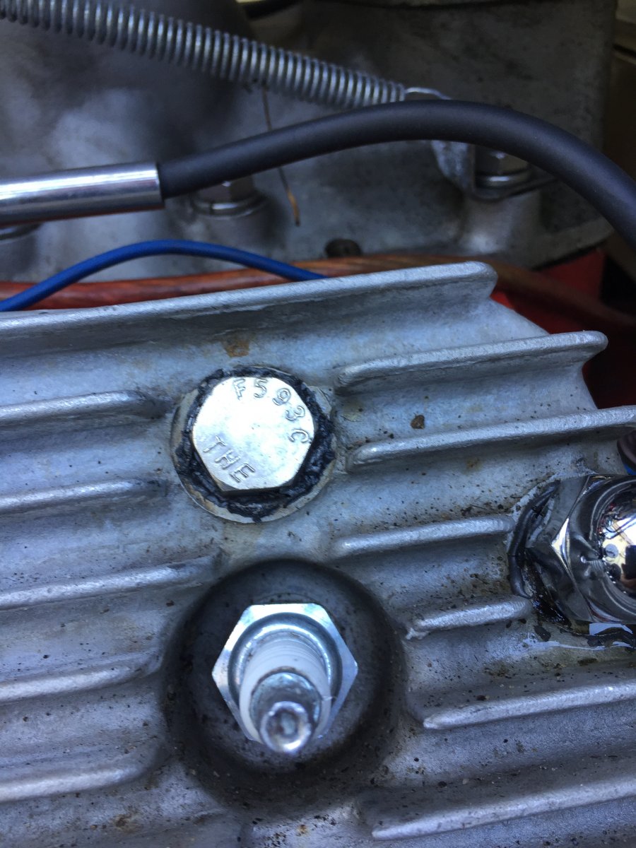

    I like all of your reply, except "cut it flush". Leave the stud up, put a flat washer (SAE so it is snug) over the stud, then weld a nut on top. Get good heat on the stud and work towards the nut.
    Go have 2 or 3 cold beverages while it cools, then back the stud out.

    Re the stud: Ok I see what you are saying now. Ok I'll alter my statement.
    No stock flathead stud has that amount of fine threads.
    If you want advice: I'd say pull the head and remove the stud remnants by following one of the welding techniques. There are youtube videos covering what to do. Don't go near it with an ez out.

  6. Stephen Barrett
    Joined: Sep 24, 2019
    Posts: 878
    Stephen Barrett
    I saw some from Speedway that looked just like mine. I'd like to use ARP studs in but once I get this one out I don't know if I'm up for taking them all out. I'll have to see how it goes. I might just quit while I'm ahead and put ARP studs in during a total rebuild. After all the advice I've gotten about not using an ez-out and the reasons why I definitely won't be using one. I do like the welding technique. Thanks.

    Look, if the engine was running well, I'd just fix what I see on top when you pull the heads. Be a weekend of work for what's needed and a few bucks. Put it back together, run it. Probably out live us all;)

  16. ****s that this happened to you, but like you said earlier, it's a good opportunity to get up close and personal with your Flathead. That sounds like a fun winter project to me!
    One thing you've got going for you is a positive at***ude, so don't lose that, if you can help it.
    As someone recommended earlier, you need a set of transfer punches. A transfer punch with allow you to use an existing hole (like the one in your head -- no, the head on your car!) to center your punch, then a hammer does the rest. Don't go crazy, as you just need a small divot. Then, use your regular center punch in the little dimple your transfer punch made to deepen the dimple so that a drill bit can bite into it.
    I go into a little more detail on transfer punches here: https://www.hdforums.com/articles/hot-seat-biltwell-banana-install/2/
    Mods -- sorry if the link is too O/T, feel free to delete if necessary!
    Someone else mentioned that the head holes may not be ideal for using this strategy, so use caution. It won't damage your head, but the hole may not be machined precisely enough to make this work for you.
    Whether or not you use it on this project, you'll likely have a use for them later. Go nab yourself a set -- they're a hair over $10 at Harbor Freight; a US made set will run between $50 and $100.
    Personally, I like the "weld a nut onto the stud and go to town" method several others have suggested.

    Those acorn caps are what others use. I would not use actual acorn nuts on the nuts/bolts for the heads.
    Interesting that not all the "head bolts" look to have washers under the nuts.
    From my experience, if you choose to replace the studs and if they are original, you may have more practice on drilling out broken studs. Especially the ones on the bottom row next to the exhaust ports. If you pull off the nuts and try to pull the heads, corrosion may make that difficult. Would take me more than the 15 minutes that John Walker states.
    The stud in question is to plug the hole. I do not think that it necessarily has much to do with being an actual head stud. Fine thread, co**** thread, whatever. The length of the stud seems longer than I would like for plugging a hole. Stick something in the hole and see where the old stud is for depth. Gives you an idea if the old stud broke off above the block surface or maybe someone has already tried drilling it out.

  20. Stephen Barrett
    Posts: 878
    Stephen Barrett
    Thanks for the info on the acorn caps. I didn't know that. I stuck a screw down the hole and it appears to be snapped of flush. Hopefully it's sticking out enough to weld a nut on it but I don't think it is. Also you were right about the nut next to it not having a washer on it. I saw some silicone at the base of that one too. Looks like I might have another broken one. I'll know soon enough. I don't have a good feeling about it. All the others have washers. Thanks for pointing that out at least now I'm prepared for it and won't be surprised when I find that one broken too. I feel a can of worms about to open but I'm ready for it and prepared to fix it correctly. Whatever it takes.

  21. Stephen Barrett
    Posts: 878
    Stephen Barrett
    Okay so I couldn't even wait. I had to know if I had another broken stud and this is what I found. I guess that's better than a broken stud. But what's up with the silicone? IMG_1613.jpg

    Oof. That's a tough break man. Looks like the PO did some things to get down the road and never got back to fixing them. There's a few threads around here with a lot of that kind of stuff (which usually devolve into pictures of garbage). I bet that silicone held a lot longer than it should have.
    So, I'm trying to catch up here; is it time to pull the heads and extract whatever you need to extract? Do you have a friend in a machine shop? Machinists tend to have ideas about extracting broken studs that don't involve welding.

    I just realize you said intake manifold. I thought you meant the other head bolt. I haven't looked at it yet but it looks like your right. I'm going to go check it now. Thanks. Good eye. Oh and the head nuts weren't br*** they were grade8 I just saw the color and ***umed. We all know what happens when you ***ume. lol

    With all the stuff you have found, and considering you live in N.H. where Winter is fast approaching, if not already here, I'd suggest not taking any shortcuts on this. Extreme care and patience will be very important here. After 50+ years making a living as a machinist, I can tell you that those 2 attributes will be vital on this project. And since Winter is almost here, don't rush anything. In fact I would pull both heads.
    I think using a transfer punch on that, and any other broken studs you may find before you pull the heads is a good idea also.
    And yes, as a machinist, I'd consider any method using welding a last resort. If you can locate someone with a magnetic base drill, it would be worth a few bucks to get them to come and drill those stud(s) for you. That way your drill bit will not only be centered on the stud, it will be at the correct angle with the stud in it's hole.
    Use lots of penetrant oils, care and patience.
    As for the spark plug holes, do that on a drill press so things are square and straight, whichever repair you use, inserts or helicoils. And in the aircraft repair industry, heli coils are FAA approved.
  30. Do you think some of the silicone was just used to hold the acorn nuts in place?
