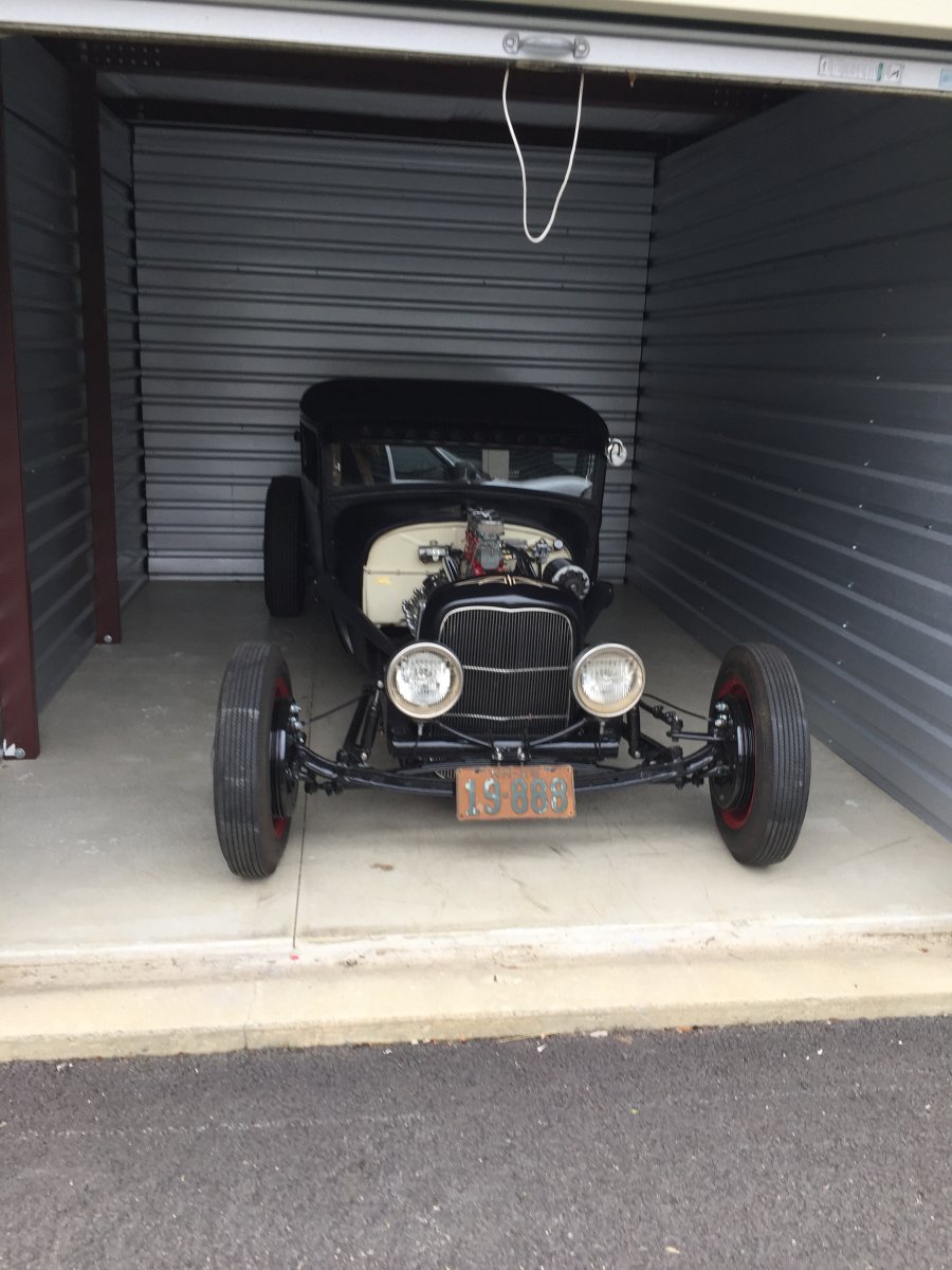

  14. Stephen Barrett
    Joined: Sep 24, 2019
    Posts: 878
    Stephen Barrett
    Put my car in storage today. Glad to see it out of the elements. The storage place lets you work on them there so hopefully I'll have time between now and Monday to get the heads off. Here's a few more pictures of it. IMG_1626.jpg IMG_1619.jpg IMG_1616.jpg IMG_1618.jpg IMG_1622.jpg IMG_1623.jpg IMG_1624.jpg

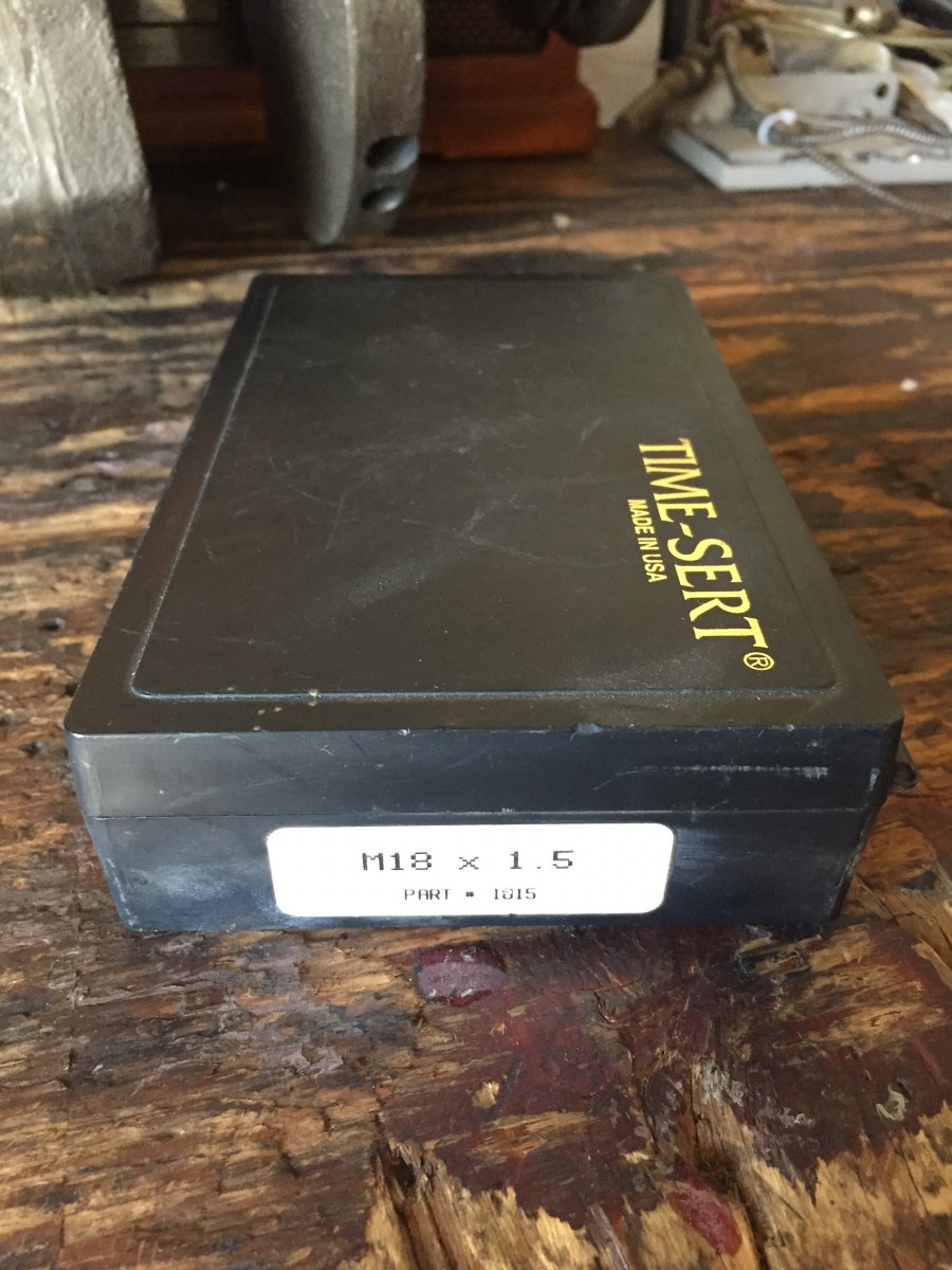

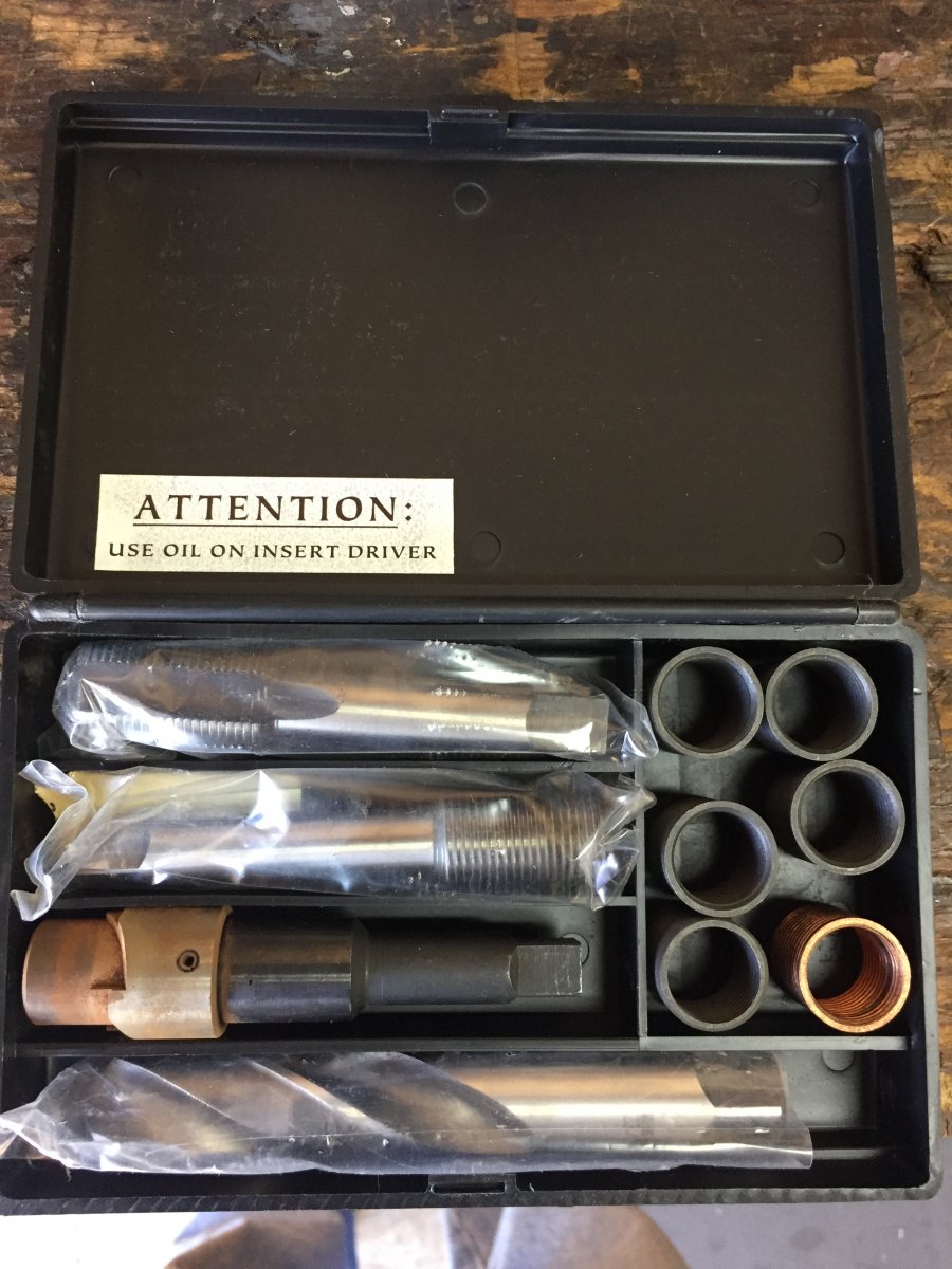

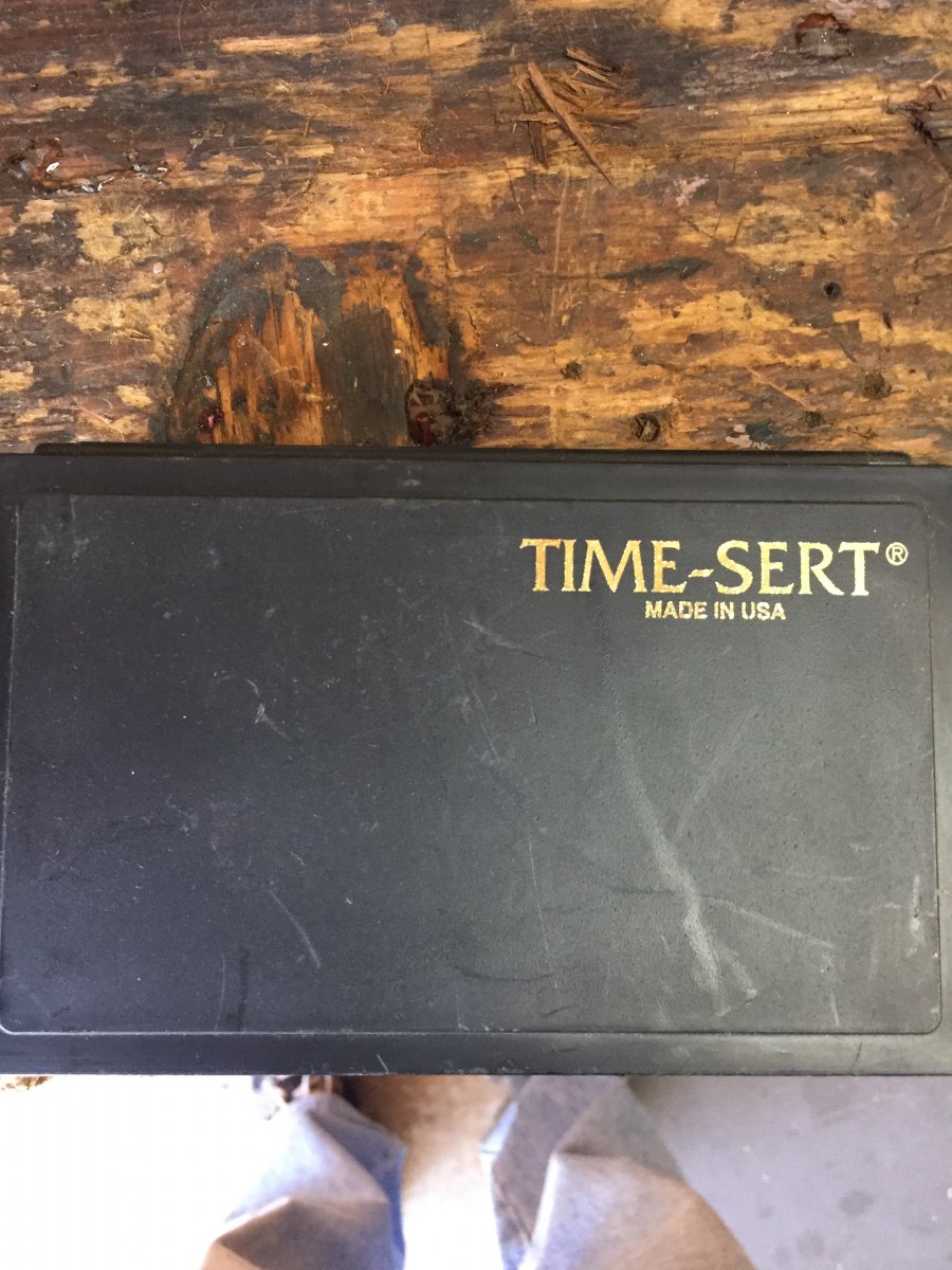

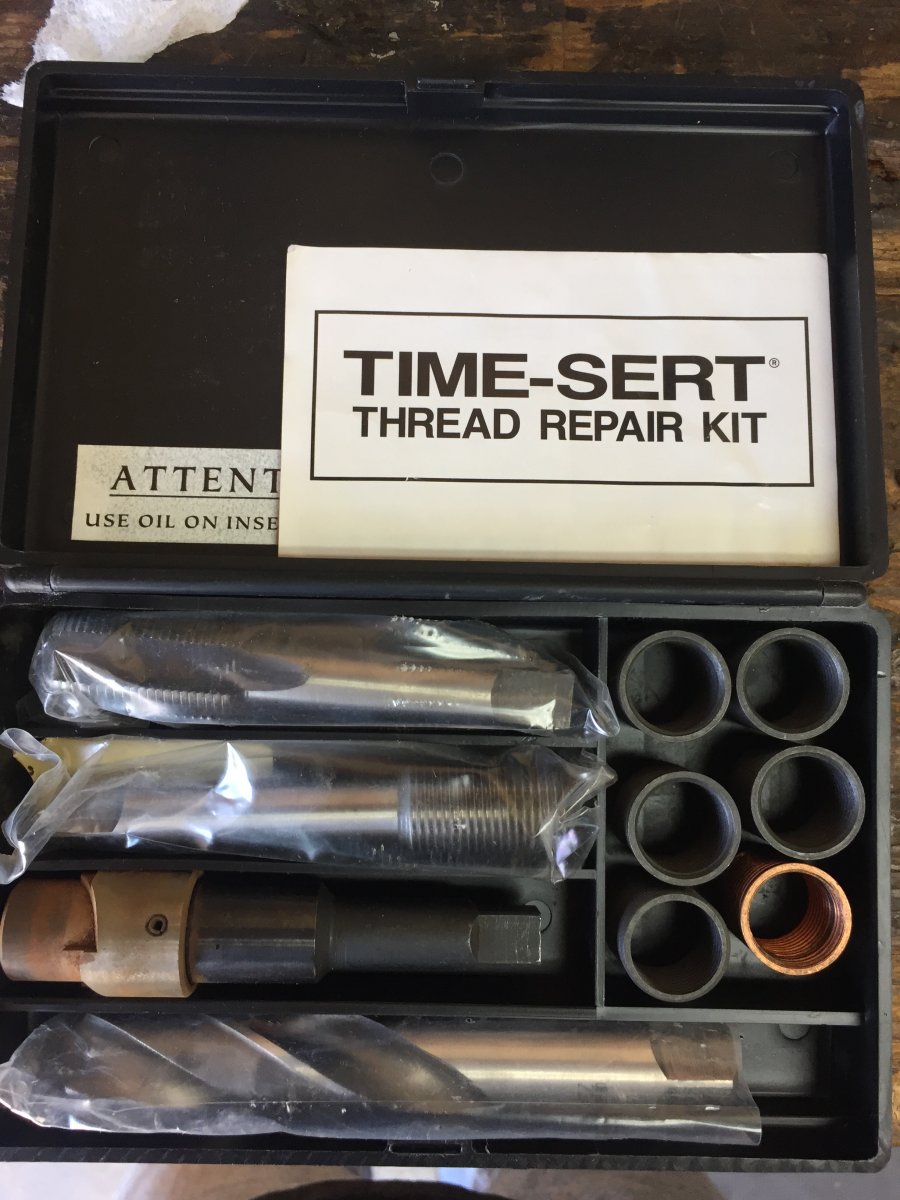

  25. woodiemike
    Joined: Jun 19, 2010
    Posts: 390
    woodiemike
    3E6A79E4-A6D9-4B0C-8781-B828E9A50FDF.jpeg 0C7BEB6E-D40F-4A87-A854-F4D50710BF4D.jpeg 60B3E805-028E-4758-B15F-1345A0F57D20.jpeg 5E0922ED-2291-4AA4-86BE-3D4BA8E4A196.jpeg
    Hello Stephen; as always there has been a lot of excellent tips and advice provided by fellow HAMBERS!! Always amazes me how much knowledge is out there that people are so willing to give! That being said, I personally have only used time-serts and have had good results. Not saying heli coils won’t work, just haven’t used one for that. If time-sert is the way you want to go, and are willing to pay for shipping and replace the Sert, I would gladly send you the kit I have. I’m in no hurry to get it back so you could put it on your “winter” to do list Let me know or PM me. Best of luck what ever you decide. Mike
  26. Stephen Barrett
    Posts: 878
    Stephen Barrett
    WOW! Thank you so much for the offer. I really appreciate it. That is so nice of you. Once I get the heads off I have a machine shop that is going to take care of it for me. Just to be sure the holes get drilled straight. I also think I'm going to use Heli coil even though a few people here are not fans of them. I think for spark plug holes they will be more than enough. Plus after watching the Thread insert death match video on YouTube I have a lot more confidence in them. If anything changes between now and then I will definitely let you know. Check out that video if you have time it is really good and thank you again. I'm really loving it here on the HAMB and all the help everyone has been giving me.:)
    1947knuck likes this.
  27. Mart
    Posts: 5,045
    Mart
    Is that the right kit for your heads? Aren't they 14mm threads? Just saying it's worth checking before sending stuff cross country. Mart.
  28. woodiemike
    Posts: 390
    woodiemike
    Good eye Mart!! And you are absolutely right! 18MM is for a 21 stud. I wasn't even thinking [obviously:eek:] about that. Well the offer still stands for anyone who can use it! And on a side note, this got me to thinking; maybe we should have a thread/forum where guy's and gal's could go to and see if anyone has a specific tool they could borrow for that one time job? Just as in Stephens situation, that one thing is sometimes cost prohibitive. And as we all know doing everything that you can keeps the cost of the project down. Just a thought!!;) Be safe everybody!!!
