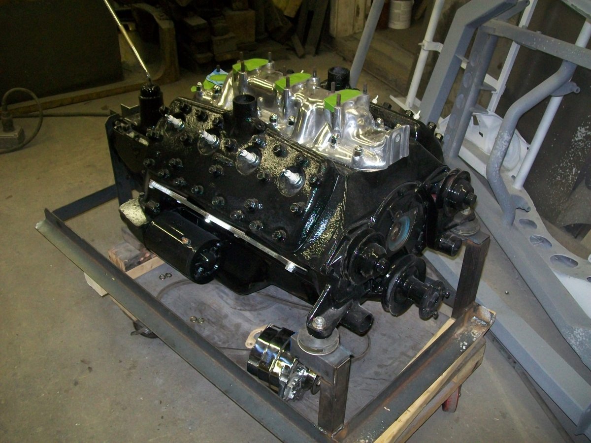

    He's going to pull the heads and the pan to show what he stated about it is true. Claims it super clean with no cracks, no Heli coils, can see the cross hatching on the cylinder walls and can see it had a valve job. He seems to care about his reputation here on the HAMB. I already looked at a couple others that I p***ed up on after closer inspection. So I'm hoping I like what I see but I will be being careful. I saw it here in the parts for sale section and when I told him who I was he said he saw my story on here. He then ***ured me I would not be disappointed and after talking to him for a while he seems genuine. We will see but I have a pretty good feeling about it. Thanks and I understand your concerns about the paint. If it seems to good to be true it probably is. Hopefully that's not the case.

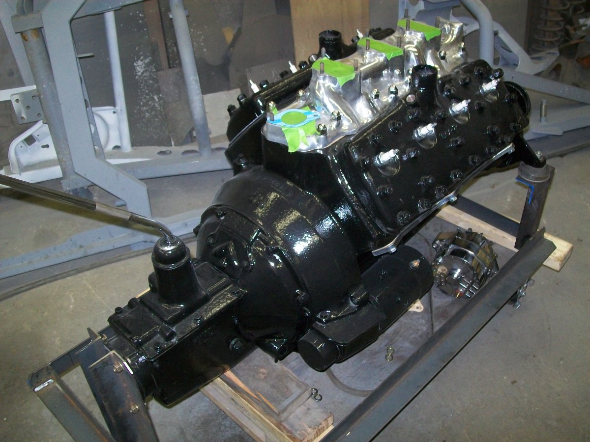

    004.JPG Just to dispel the usual HAMB negativity, (LOL), I'm posting a few pics of the motor as I was putting it together. I pulled the pan and the like because I too no longer believe anything anybody says. As can be seen the motor was spotless inside and out and I did not wash or clean it, (other than usual paint prep), and checked everything out for cracks and damage before new gaskets and seals. The motor was exactly like the fellow I bought it from described and I have no reason to believe he misrepresented anything. The only reason I painted it was I was going to set it in my T roadster, that I just sold this week. The last pic is of the roadster. 003.JPG and obviously I wanted it to look decent.
    I was running the stock heads on this one because some ***hole, (who is on here!), ****ed me on a pair of heads that I paid for and turned out to be s**** when they arrived, obviously frozen and cracked like a fried marble. I returned the heads to him and he just kept the cash. Sadly, I'm starting to believe the old days of the HAMB when we trusted each other are gone.
    Some pics of the motor that show condition prior to ***embly and prior to paint. I've got a load of people mad at me who wanted this motor. I sold it right around half of what I have in it and I appreciate the sale and I feel it is going to a good guy. This is quite possibly the nicest one I've had in here in years. I've already done this deal and I'll hold up my end. The rest of the flattys and parts I have been putting up for sale are going to the s**** rather than have the hard feelings from a sale that isn't what somebody felt was fair. 377.JPG 004.JPG

    The pics above didn't come out in the right order! The motor was not washed or cleaned in any way prior to taking those pics. You can see in the last pic if you click on it the rods and the like have just been done. They still have the builders paint marks on from the balance work. The motor was claimed to have 1500 mi. on it and I have no reason to believe it not to be true.
