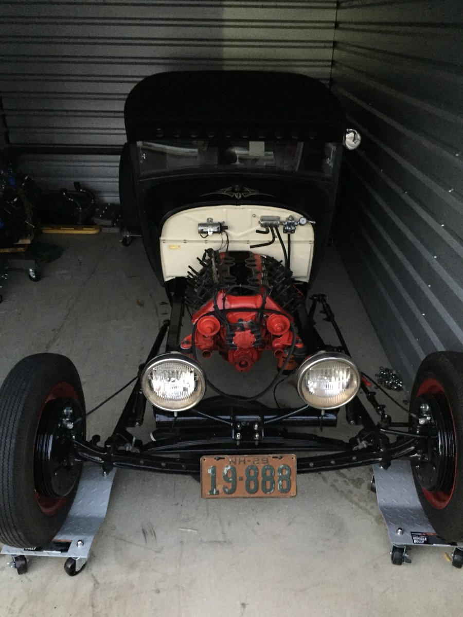

    So I only had a little time today to work on my engine pull but I took of the intake and started getting the transmission ready to take out. The next time I work on it I should have it out of the car. Here is a couple shots for anyone interested. I'm also wondering what you guys think about rebuilding the old engine. Should I bother with repairing the old block or just get another one. It seems like someone put some work into this one or maybe I should just strip it for parts. I guess it has a Mercury crank, Isky 3/4 race cam, small block Chevy valves and a few other goodies. Let me know what you think. I put another picture at the end of the stud hole just so you can tell me if it's worth fixing. IMG_1726.jpg IMG_1724.jpg IMG_1725.jpg IMG_1634.jpg

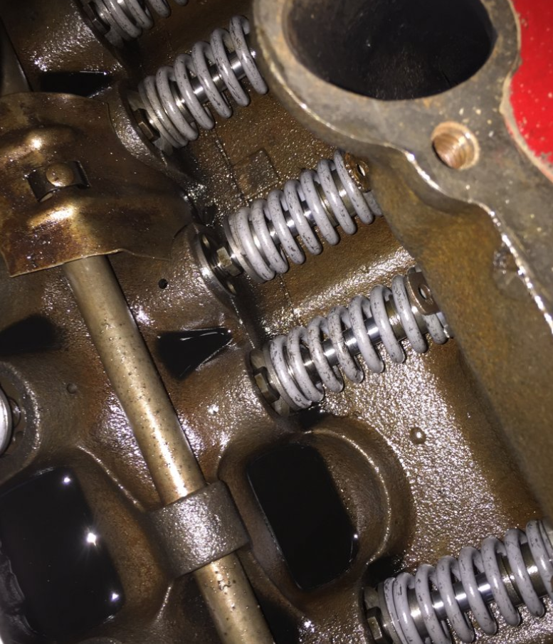

  21. ekimneirbo
    Joined: Apr 29, 2017
    Posts: 4,218
    ekimneirbo
    If the broken stud seems like its going to be difficult to remove, I would suggest contacting some local machine shops and asking if they have a "disintegrator". They can remove the stud with minimal or no damage. Guessing $50/$100. When broken studs are difficult, you sometimes cause more damage with off center drilling and elongating the threaded hole. The machine shop may have the needed helicoil/twinsert and installation tool.
    These tools have been around for at least 50 years and many old shops have them.
    1947knuck likes this.

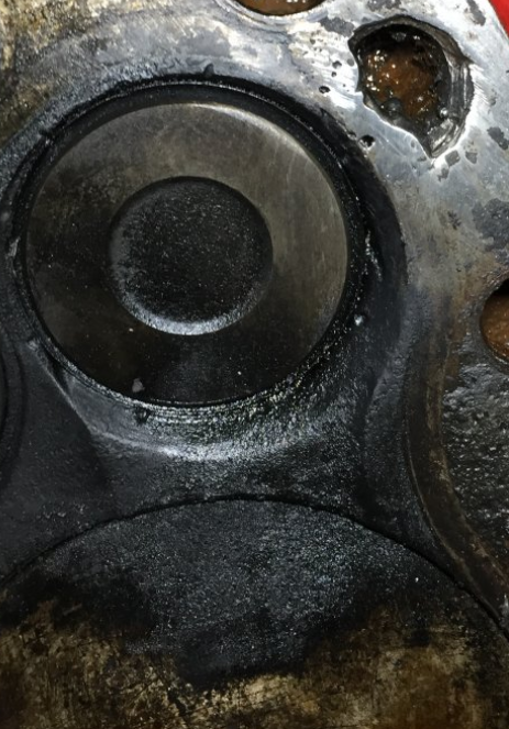

  22. There are quite a few mods done to that block.
    Block is drilled for Johnson adjustable lifters and the lifter are present. upload_2019-11-26_14-47-25.png
    mild relief cut
    I think I would try to repair the block or at least transfer the goodies over.
    did you try to measure the overall valve lift?

  25. Pardon my Flathead inexperience, what is the rod running down the middle of the lifter gallery? I would strip that block and take it to my machinist and see what he could do with it. My guy is a magician when it comes to stuff like this.

    Don't feel bad about inexperience I don't know what it is either. I want to say it brings oil to the timing gears but I could be wrong. I do plan on tearing into it and then bringing it to a machinist to do the repair. My main goal is getting the new motor in it for right now. I've learned so much from this experience. Even though it's a drag I had to pull the motor from a car I just got. I have to admit it's been a lot of fun. That's what it's all about. Right? It also has been a pleasure being here on the HAMB. I can't thank everyone here enough for all the help.

    It's the main oil feed gallery.
    The oil gets fed to that pipe and feeds the centre and front cam bearings and then goes past the cam to the mains.
  28. Your block has what is a called a "Half relief". This was done to un-shroud the intake valve without sacrificing too much compression.
